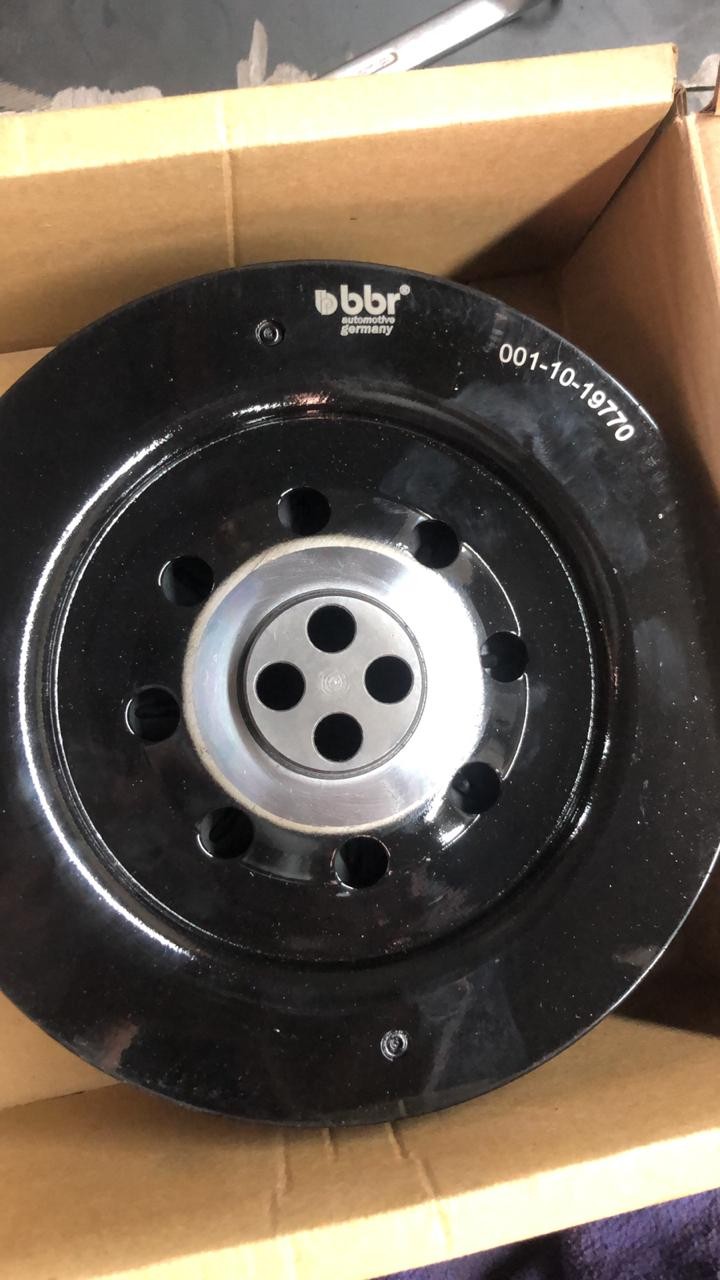

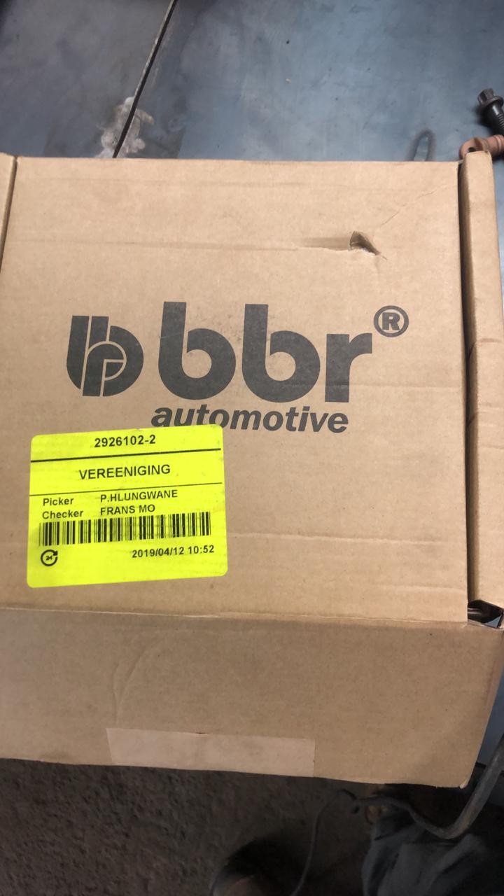

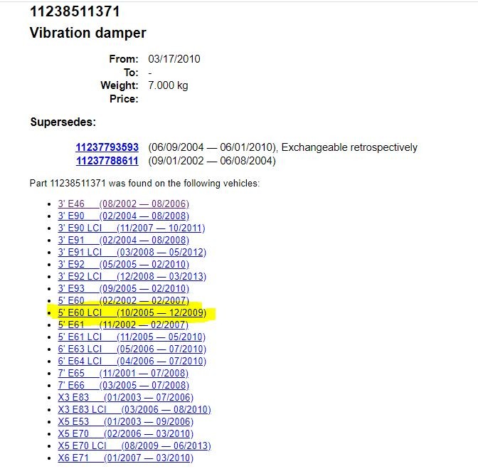

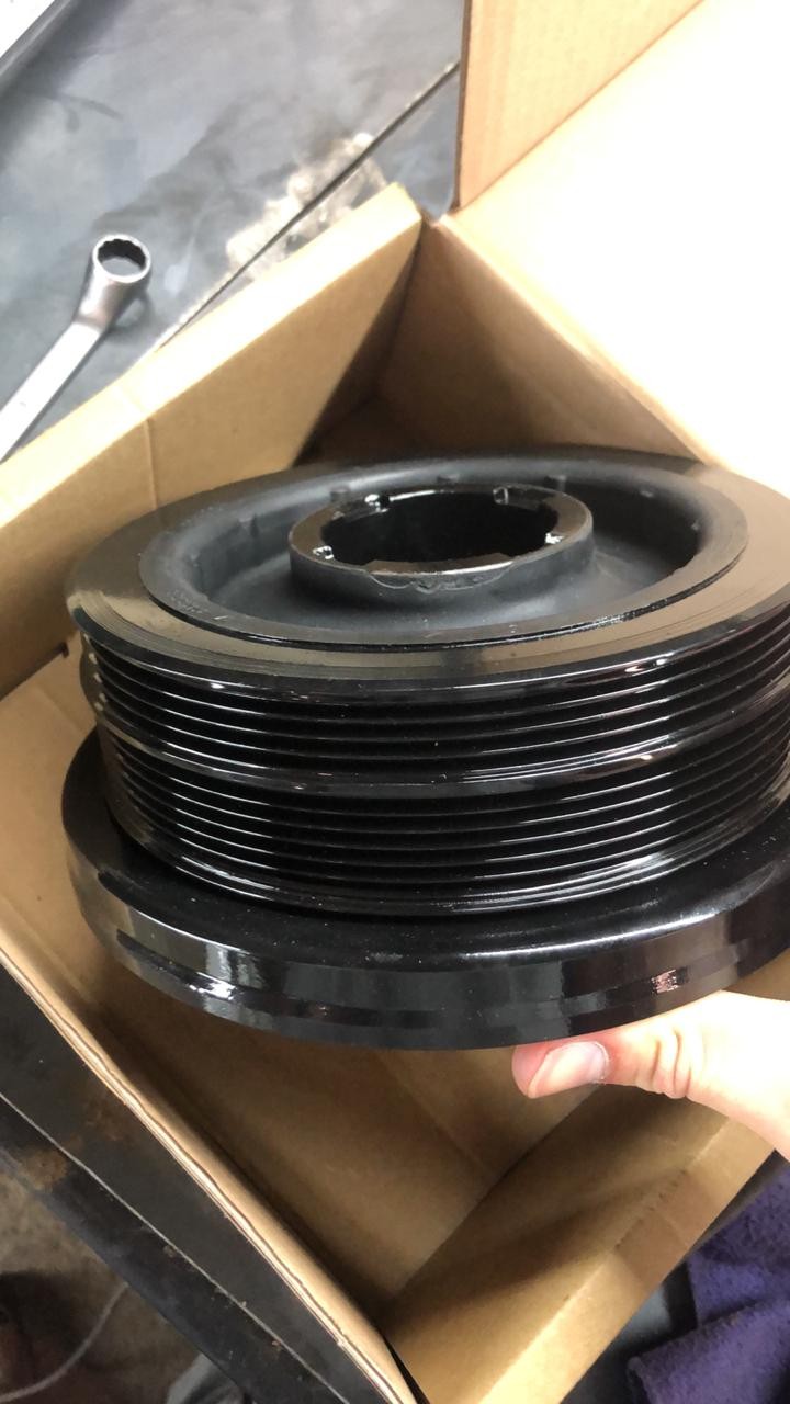

Goldwagen stock BBR parts for the damper last I checked. Anyone have any experience with them?
[Image: 1_5871680088.jpeg]
[Image: 2_6917756656.jpeg]
[Image: 3_4512769496.jpeg]
