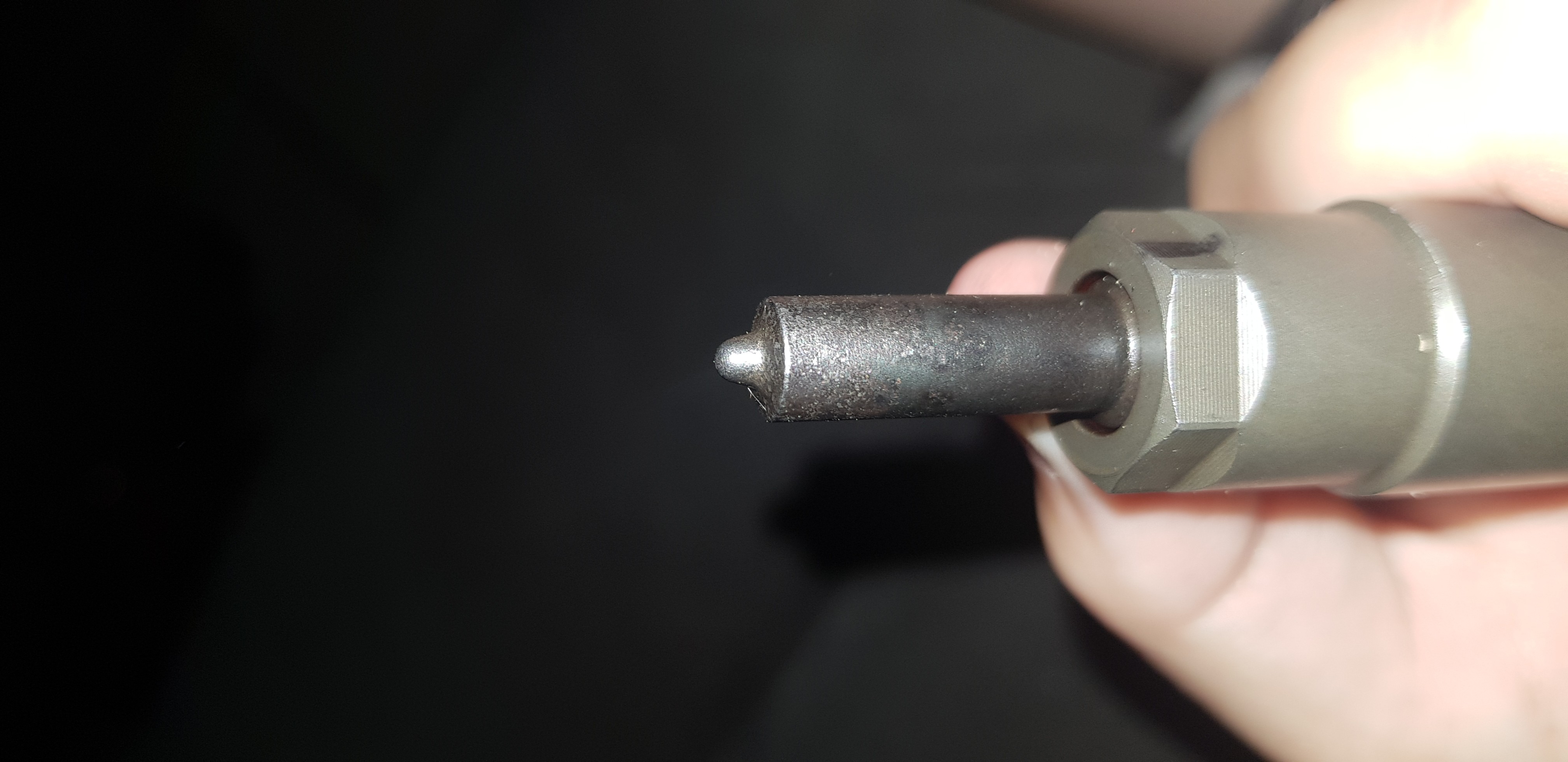

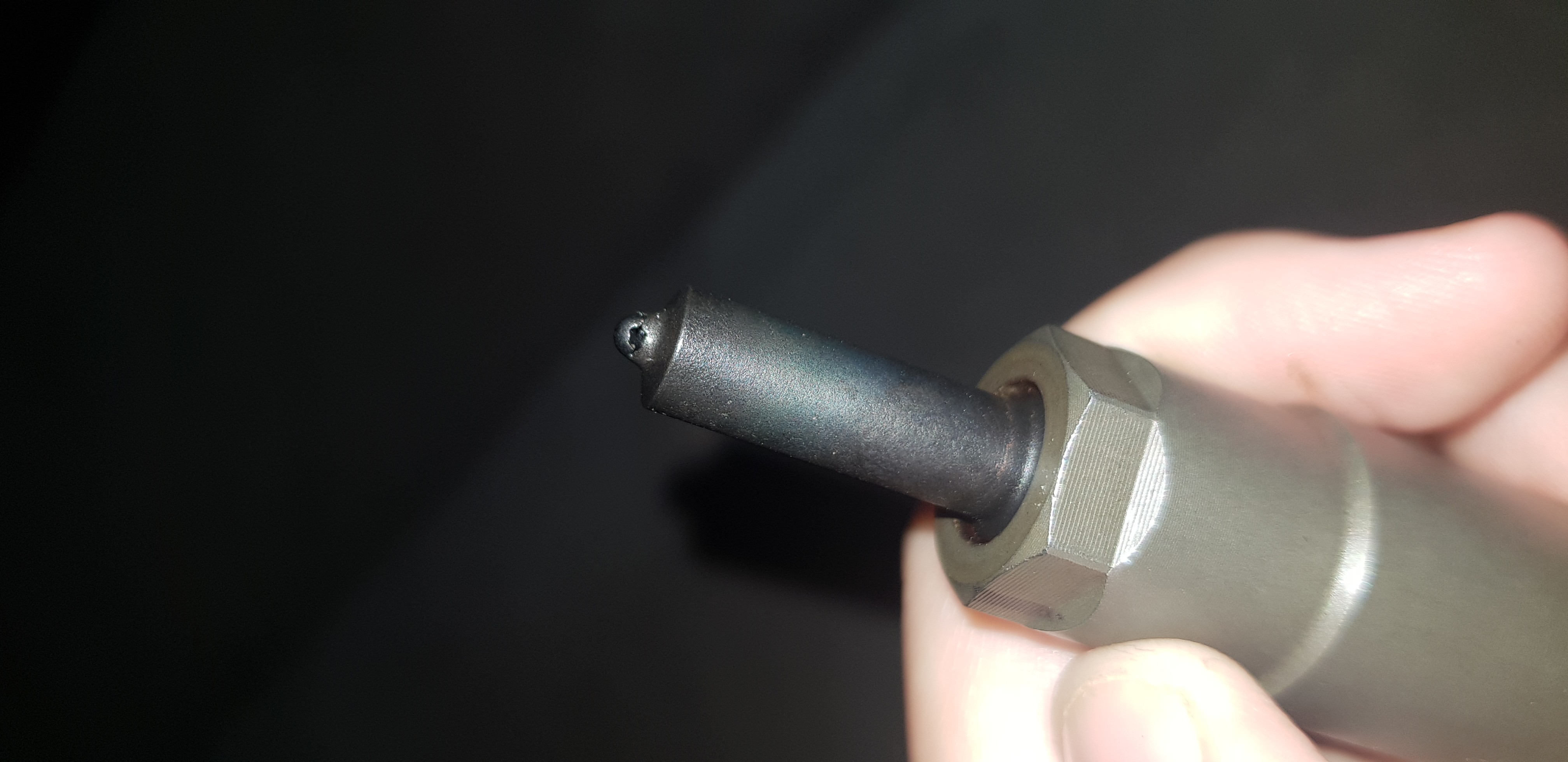

Today, 02:26 PM
Post: #12
RE: BMW not starting for months now - don't know what to do
Ok, so we have the problem - the injectors are ruined... Where will I be able to find the cheapest place to get replacements? It will have to be as cheap as possible as I am broke by now BlueCry

Today, 02:34 PM
Post: #13
oh dearBlueCry
I feel for you. Injectors don't come cheap. If you can find second hand from somewhere reliable then you'd be saved
But is your engine problem just an injector issue or are they part of a bigger problem that's causing the car not to start.
Why not check out a rebuilt or reconditioned engine from engineers who do them and see what that could cost compared to the likely overall costs of fixing a problem that's not yet been fully diagnosed.

Today, 02:42 PM (This post was last modified: Today 02:44 PM by Danny@DSCmotorsport.)
Post: #14
new injectors arent cheap... how many do you need?
have you tried to have your injectors repaired/serviced?
Find all posts by this user

Today, 02:55 PM
Post: #15
I cant see how all the injectors went bad at once. Take them to a place and have them cleaned and let them pressure check after the clean which one is bad.

Today, 03:06 PM
Post: #16
4 of the 6 went
