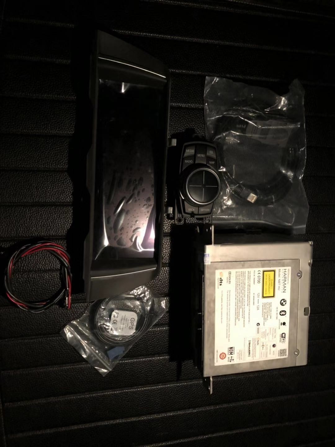

Hardware:
NBT screen
NBT HU
APIX cable for NBT HU and screen
GPS antenna and cable

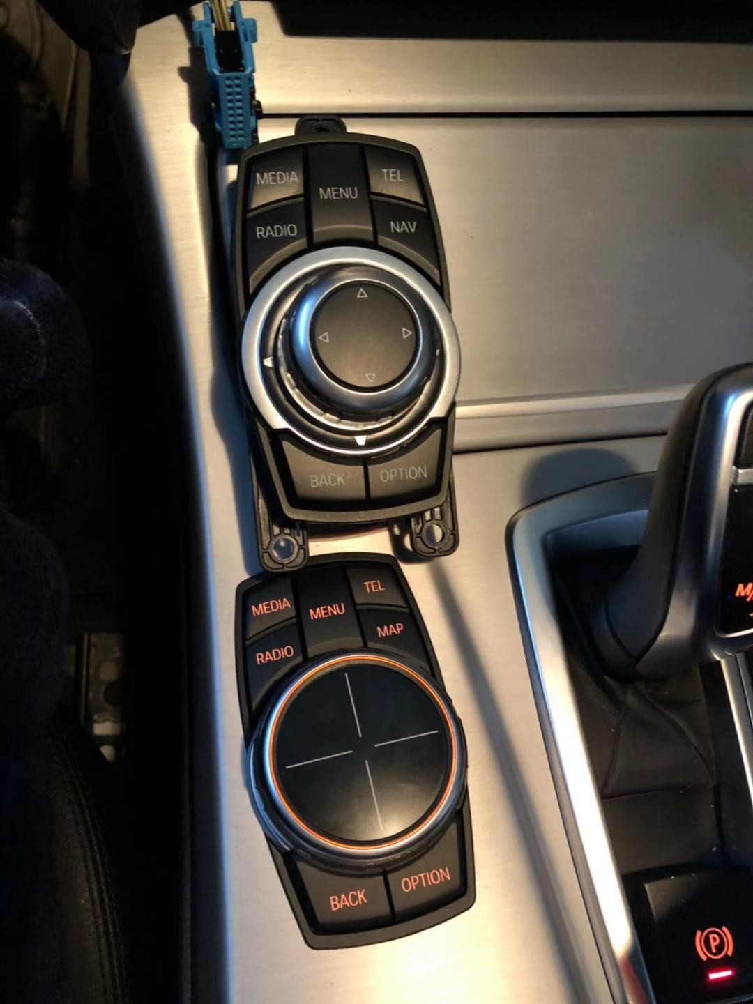

iDrive Controller. I don't get bothered by hand writing function. If like, then additional module needs to be in place along with iDrive controller.
if you have Combox in the boot, extras:
USB cable, BT antenna cable, microphone cable, Aux cable.

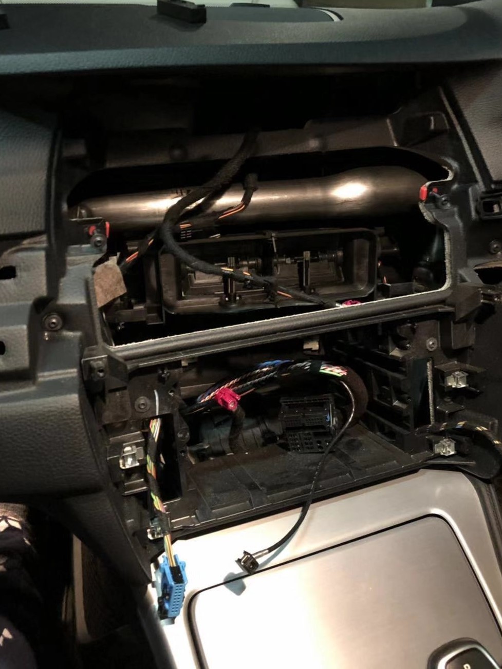

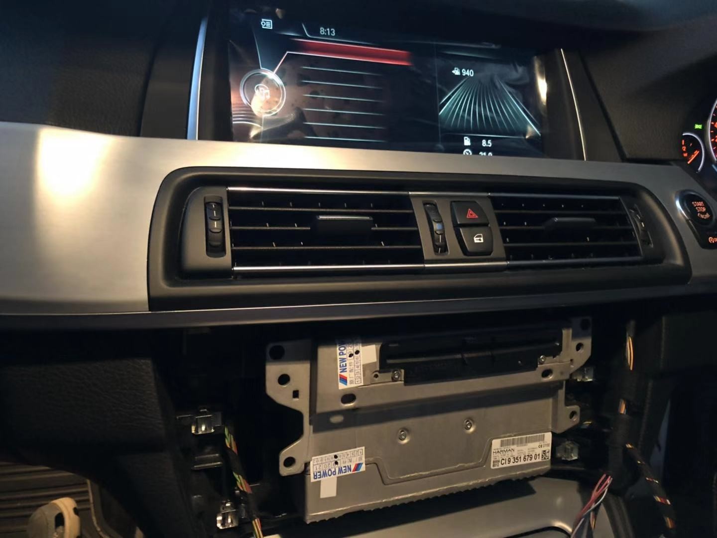

1. Take out original screen, HU. Then put new one in. Replace old APIX cable between HU and screen. (30 min)
2. Open trim around gear lever. There's one screw holding. Replace new iDrvie controller. If you have Combox, it's a good time to reach USB port. Pop it out from under and take out the existing USB cable and Aux cable. Put new cable in as the old one route to Combox in boot. If you want to reuse the old cable, it's huge work to take out trim. (I did it and for nothing.) Route the USB and Aux cable through gear lever area towards HU. (30 min)

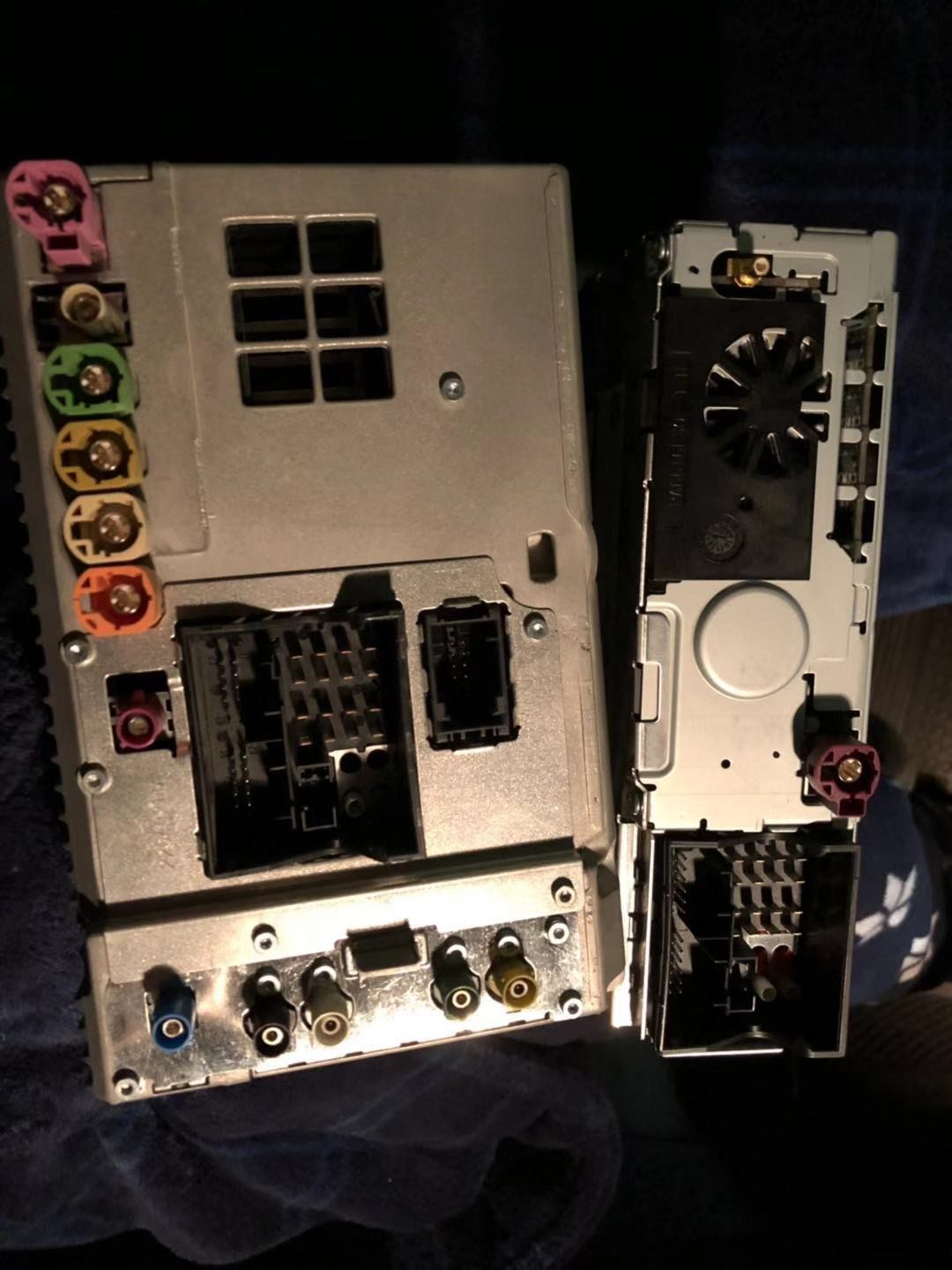

6. Put new BT antenna cable, USB cable, FM cable, main quadlock cable, APIX cable, GPS antenna cable into NBT HU. I route my GPS antenna to the central speaker area. It has great signal. Reassemble everything.

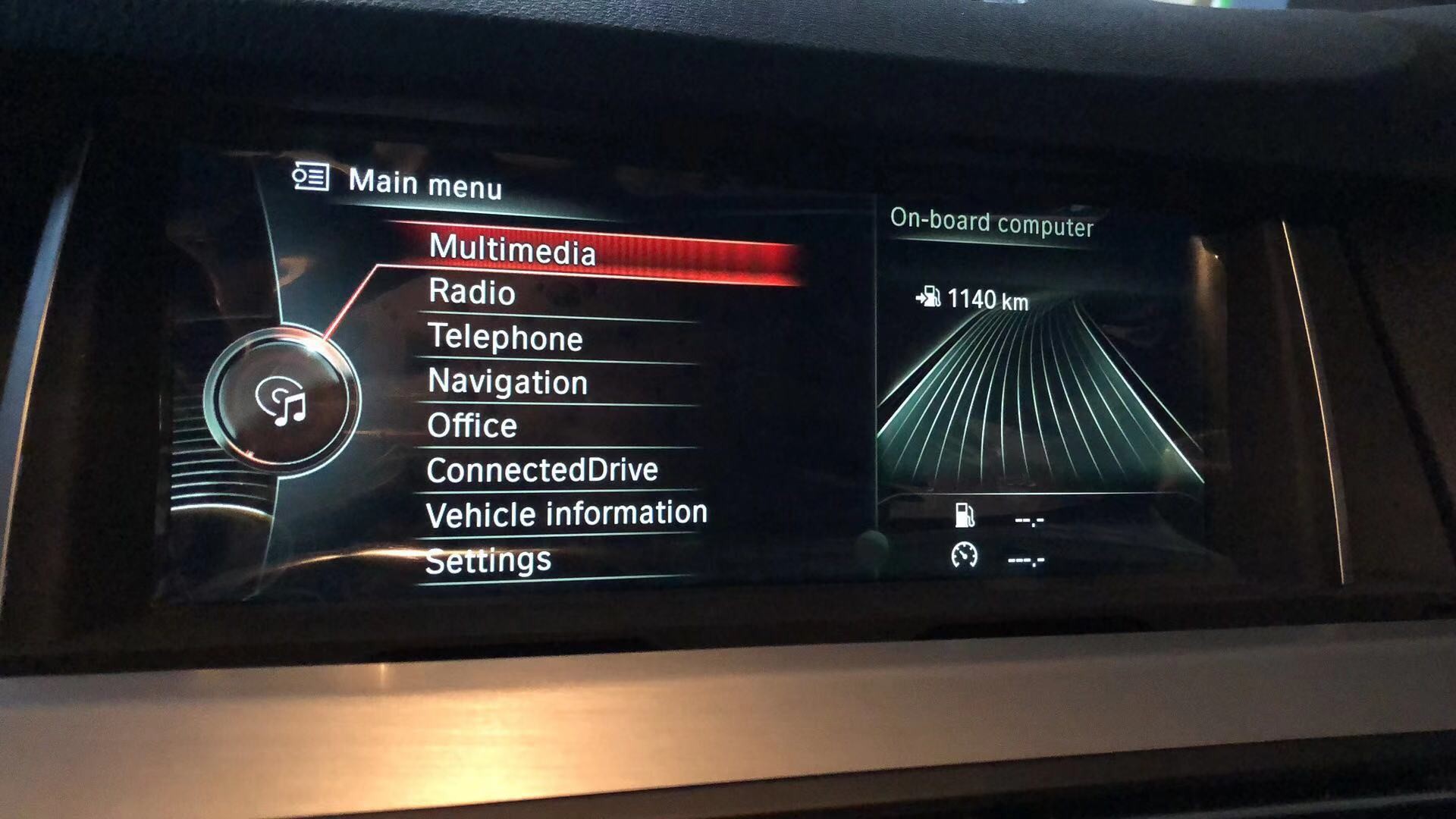

8. Obtain FSC code and Map data. Put into a 8GB FAT32 USB memory stick. Load it into NBT.
Then everything is done. You can enjoy the new system.

If anyone looking for NBT retrofit, I'm glad to help.
BMW moves towards NBT Evo in the past years, NBT Evo retrofit will get more and more popular. I must say BMW iDrive is the best OEM system I've used in past years.
A few photos:
