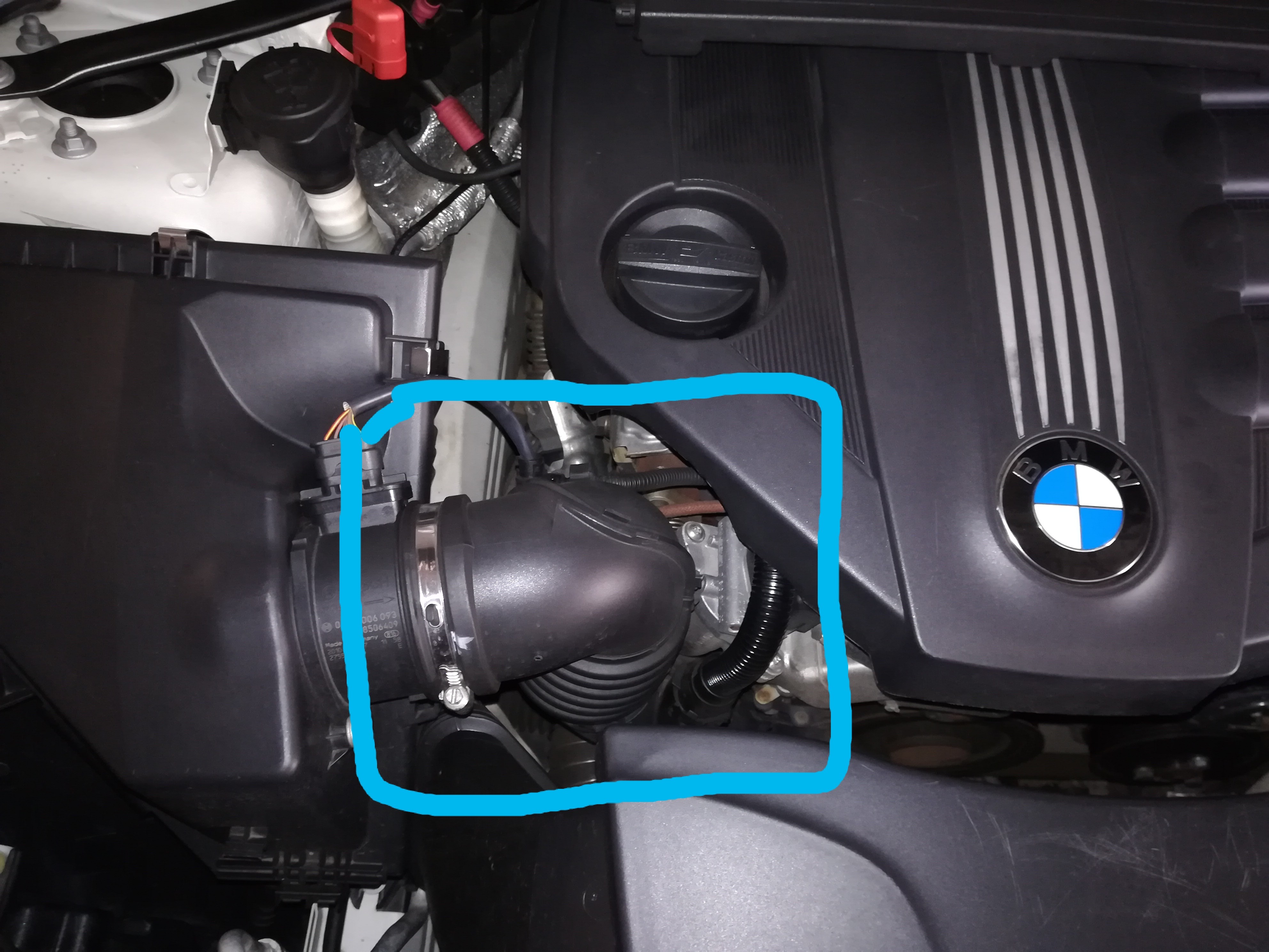

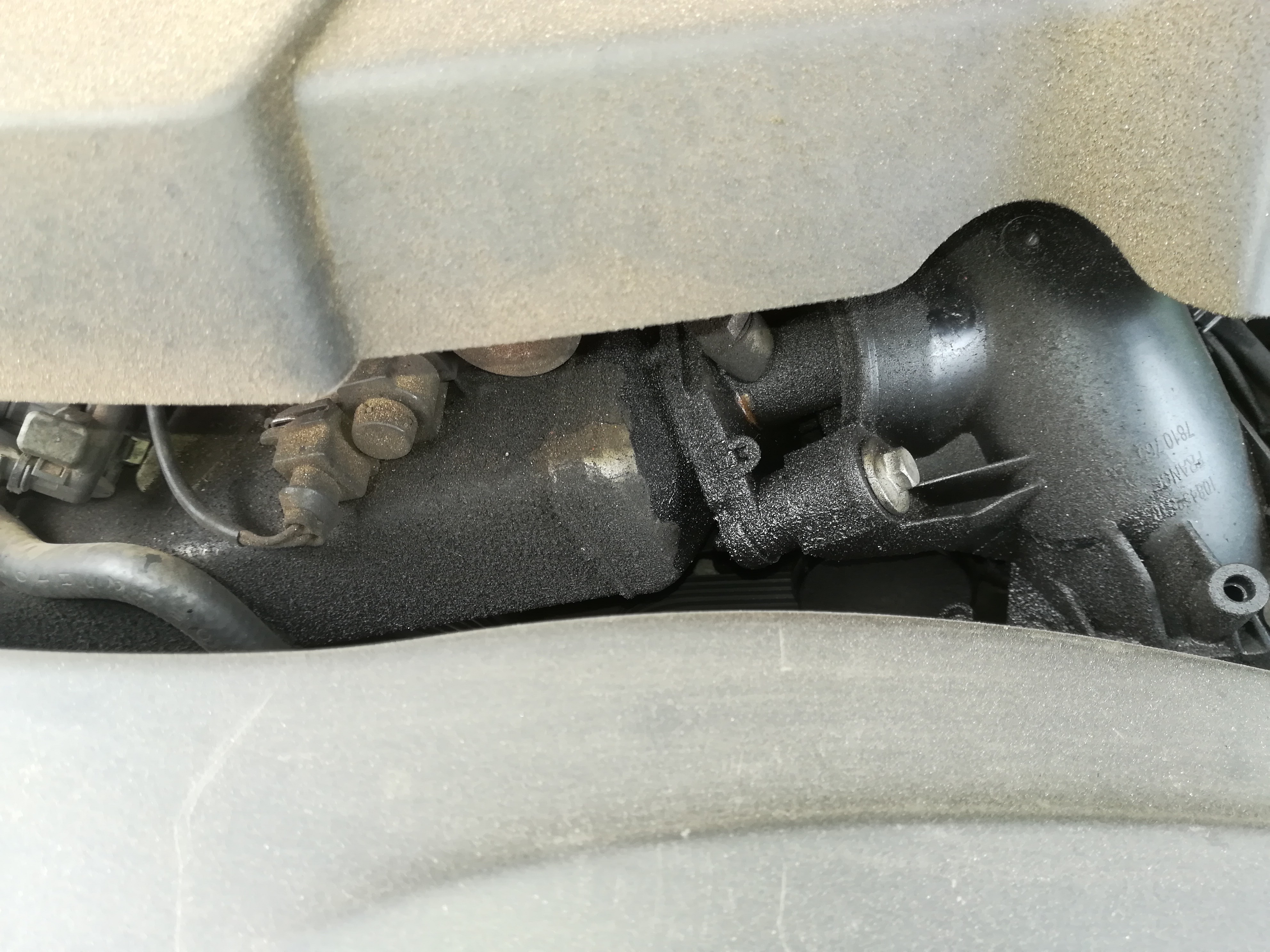

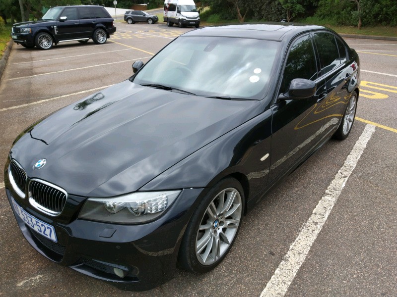

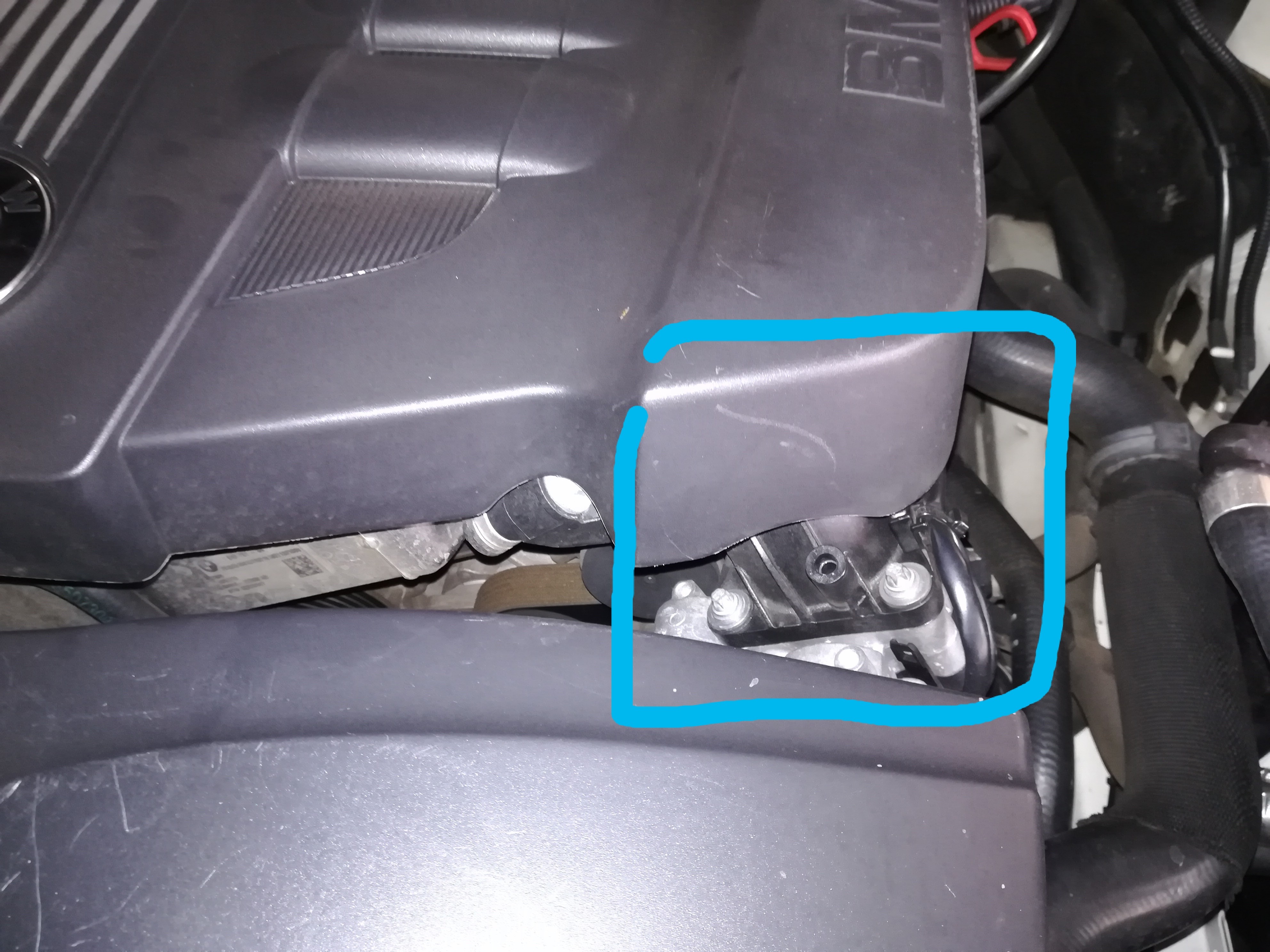

Hi guys. I've found a 2011 320d e90 m sport auto with 100 000km. Private sale. Owner bought it from a friend at 85 000km two years ago. He did mostly short trips. Overall condition is good apart from a few light scratches and the front bumper not fitted properly. No evidence of accident damage. Drives well. Tracks well and no noises from the suspension. Gear changes smooth. Took it from 50 km to 120km using kickdown and power delivery was good not as good as a 320d with software though. Got stuck in traffic for a few minutes and no issues there either. Error codes on dashboard indicate a burnt out bulb and low windscreen washer fluid. I opened the bonnet to check the damper pulley and it looked fine with no cracks but I was greated with a lot of oil or soot on the front section of the engine. From my research on the forum and off it points to the egr cooler seal or the egr cooler itself that's the problem. Please forgive me as my mechanical knowledge is not so good. My mechanic will only be able to look at it on Saturday. Please advise. Is it serious. Should I call it off now. Thanks. Some pics I managed to get.
[Image: img_20190211_141047_6145090404.jpg][Image: img_20190211_141105_3999816710.jpg]
If I do go through with the sale can someone please advise on the safest way to do the purchase ( cash deal not finance) and the process to get the vehicle registered on my name. I've only purchased one vehicle privately that was 15 years ago. My late dad handled everything and registered it on his name. Thank you.

nice car- these are great diesel engines- will go foreverThumbs
If it doesn't leak oil it's not a bmw, goes one saying haha!
I've lived with leaks for years and repair them and another develops somewhere. So panic not, your mechanic will sort it out.

By the looks of it, it could possibly be the EGR seal leaking exhaust gases which is causing the soot buildup and also maybe the EGR Thermostat which is leaking and causing it to look a little oily, but hard to diagnose without actually pulling the engine cover off and physically checking. If it is the Thermostat then its a cheap fix at least.
I'd say have the mechanic just double check it and if its nothing major then grab it as long as its the right price Thumbs hard to find 320d's with low mileage these days and the ones that you do find people are generally asking an arm and leg for them.

Slightly concerned about the oil buildup, normally the soot buildup would point to a leaking egr or cracked intake manifold. Normally a little oil is present in all diesles intake system but this looks like quite a bit of blow by from the turbo. I wouldn't be surprised if turbo replacement is on the cards soon.on the optimistic is it could be the tapper cover gasket that's leaking which isn't to much of an expense or the oil filter housing gasket. Pretty hard to tell with the engine cover on

Thanks Nikhil. Hope it's not the turbo. I'll get more info on Saturday and update.

Update

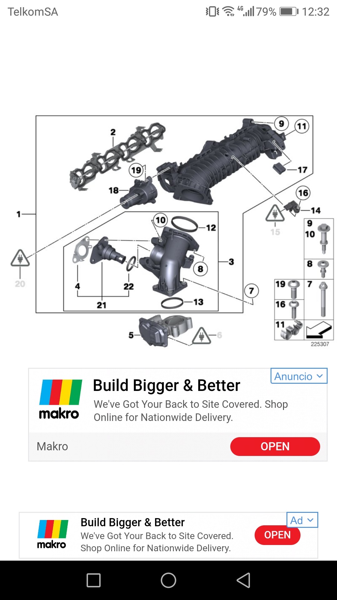

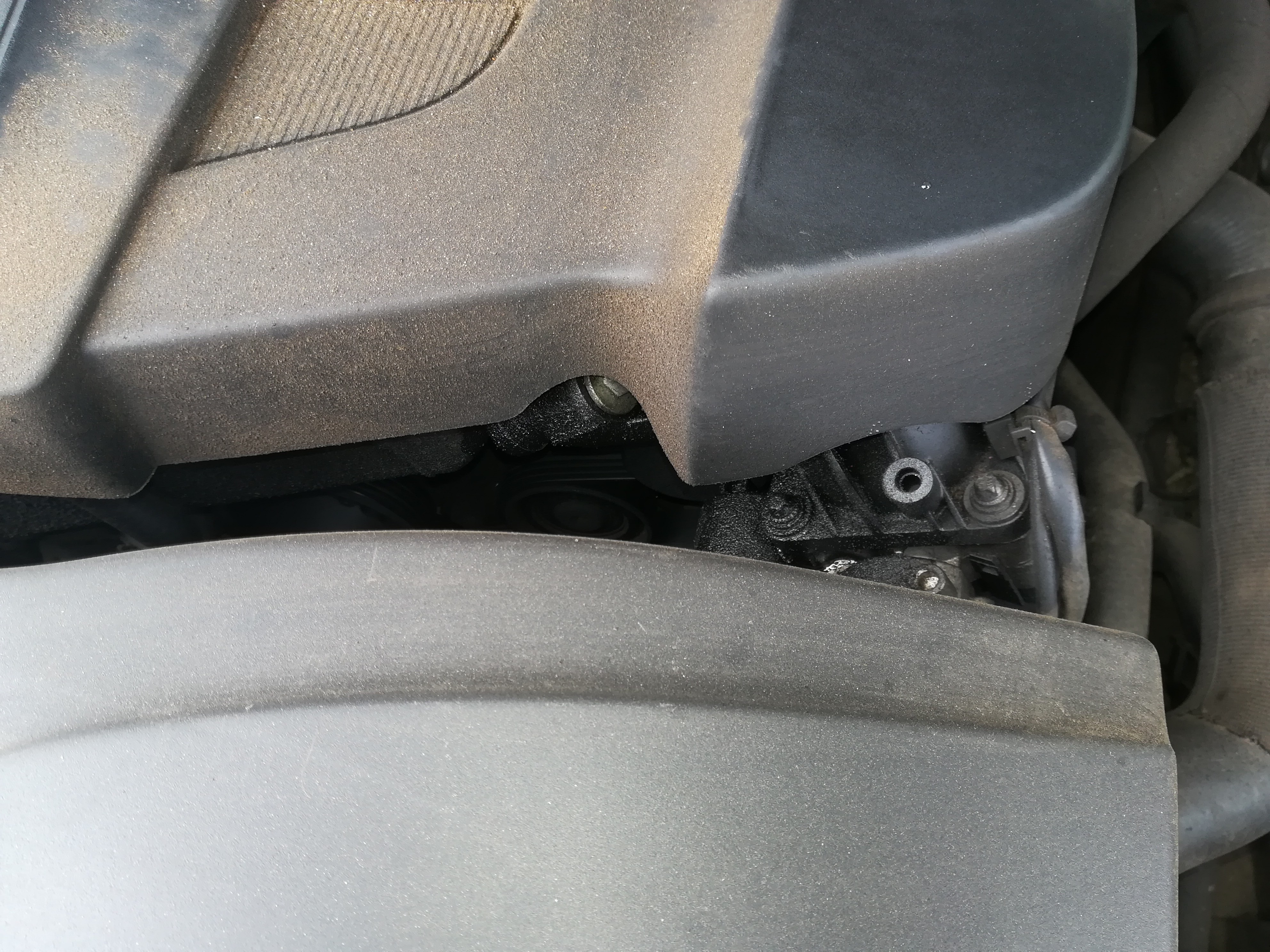

Car has oil leaks from oil filter housing gasket and two other parts (pics attached) need to be replaced. Parts cost around R 5000 from BMW. Front shocks leaking and stabilizer links need to be replaced. Car has 3 comments. My mechanic assured no structural damage. Looks like boot lid, front fenders and bumper. Turbo was replaced under plan at 72 000km. Seller dropped his price but I need to confirm by this evening. Any advice would be appreciated.
[Image: img_20190216_122742_9784605354.jpg][Image: img_20190216_122816_754868551.jpg]
[Image: screenshot_20190216-123207_8419365142.jpg]

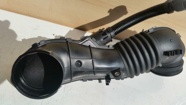

Couldn't find it a pic of the pipe.
Thanks
This is the pipe
