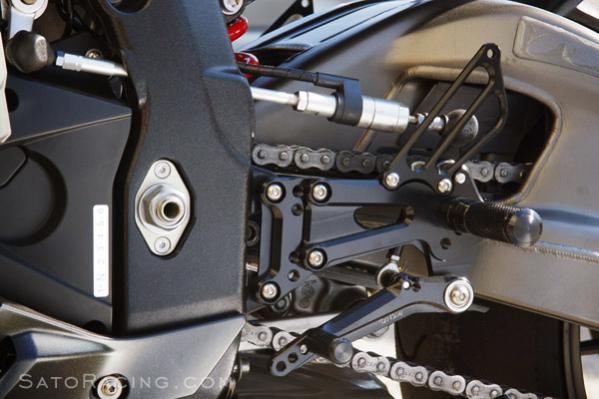

Ok, the bike in the pic is fitted with aftermarket rearsets but you can see how the linkage is set up in the pre-'15 S1000RR. From the top of the rearset the linkage actually passes through a gap in the frame and then connects to the selector.
[Image: s1000rr_rs_abs_lfit1_7087466772.jpg]
This pic is the kind of solution which I think will work best, but it's US$200 excl shipping and duties. This is almost identical to what BMW did on the '15+ S1000RR models. Shift pattern can be changed in less than 10 mins.
[Image: s1000rr12_directshiftpedal_with_satorear...869827.jpg]

Ok I see what you mean, I am sure there is something that can be done to achieve the GP shift with a little fabrication.
Can you not simply weld a boss to the frame and fit the 15+ shifter procured through a scrap yard?

Just fabricobble your own contraption similiar to the shifter in the last pic won't be hard if you have the right tools, hell we made sh!t like that for our bikes with nothing but scrap steel and a grinder and a drill back in highschool
