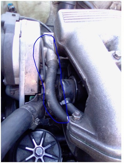

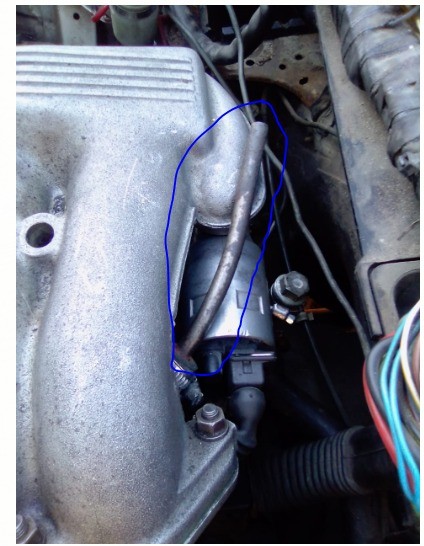

Hi Bmw Family,
Hope you all still good. i have added another member to the bmw family.
It was running smooth but now it does not want to start.
theres a pipe that is hanging loose and i have no idea where it should go.
Please assist if you can. Please see below pics that i have marked
[Image: 3c09c54f-c3ea-448b-9c94-7ee71858ed91_8500029328.jpg][Image: bmw2_7980331857.jpg][Image: bmw3_7340668183.jpg][Image: bmw1_7025011694.jpg]

I think the second one is just a breather pipe iirc.
Edit: On second thoughts I think I may be wrong. I'll have a look at mine and see

Breather pipe yes. Does the car sound like it needs juice or lacking power to start?
Check fuel and battery first then spark wires, then we’ll take it from there

Thanks for the replies.
Does the car sound like it needs juice or lacking power to start? Yes it does sound like it.
at first when i started the car the revs just went up and i had to switch of the car. now it just tries to start without taking. fuel is good and the plugs also look good. will replace them and see if theres a difference.
Just to be clear, the loose pipe does not go in anywhere ?

Hi, the breather pipe goes nowhere. If it’s the spark plugs the car will still start but misfire, check the spark wires and coil then timing...airflow meter.
Another common issue is the timing sensor, crank sensor
