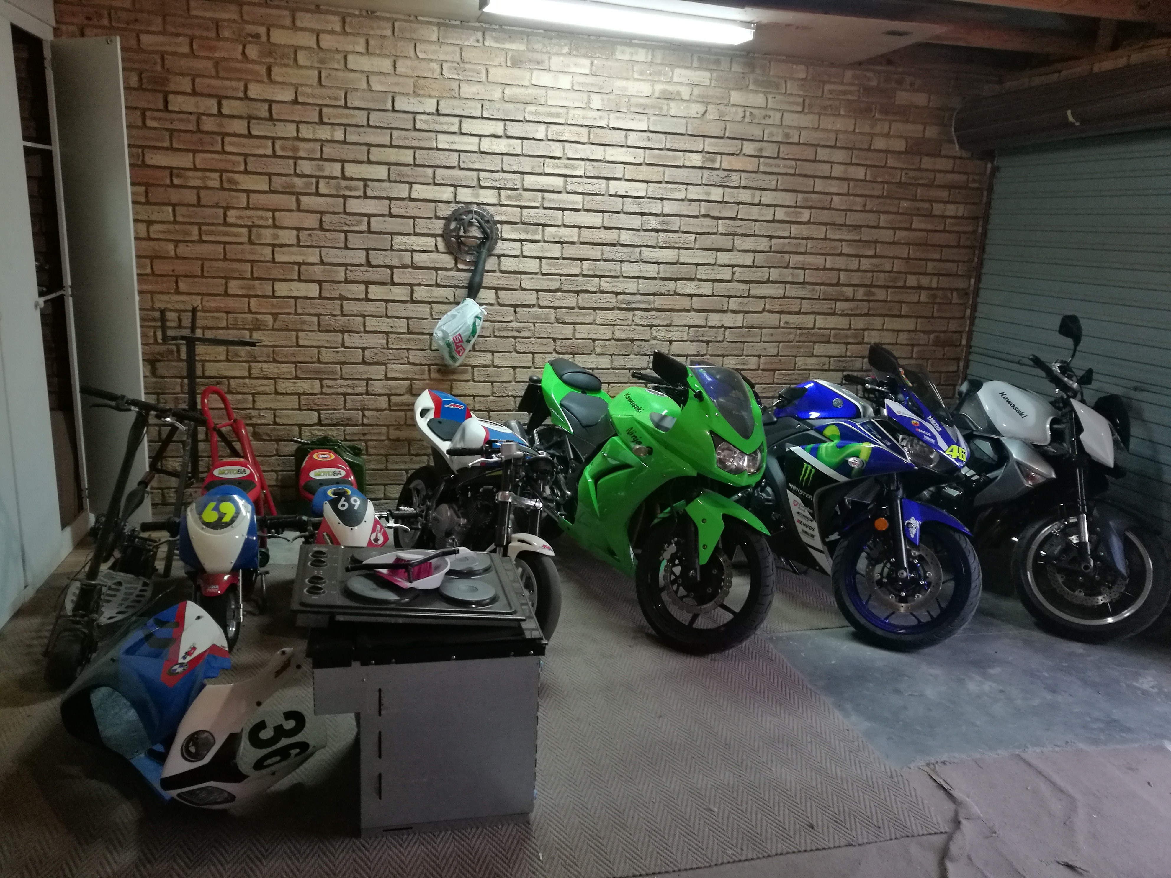

[Image: img_20161008_172625_5615118625.jpg]
this is why i have too many odd oils

Nice stove.
