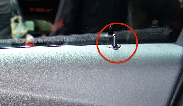

Hi Guys, I need help, 3 of my doors lock pins rattles, it's the plastic pin that rattles against the plastic hole it sits in. There is just enough movement that certain bumps will cause the pin to knock into the surrounding material. Only one of the rear doors doesn't have the same problem as that pin sits under some kind of tension. The driver door is worse, it actually drives me nuts and makes want to sell my car
Does anyone have this problem and quick cheap fix.

The fix is to replace the plastic part around the door pin, part number 51417316859 for the front doors and 51427316860 for the rear doors. there are three pins or small legs inside those things that keeps the door lock pin under tension. The part is R309 at the dealership and you can DYI, don't be afraid of taking the old one from the door panel, you have to force it out with two, small flat screw drivers. Don't worry about breaking them because they are already broken, hence the rattles
But R309 for such a small plastic stuff,:dunnoanymore:, is a bit too much, so for the rear door once, I used Velcro and stuck it with super glue inside, on the walls of those plastic parts where the legs broke off. If you are going to re-use the old part, you have to be gentle when removing it, to avoid damaging it. The rattles are now gone and my car feels like a real car now :smilebounce:
