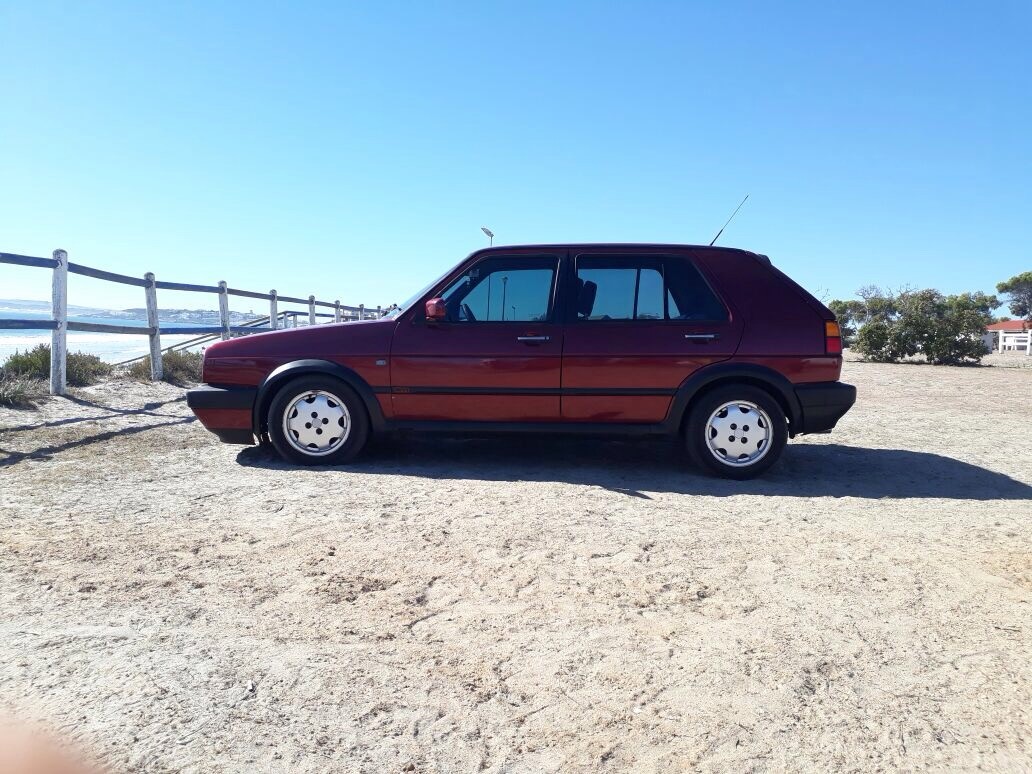

So my dad recently bought me my first car.
It's a 1992 Golf MK2 GTi 16v.

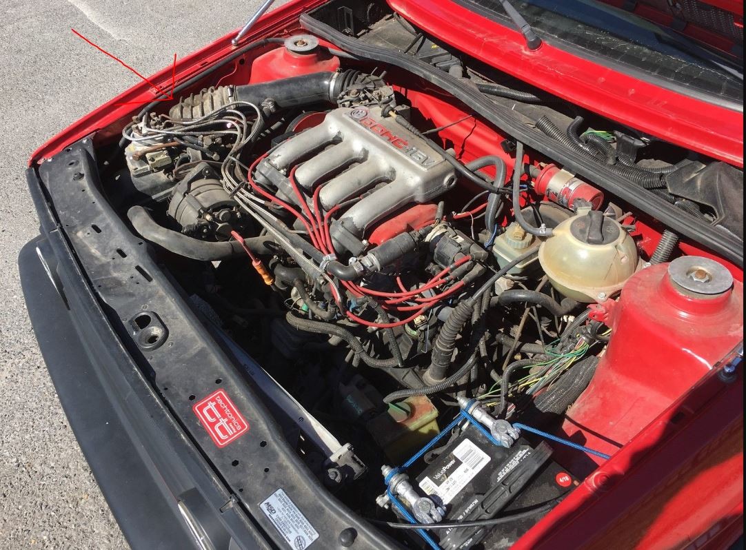

If it has the that old injection system, its gona give you headaches for days.
It has a flappy thing on the right of the engine bay where the pipes all sit, if that is dirty then it wont operate correcly and will effect the idling.
I had my system rebuilt before it started working 100%.
Maybe take a pic of the engine bay so i can see what system it has.

(19-06-2017 08:11 AM)Nick@TheFanatics Wrote:  Fuel pump at the rear wheel (cant remeber which side) also can affect the car.
I went thro 2 of them in my time.
[Image: 1_2375009544.jpg]
[Image: 2_7310327496.jpg]
There you go.

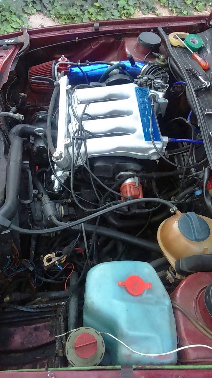

Yeah it was a 330D,
We know how to jump a car Biglol

On a cold start it idles low, but when the car heats up the revs goes to 3500 constant.
[Image: golfie_3324589366.jpg]
There she is Rollsmile

RE: My first car: GTi MK2 16v
That looks different to what mine did.
Mine had a bog black box thing on the right hand side.

(19-06-2017 10:51 AM)Nick@TheFanatics Wrote:  mine looked like this.
[Image: capture_3007400589.jpg]
Oh i see what you mean, the previous owner fitted a K&N cone filter.
Nick, thats the original K-jet injection, the flap was for fuel metering. Youngsters dumped that (probably a good idea) in favour of letting Dictator run the fuel.
