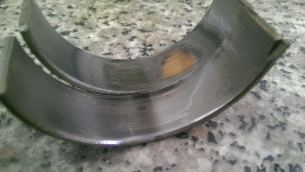

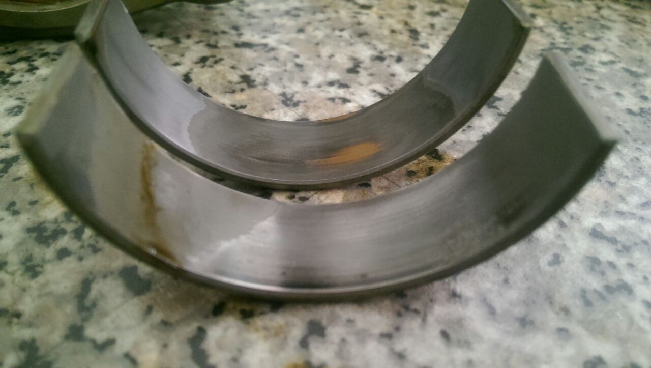

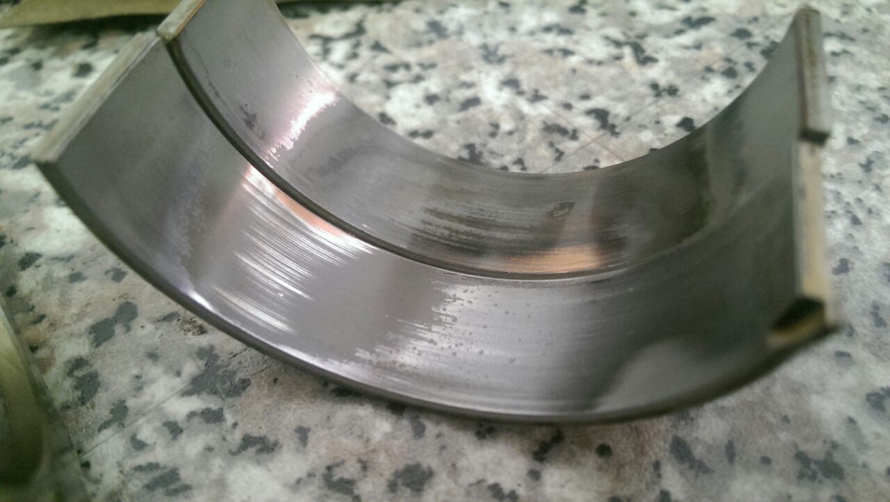

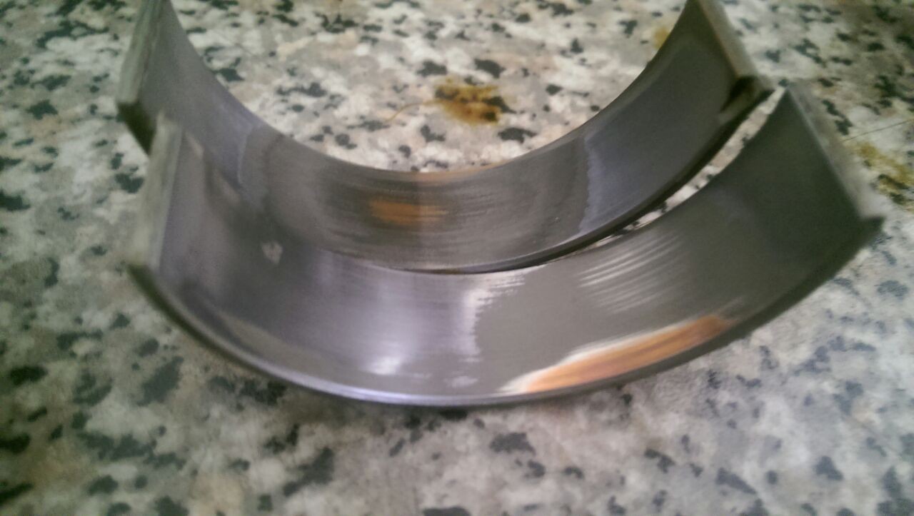

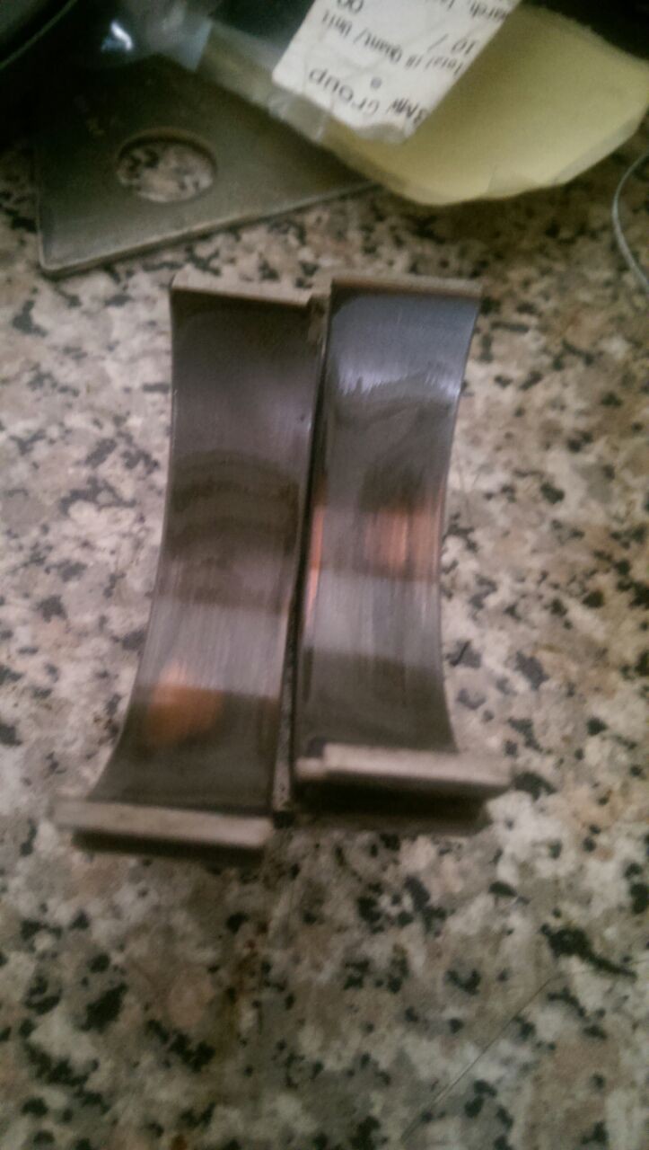

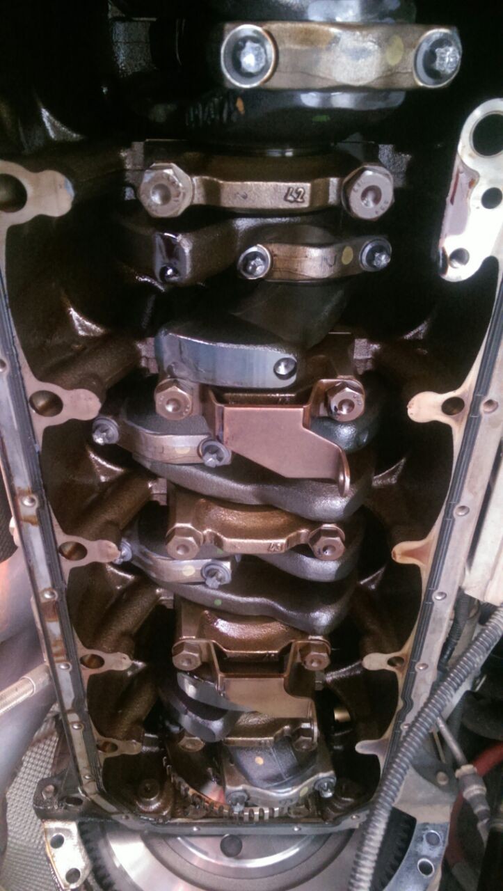

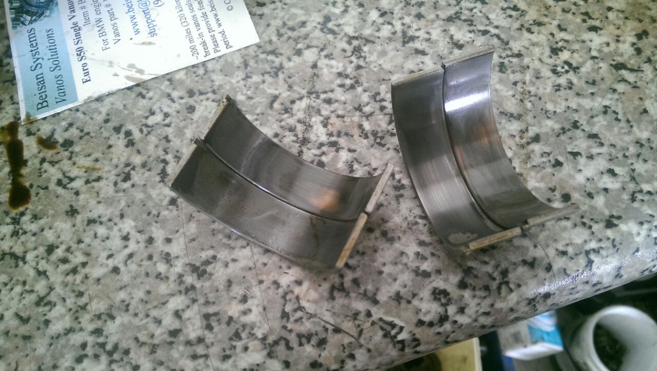

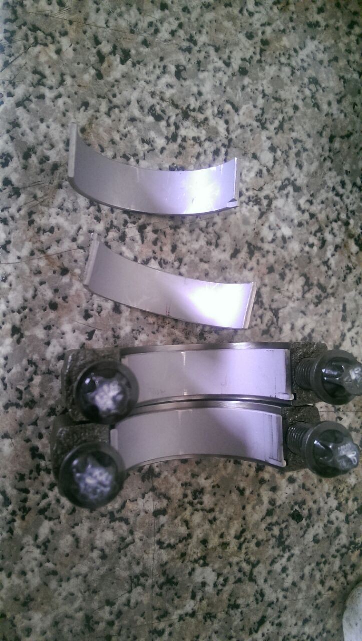

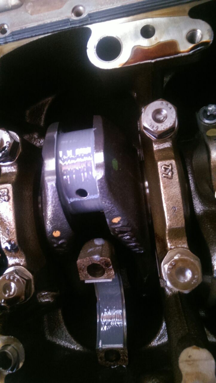

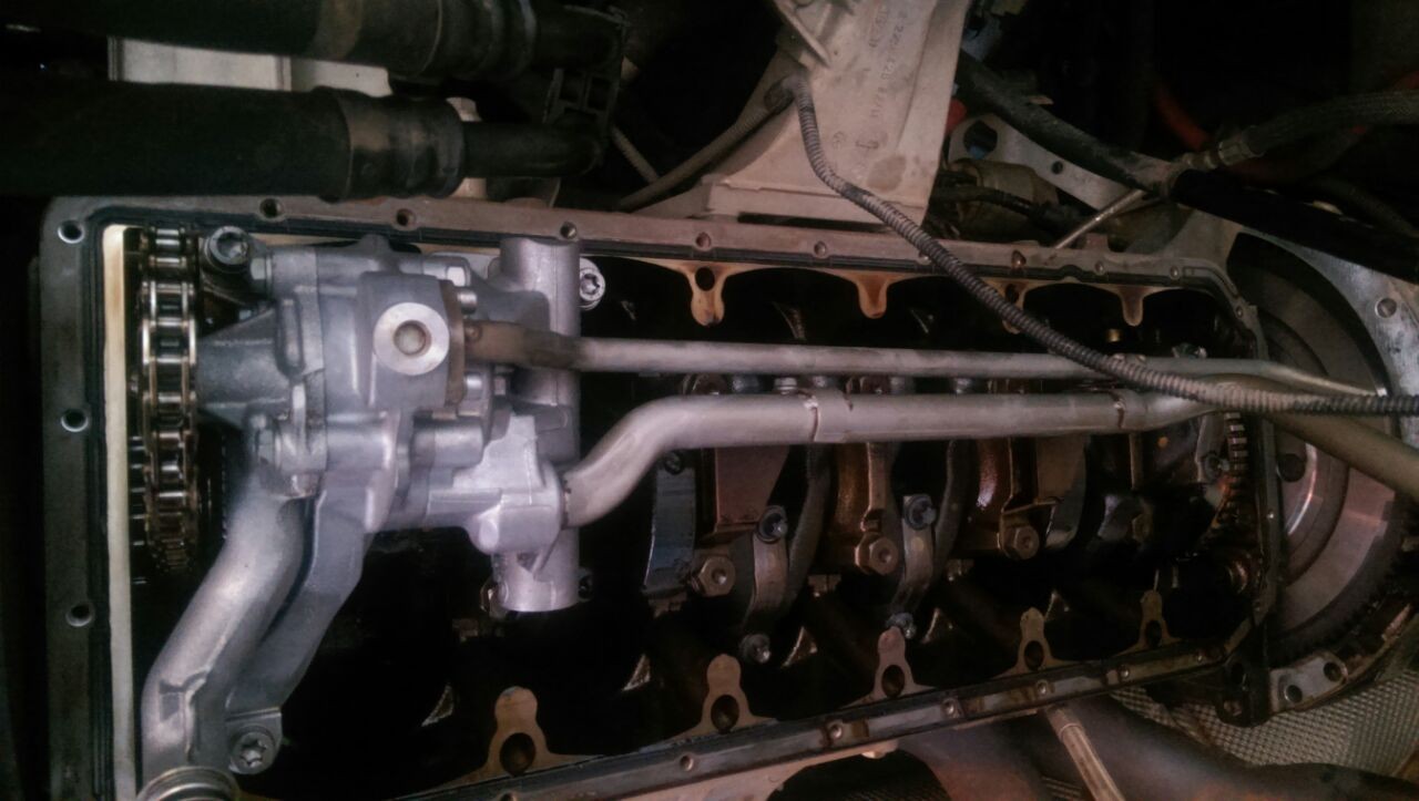

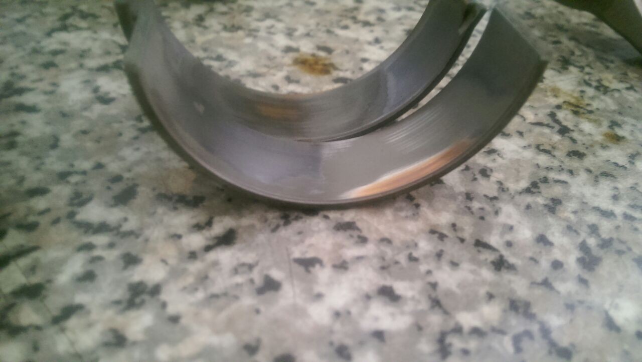

So amongst some of the other items that I became aware of and started tackling, was the notorious S54 bearings issue...
Seeing as I was already at around 149,000km when I became aware of the issue, I started shitting myself, and then started looking for someone to help!
On account of the posts on the forum, some advise from a few new friends, and the clear attention to detail in his pics, I opted to go to Peter...
A few pics of his work and the state of the bearings below...
I am relieved that I got it sorted! Thanks Peter!
Next few engine items will be the Vanos, clearances, etc.. but all in good time...

Just over 1,000km done of my 2,000km run in... and she's purring nicely!
Thanks again Peter!

Sho! that engine is clean! Nicely done!

Looks like a good save on those bearings! Well done for adding to the ever small population of de-risked S54s Bluebiggrin

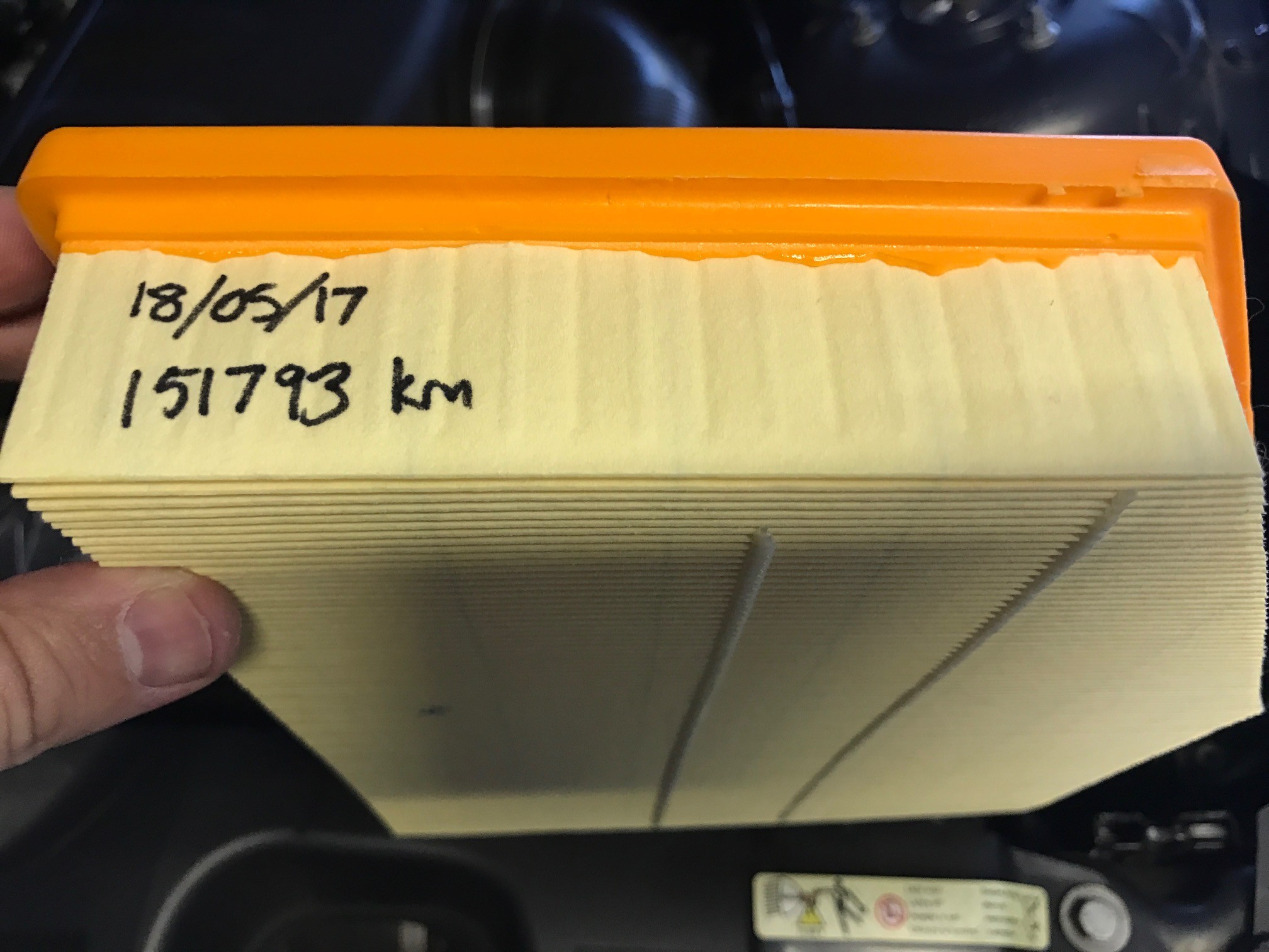

I didn't need to do the oil service, as the bearings and new oil filter and oil was just done recently...

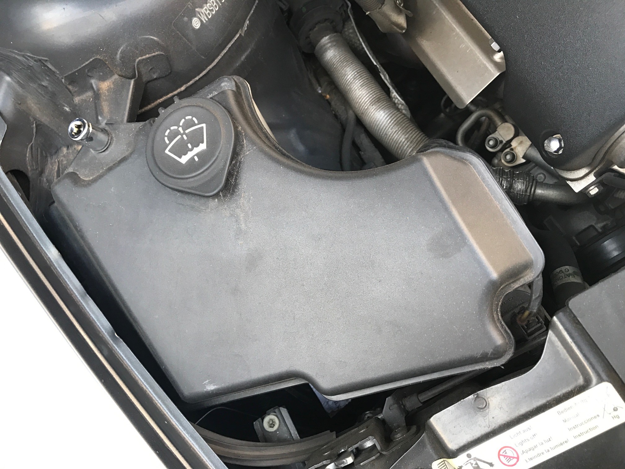

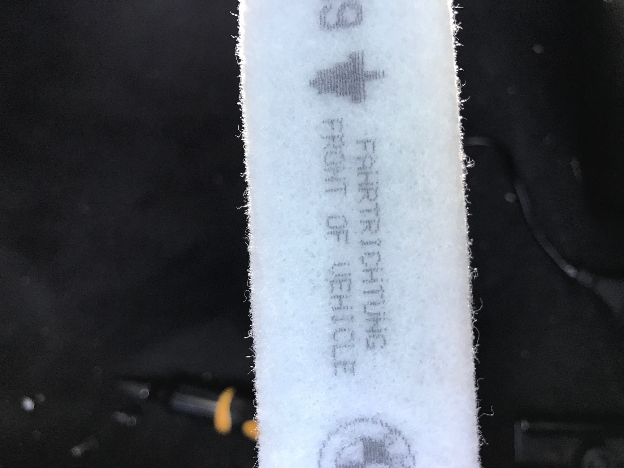

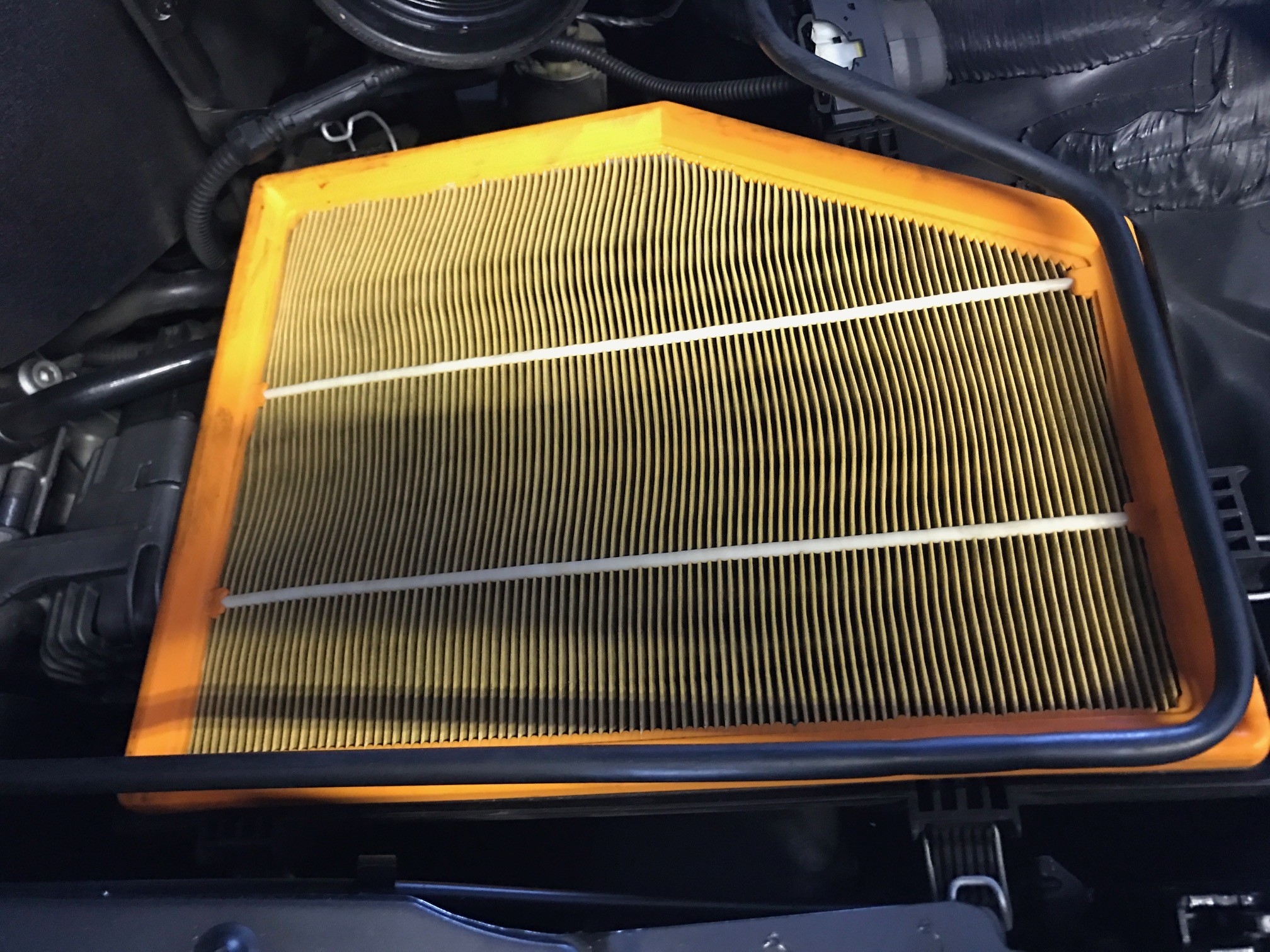

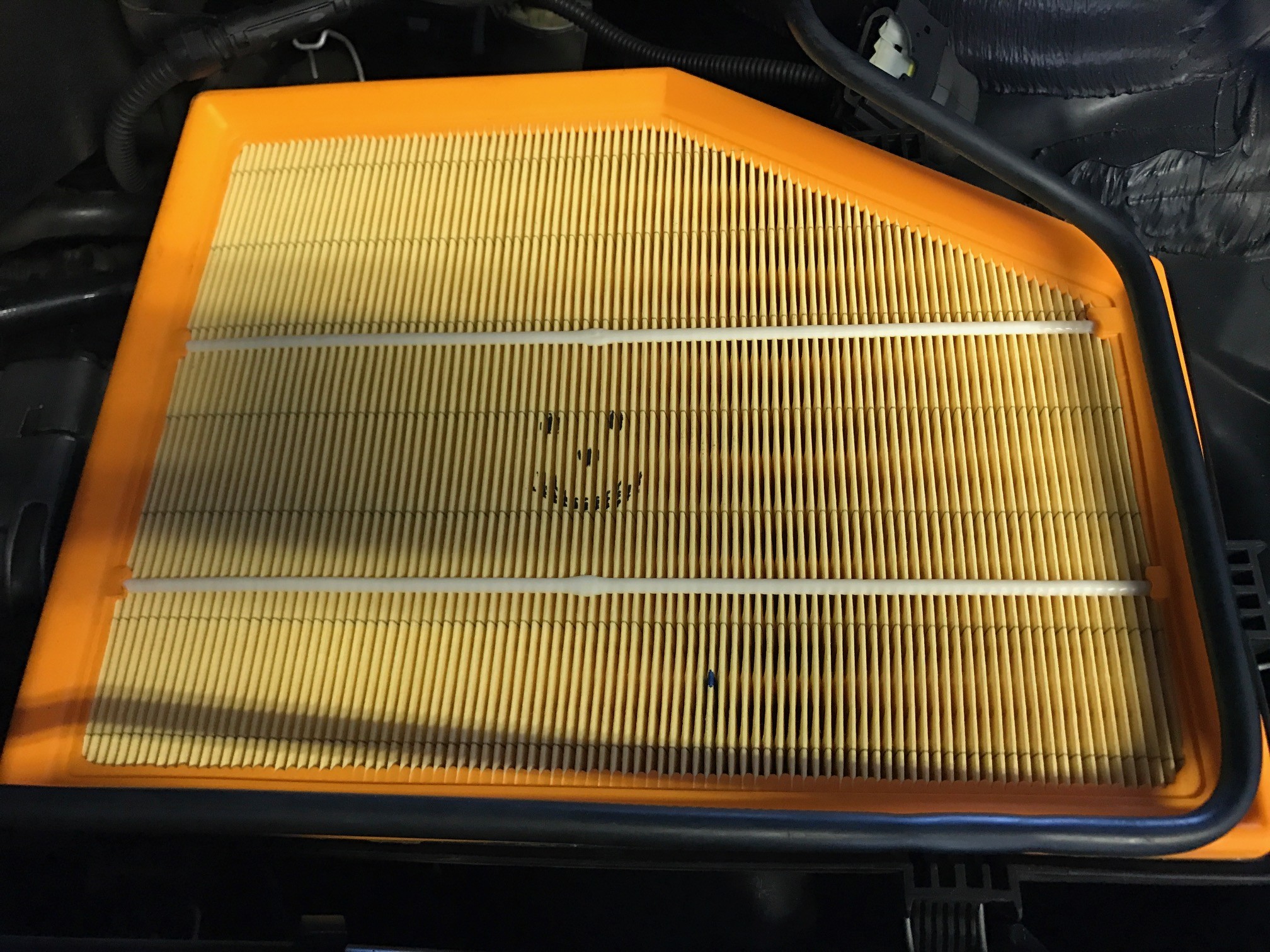

Anyway, so here's a few simple steps for changing the air filter (probably the single easiest thing to do in a service).
I opted for a BMW OEM one. I am not a big fan of the K&N long life oil types, as I have tried them before and ended up seeing better performance on the stock paper filters. Also there's some myths about the oil messing up the sensors down wind...
I am not showing the steps for the airfilter cover removal, as even my wife could (probably) do it...
[Image: img_5639_4455239456.jpg]
The old one wasn't too bad - and at least it meant that a new one was put in at BMW's last service...
[Image: img_5644_401861509.jpg]

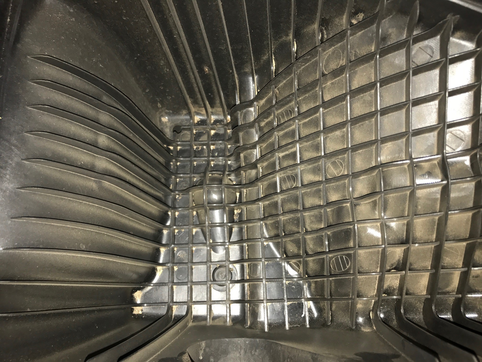

Not too dirty in here, but vacuumed and wiped it clean to make sure afterwards...
[Image: img_5645_4521904694.jpg]
And the new one in place... looking good!
[Image: img_5647_6684586121.jpg]

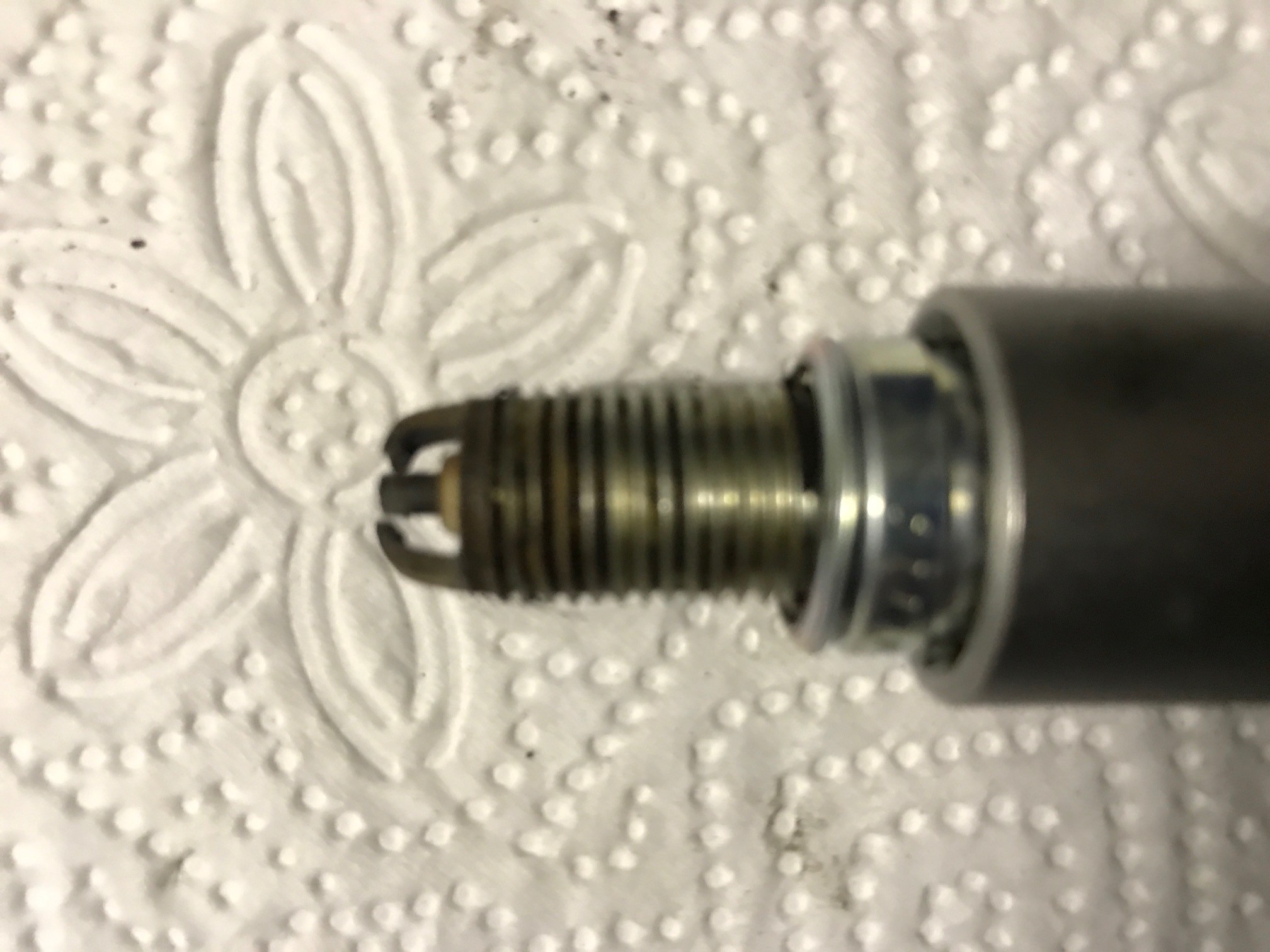

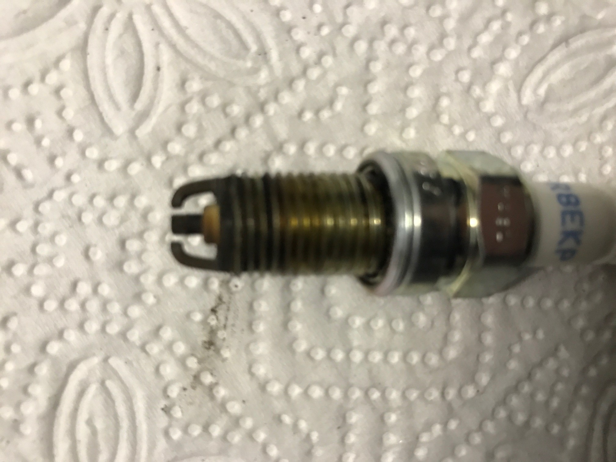

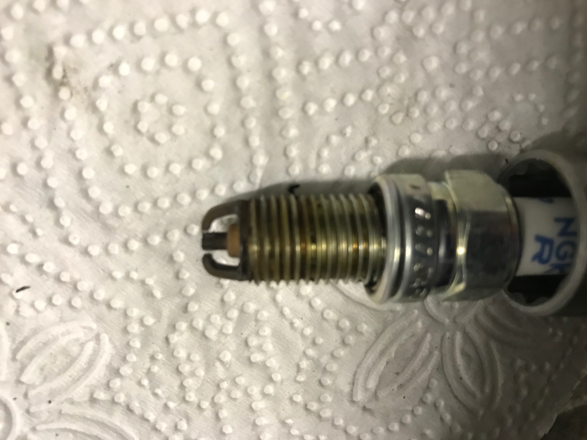

Then I moved on to the spark plugs...
It's pretty easy stuff it seems...
1. You need a 10mm socket, for the cover

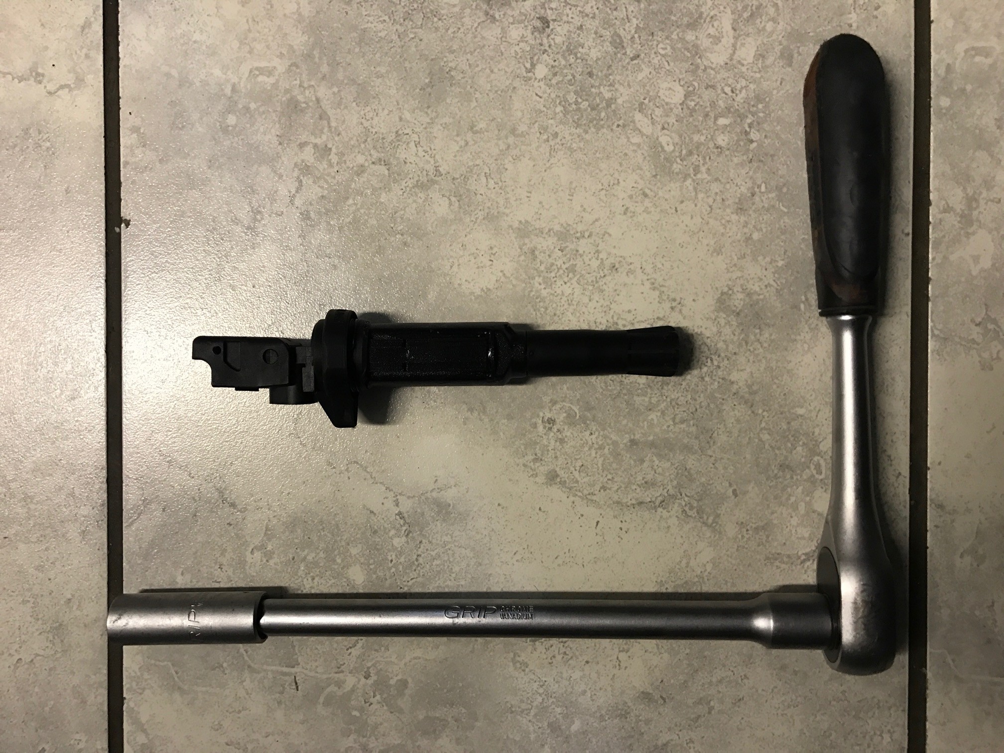

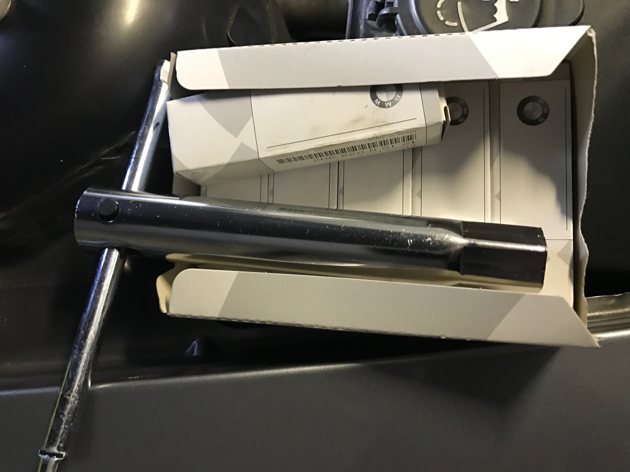

2. You need a 16mm spark plug tool thingy. This is where I hit a snag once I opened up and saw how damn deep the spark plugs were! My tool just wasn't long enough for the job at hand! Trust me - this is a first for me... Rollsmile
So, I ended up closing it all up again, and I will attempt tomorrow once I have seen to my tool!Rollsmile

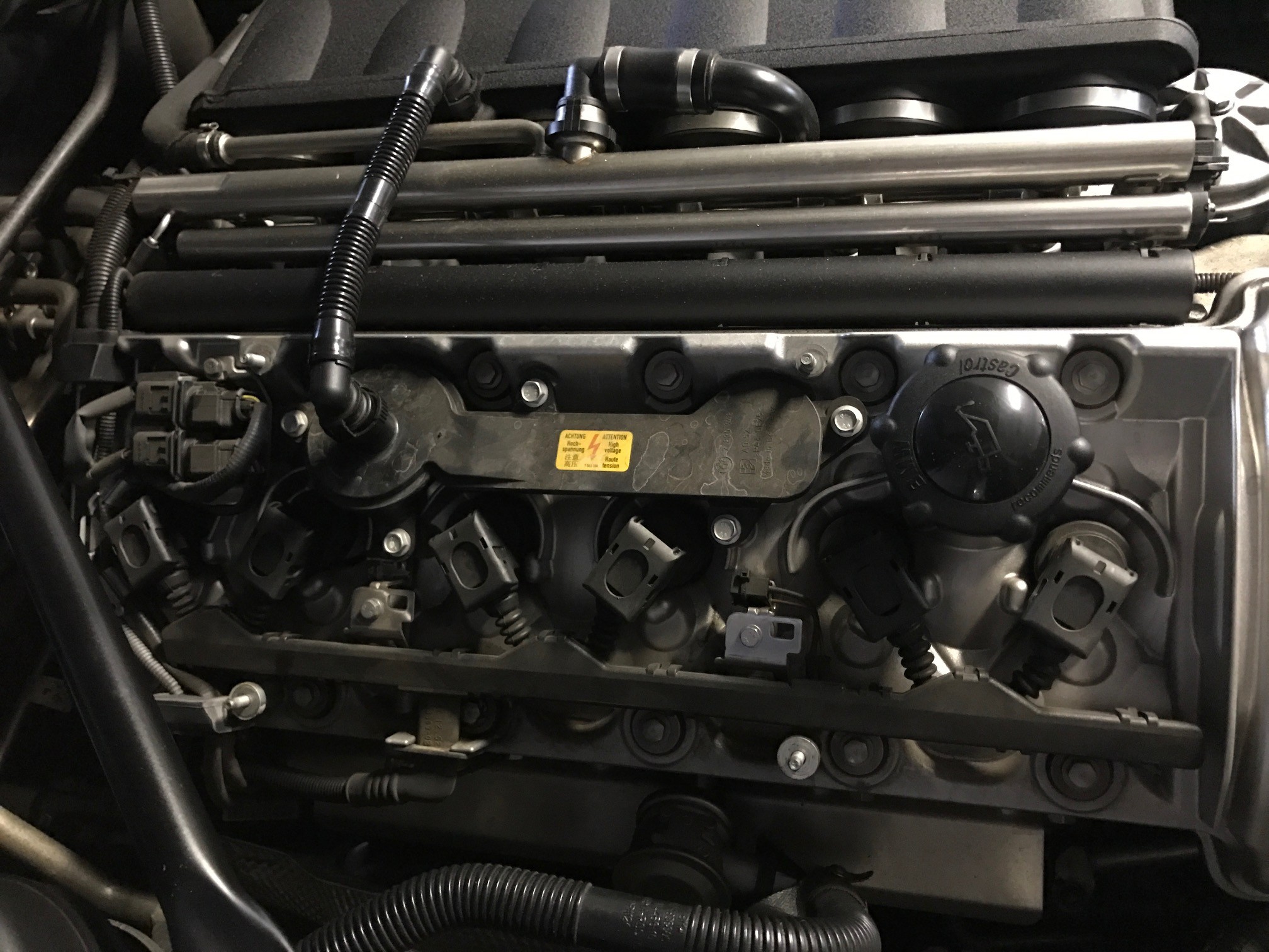

It's easy enough to remove the 6 nuts with the 10mm socket wrench...
[Image: img_5653_5210934216.jpg]

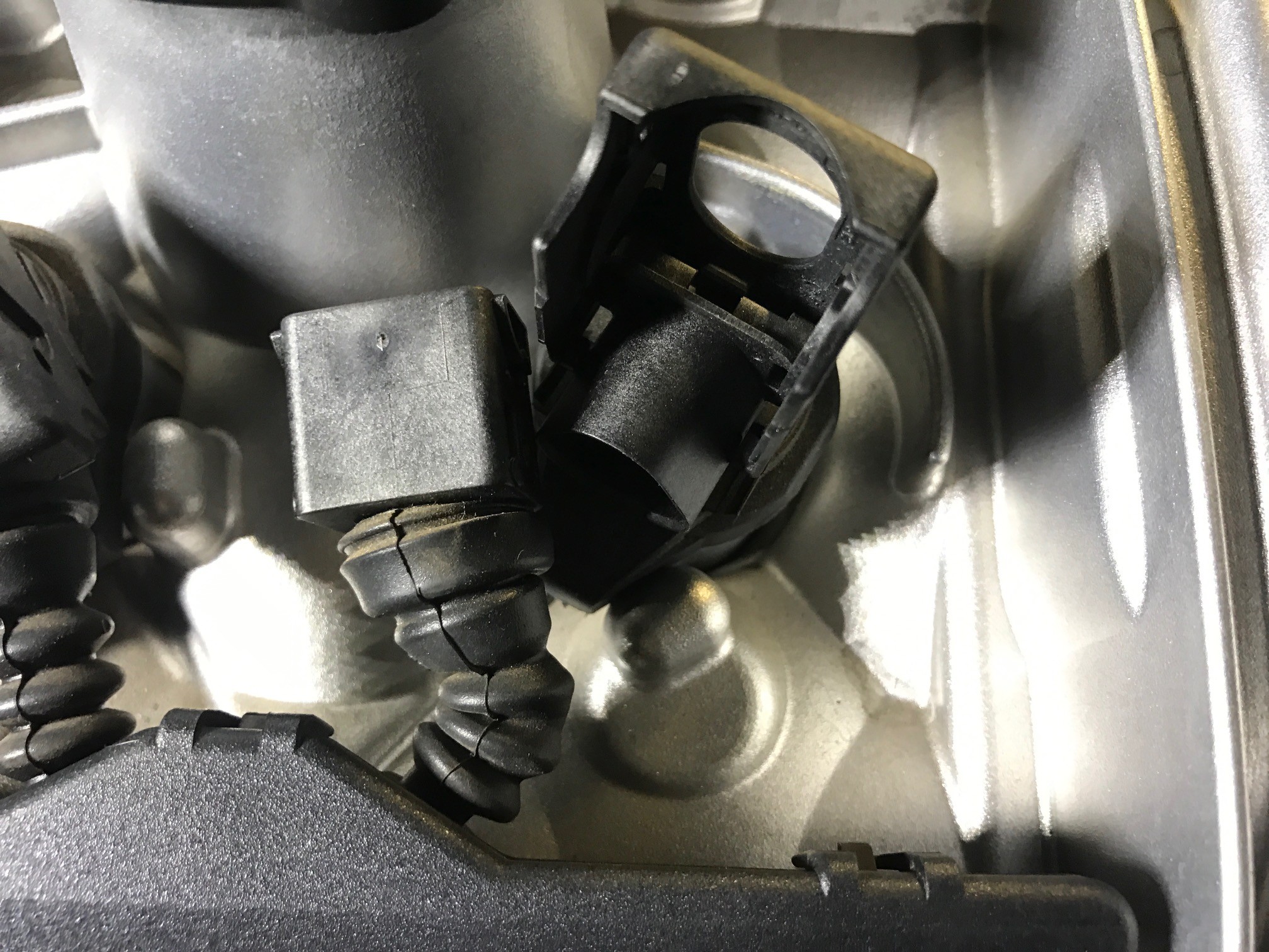

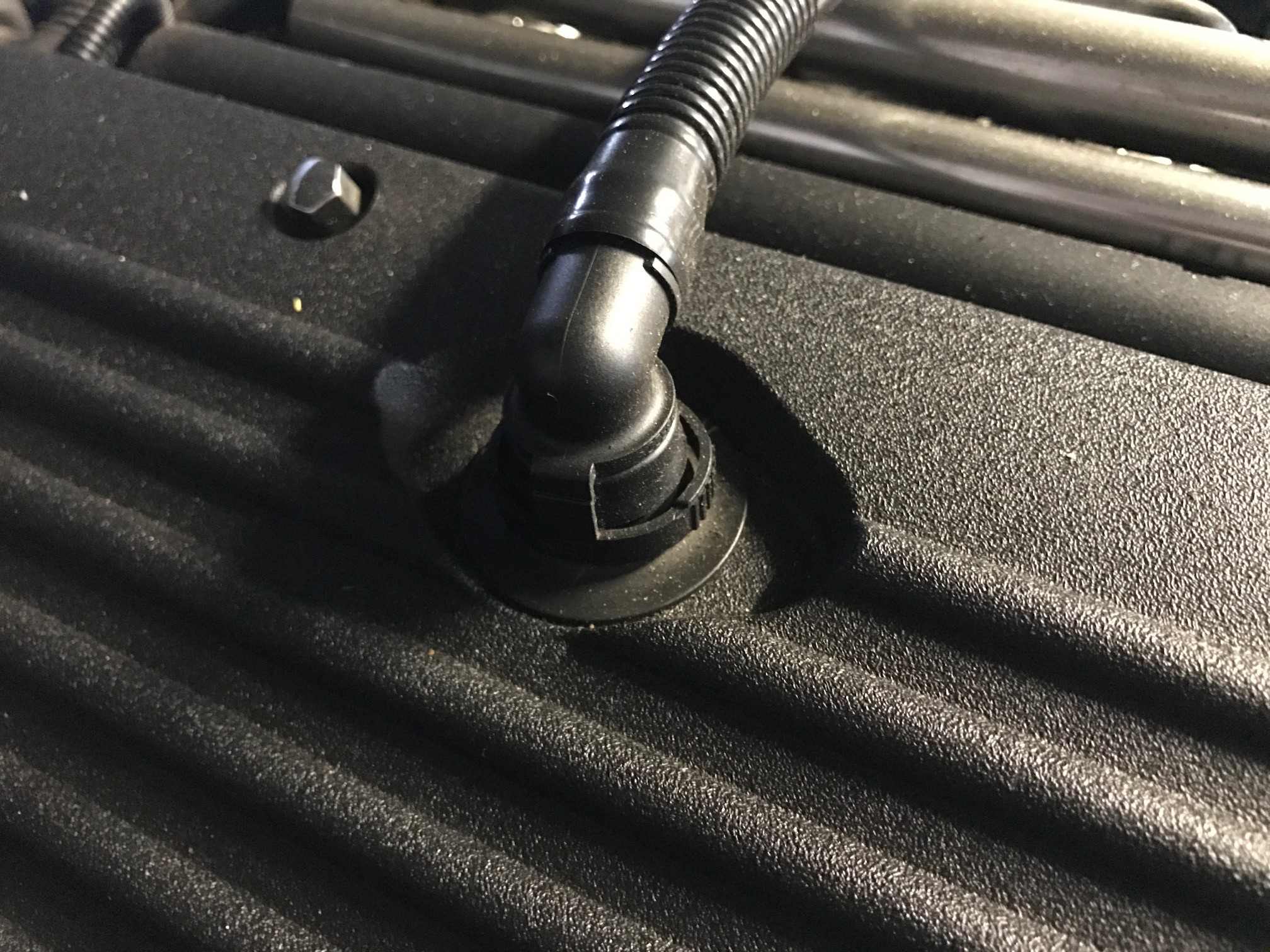

You will also need to remove the tube and the oil cover, before the whole cover can be removed... gently squeeze and lift the tube.
[Image: img_5663_2055787229.jpg]
Once the cover is removed and safely stored, you can see the coils covering the spark plugs.
[Image: img_5665_2852926999.jpg]
It's quite easy to lift the coils, gently pry off the plug, and then lift out the coil, after which if you have vertigo, don't look down the hole!
[Image: img_5666_7974998243.jpg]

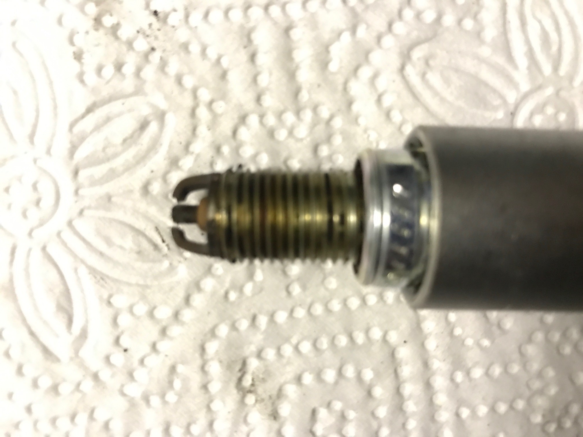

My tool just wasn't long enough for the job! So I put everything back (and she starts as good as always)... and I will continue tomorrow...
[Image: img_5667_4752546907.jpg]

Glad to see Im not the only one to mark their filters.

(18-05-2017 07:10 PM)Gizmo@GARAGE46 Wrote:  Glad to see Im not the only one to mark their filters.
So brake fluid flush is due...Tiptoe
Nice work btw.
It's a very nifty trick, I suspect he picked it up from you Bluebiggrin

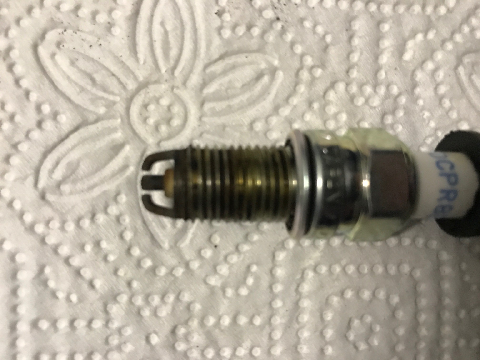

Pete plugs need to be torqued to 22Nm without any lubrication on the threads.
Please do not put them in without a torque wrench.
Nice work btw.
I've seen it on a number of posts, and my dad used to do it WAAAAYYYY back in the day (he was fastidious to a fault!). Definitely noticed it on your M Coupe recently too,... CoolShake

(18-05-2017 08:39 PM)Peter@AEW Wrote:  Pete plugs need to be torqued to 22Nm without any lubrication on the threads.
Thanks Peter. I noticed that on the spark plug box, and also read up on that!

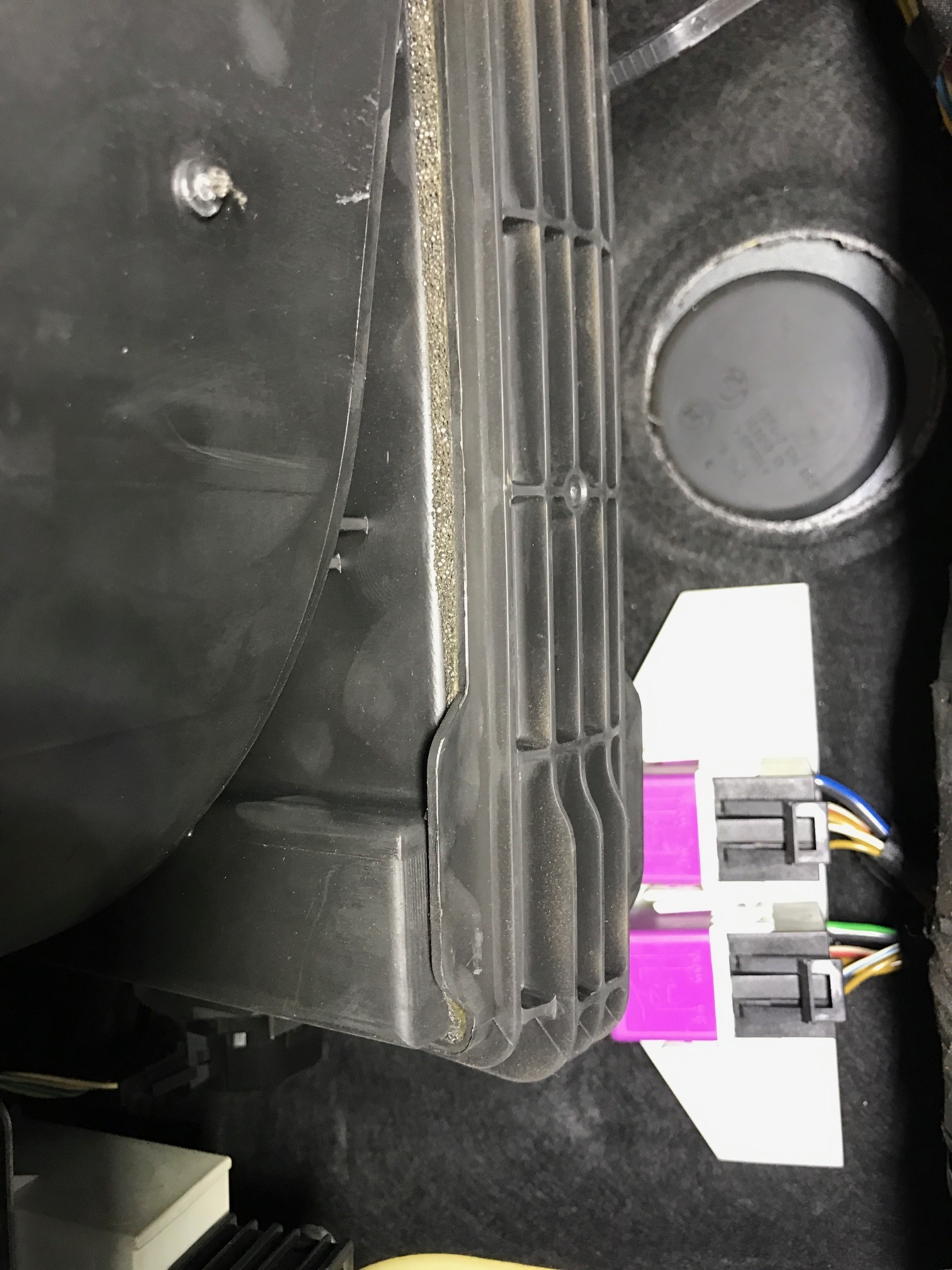

What a crazy coincidence… I just did my Z4M's sparks & air filter today as well. I also mark filters, so many stories about stealers never changing it despite charging you.
I plan on doing VANOS & bearings etc too but I'm in CT.
Peter, you should come down for a workation Wink
PS. There's a hole in the top left corner of the air box.
Apparently for draining the box should any water enter somehow…
That being said, some guys suggest closing it up to make the ram air effect work properly/better…
Use it, don't use it, just throwing it out there Tiptoe

(18-05-2017 11:16 PM)NavZ Wrote:  What a crazy coincidence… I just did my Z4M's sparks & air filter today as well. I also mark filters, so many stories about stealers never changing it despite charging you.
Hey there!
Yes, I noticed the little hole. Think I will leave it as is for now... did you close it up?
I would love to take the Z down to the Cape sometime. We have family in Paarl, so definitely want to do that at some stage! Maybe can come by and visit and check how your Z is coming along when we do!
Good luck with the Vanos and bearings! I think that's just a tad out of my league to try mess around with that! So I will leave that to the pro's!

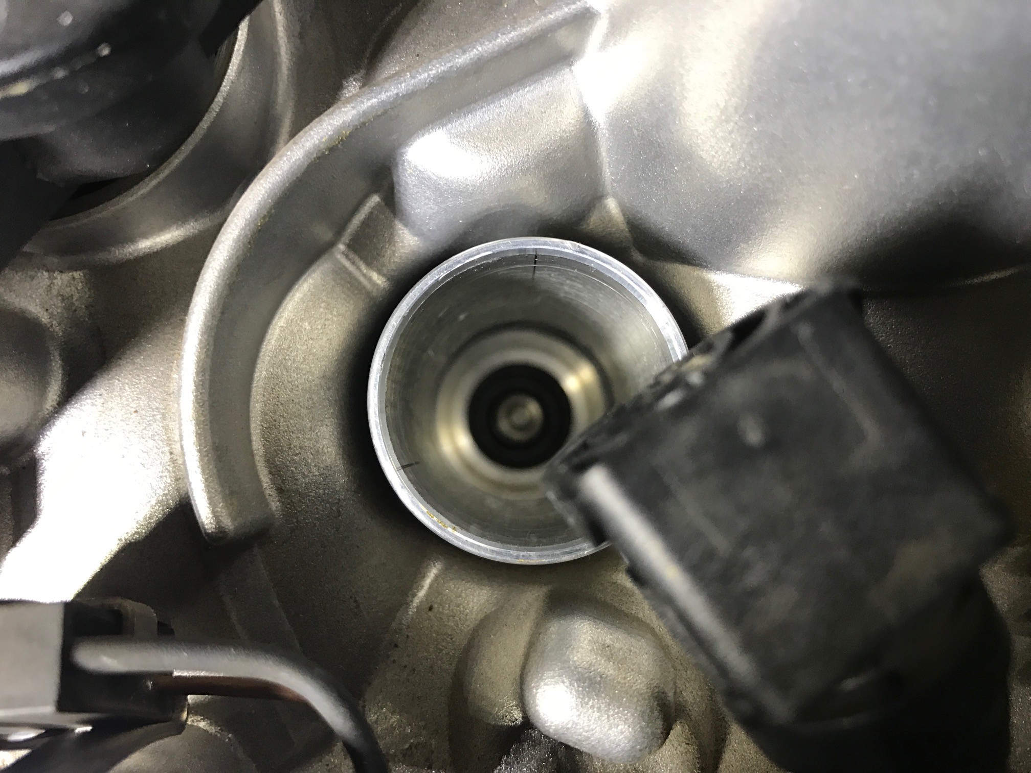

So the fun continued later last night, after I managed to borrow some appropriate tools! (Many thanks to Spiro for dropping them off! I owe you bud!!)...
This gives an idea of depth, the coil is fairly long...
[Image: img_5672_2915923525.jpg]
The plug is way down in there...
[Image: img_5678_5452197869.jpg]

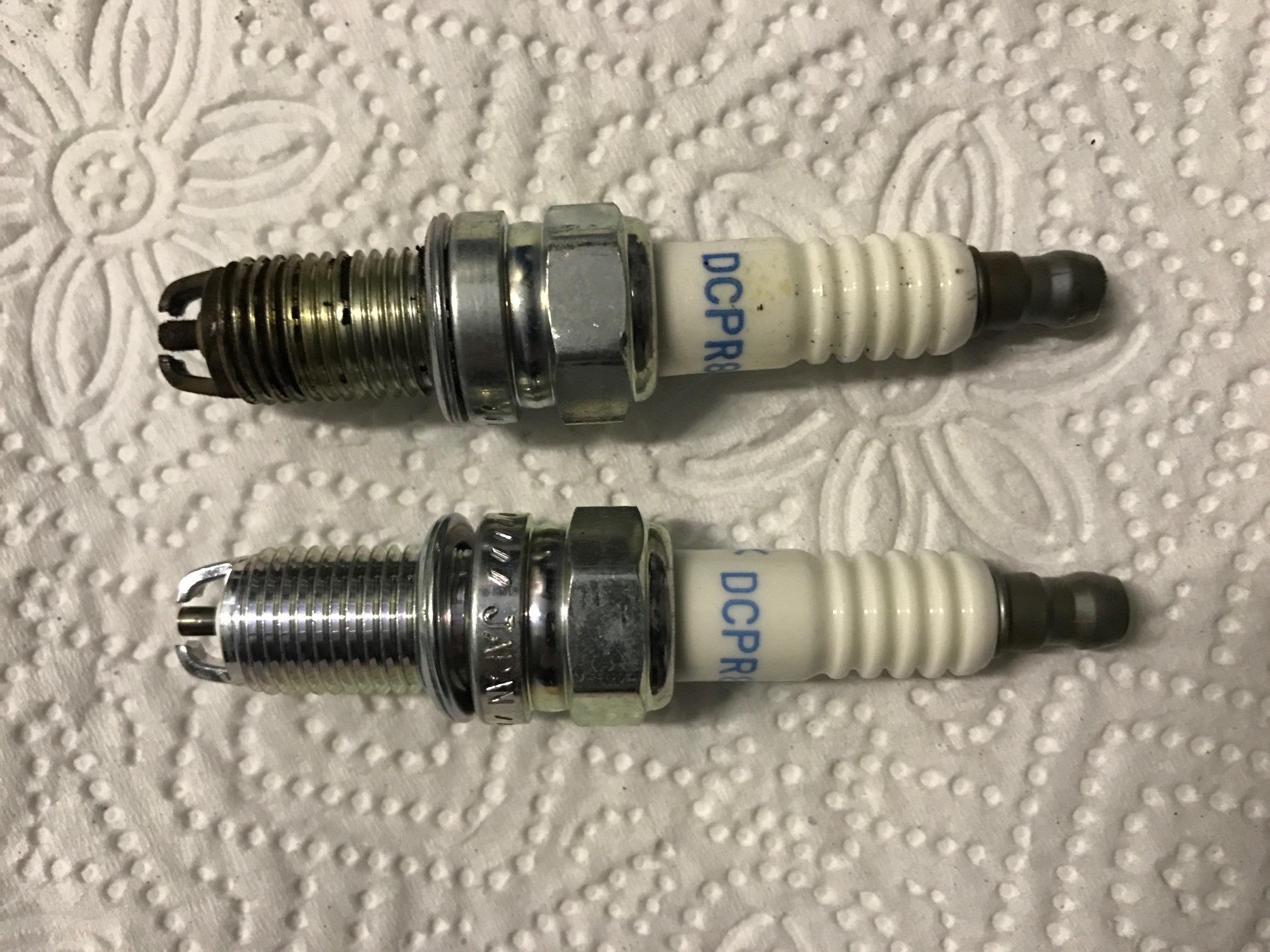

Plug 1 (old and new)...
[Image: img_5675_4779713419.jpg]
Plug 2...
[Image: img_5676_6902061873.jpg]
Plug 3...
[Image: img_5679_2763001853.jpg]
Plug 4...
[Image: img_5682_8499796963.jpg]
Plug 5...
[Image: img_5685_3163253488.jpg]
Plug 6...
[Image: img_5686_6247445433.jpg]
What you guys think? Plugs don't seem too bad?
I still have to go look through my records to see when they were replaced by BMW (in which of the services)...
After closing everything back up again and starting her up, she purred beautifully! Very satisfying to say the least!
Thanks again to Clinton and TTT (Thiren) for the guidance and assistance!

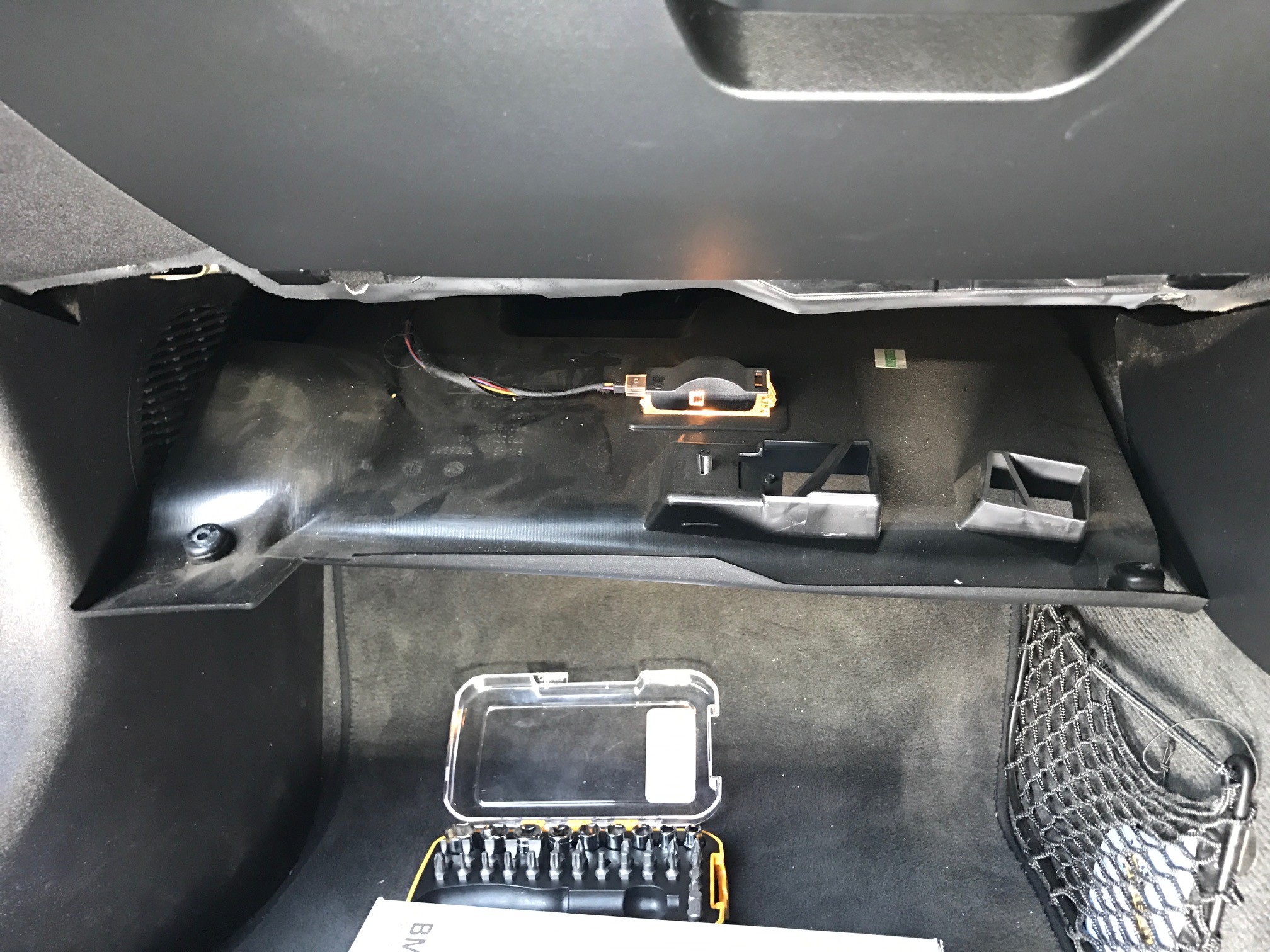

Forgot to add the inside cabin air filter pics...
Also a far simpler job than I had previously been lead to believe! ("It's behind the cubbyhole, it's a pain to get to..." blah, blah, sh*t...)
It's located above the passenger foot-well, behind the cubbyhole. There's just the two normal phillips head screws to loosen, and then you can pull down the cover, being careful with the light.
[Image: img_5824_196182727.jpg]

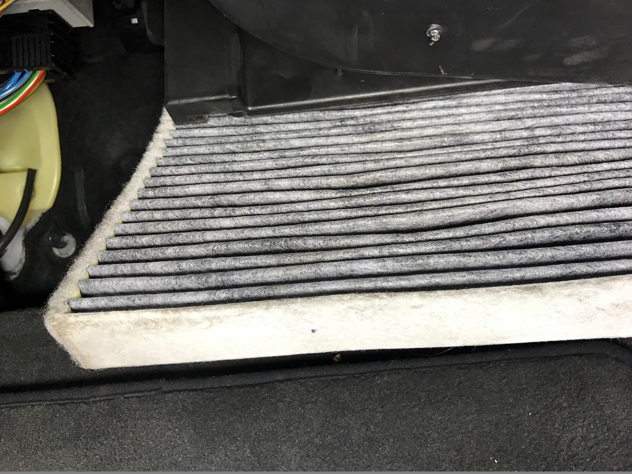

Once you have removed the cover (to clean it and for easier access), you will see the filter housing. The filter door is just gently pulled down and away to remove it.
[Image: img_5826_9371678023.jpg]
With the door removed, you can then pull out the filter.... be prepared to vacuum this area a bit if you have some leaves and other stuff fall out!
[Image: img_5827_4323480115.jpg]
Putting the new filter in is an easy process, just focusing on placing the filter back in with the correct side facing the front of the vehicle.
[Image: img_5828_646907133.jpg]
Then reverse the rest of the process to place everything back!
Ah, great aircon strength again... CoolShake

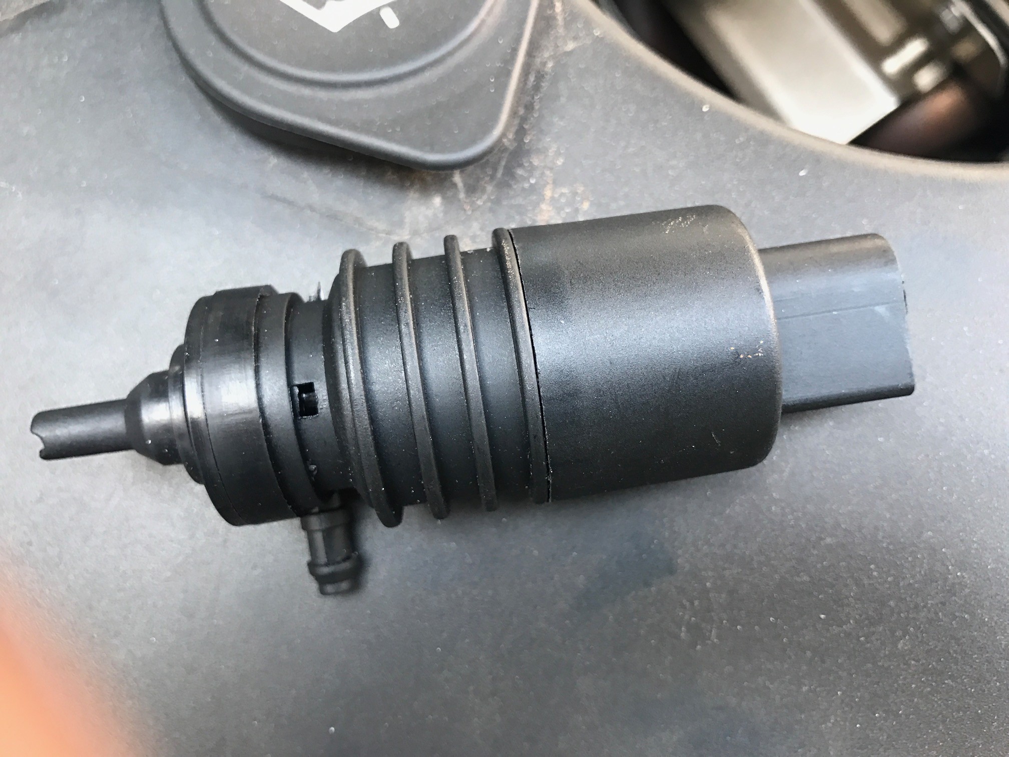

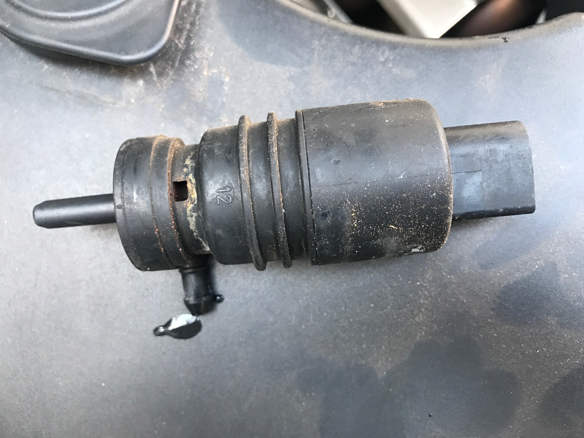

Quick window washer pump fix...
This engine bay needs a good clean - putting it on the to-do list...
[Image: img_3710_972215351.jpg]
Old pump...
[Image: img_3712_3838920891.jpg]
New pump... (from eBay at 1/8th the cost of BMW) and sorted... all good again...
[Image: img_3711_4206193690.jpg]
