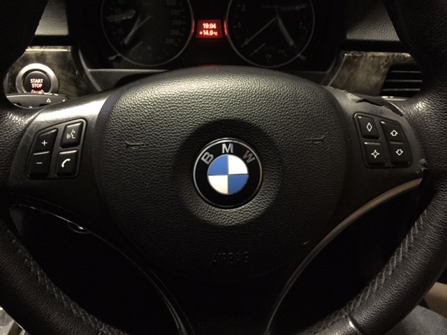

Also peeled off that horrible soft touch crap from the steering wheel, it will get carbon skinned soon.

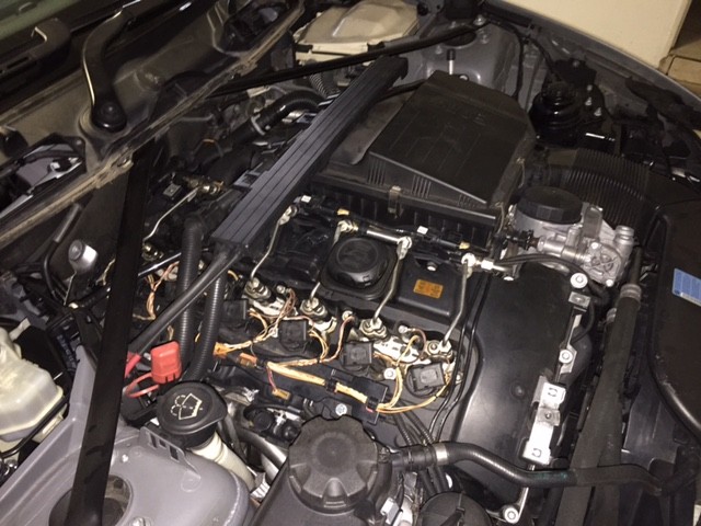

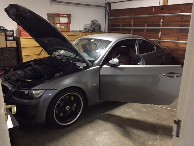

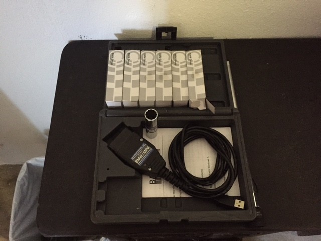

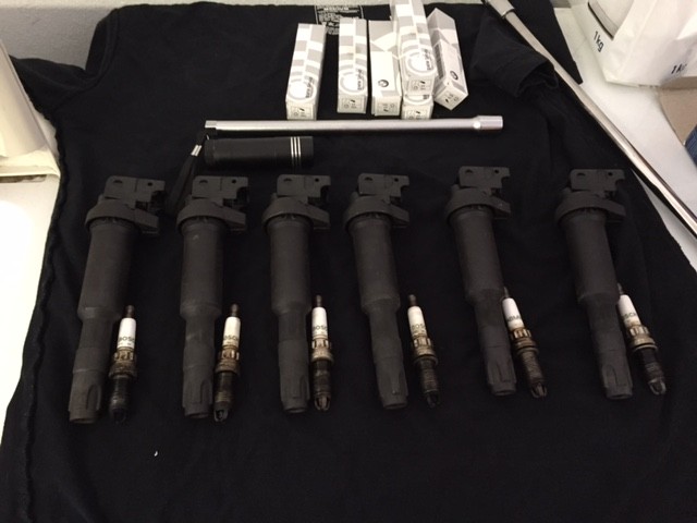

On Thursday the car started misfiring, luckily it was not injector as I feared.
I collected new sparkplugs from Gideon (Previous Owner) and his diagnostics cable (thanks a million bud). Purchased the correct socket (14mm 12point narrow wall) from the toolshop.

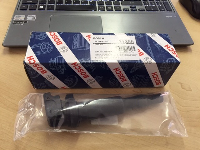

[Image: img_4070_7054350762.jpg]
Purchased a new Coilpack from Goldwagen for just in case, luckily it was coilpack on cylinder no 2.
[Image: img_4030_3256167802.jpg]
Was lot easier than I thought, 30mins and all the plugs was changed and everything back together.
[Image: img_4049_9363837512.jpg]

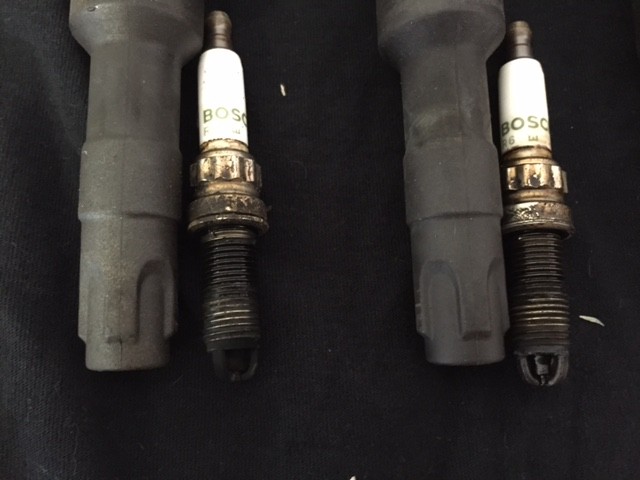

The plugs on cyl 1 & 2 were in a sad state, good thing I changed them.
[Image: img_4081_6743416143.jpg]
[Image: img_4084_8059399025.jpg]
Fault codes were cleared and she is pulling like a demon as before.
