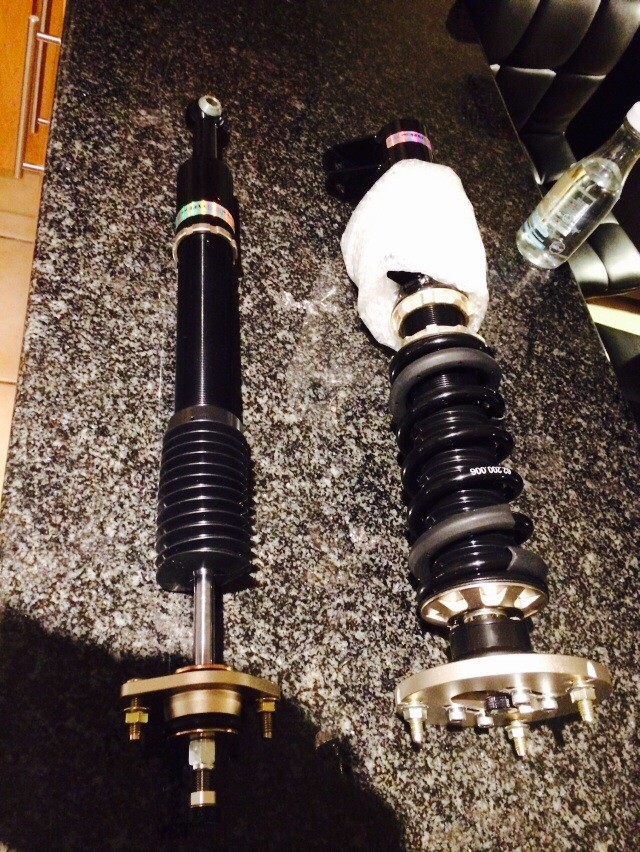

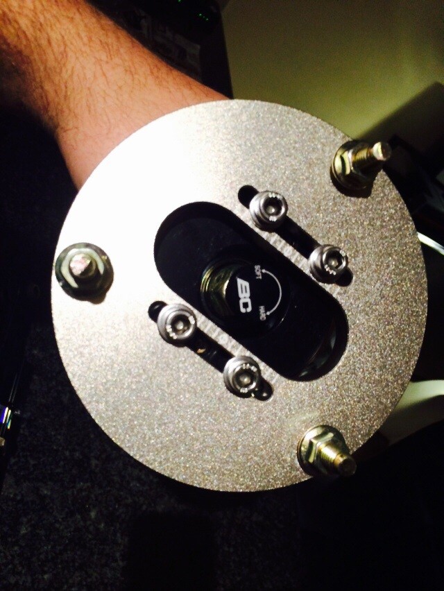

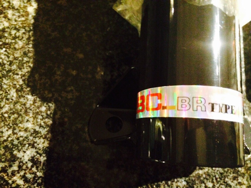

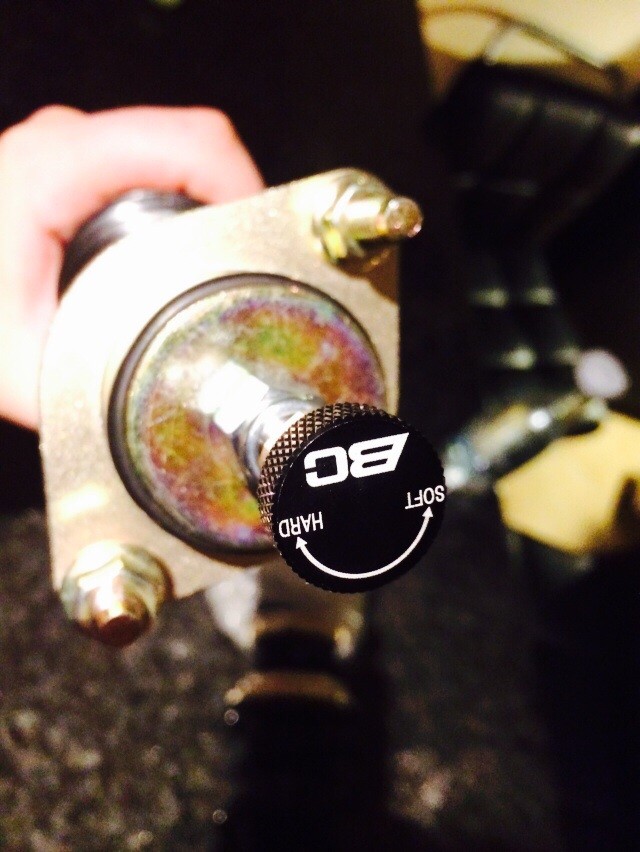

But on the upside these came today, they look great, build quality seems to be good
BC BR-RA Full Coil Overs 32 way adjustable
[Image: img_5183_6139655471.jpg]

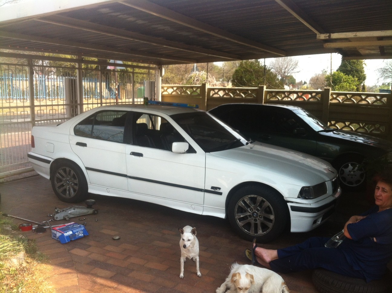

31-08-2015, 01:30 AM (This post was last modified: 31-08-2015 01:35 AM by Captain_Stealth.)
Post: #45
RE: Rough Rider 325i

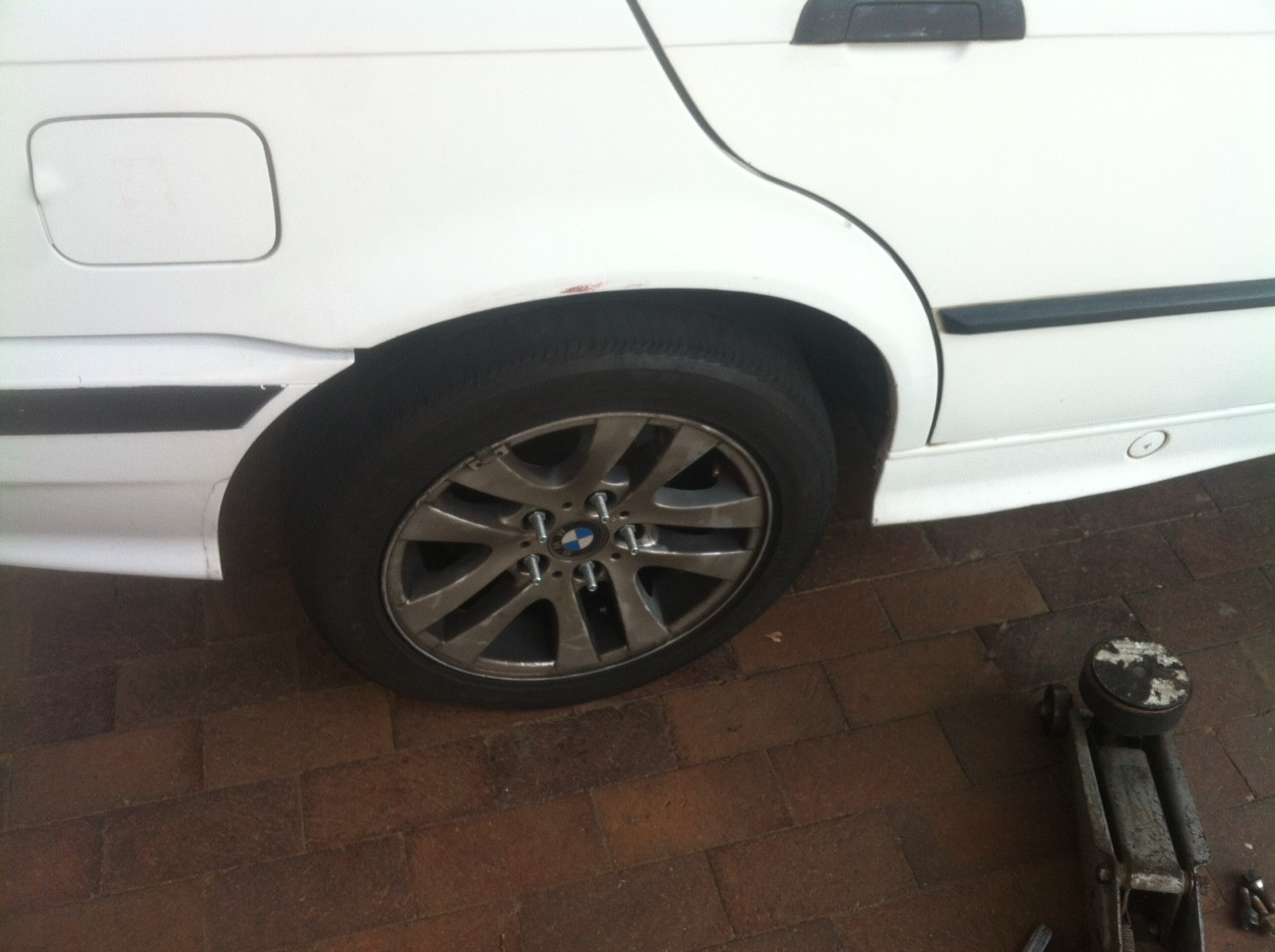

Been so busy haven't had time to even look at my project worst part is I have 90% of my parts
Had a gap this weekend so did some workings
Indicator Harness Wire Up and Install Corner light - Got from Brucet
Change Wheels to E90 3 series 16" Rims
Install Rear Wheel Studs - Got from Axis
Rear View Mirror - EBAY
ZHP Weighted Gearknob
On the way to my parents house where I do all my stuff, worst thing about racecar no storage compartments lol
[Image: image_1_7198623307.jpeg]
[Image: image_2_9381617605.jpeg]

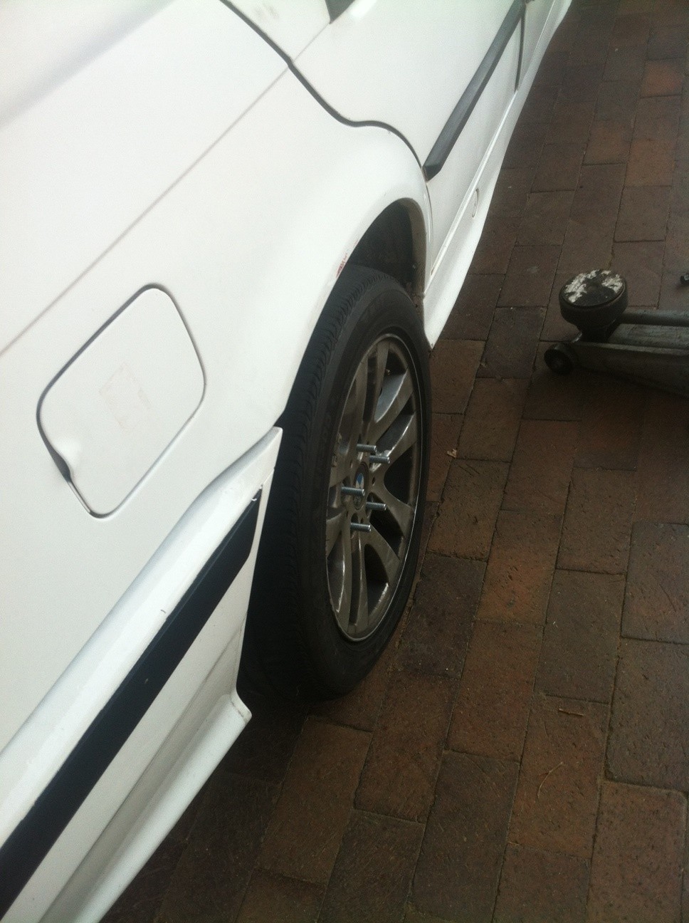

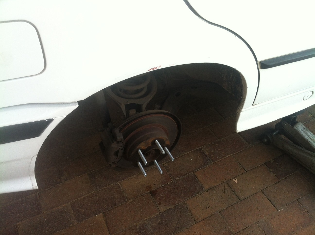

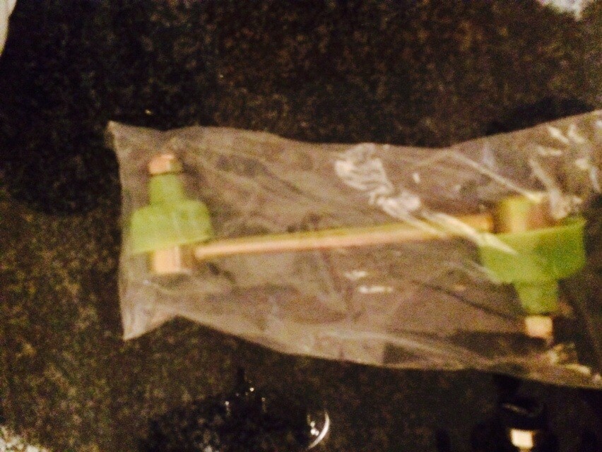

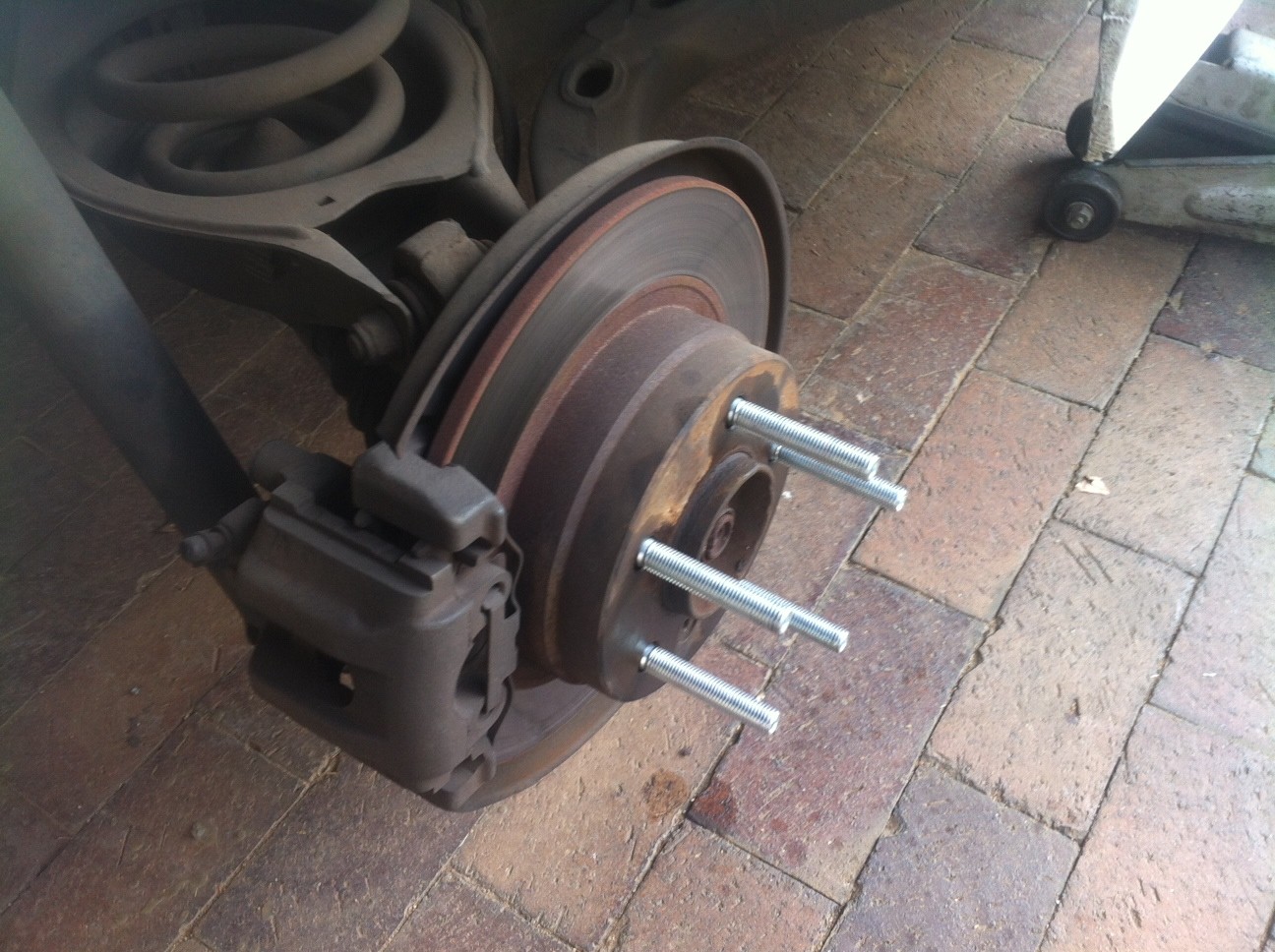

Rear wheel studs conversion for easy rear wheel changes, should have gone with the shorter length but its ok for now
[Image: image_4_3122422560.jpeg]
[Image: image_3_1220362614.jpeg]
[Image: image_5_987029192.jpeg]
[Image: image_6_9819923955.jpeg]

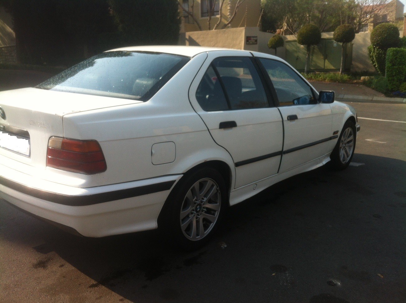

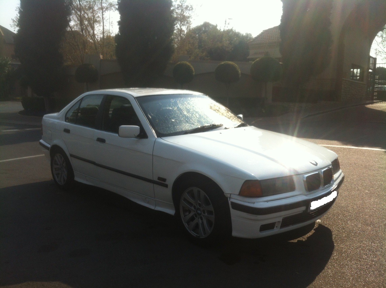

E90 Rims - excellent fitment no wheel touching, the wheels that were on the car were 175/60/50 RedNo with bubbles in them
[Image: image_8_5529333651.jpeg]
[Image: image_11_9458854096.jpeg]
[Image: image_12_6689754361.jpeg]
[Image: image_13_1270201439.jpeg]
[Image: image_5741460677.jpeg]
Looks like a 4x4 atm, coilies to be installed soon...

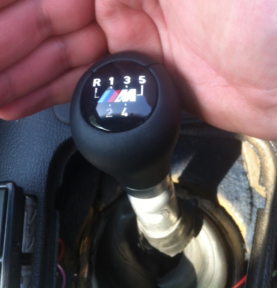

ZHP E46 Weighted shifter
[Image: image_10_6244710152.jpeg]

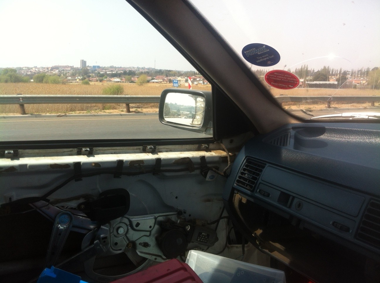

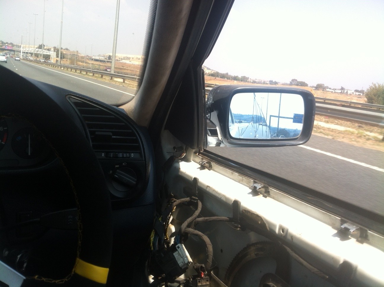

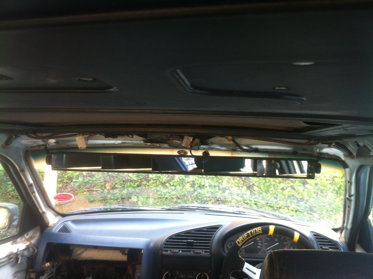

Rally Rear View Mirror - so much view I dont need side mirrors lol
[Image: image_15_8524495768.jpeg]

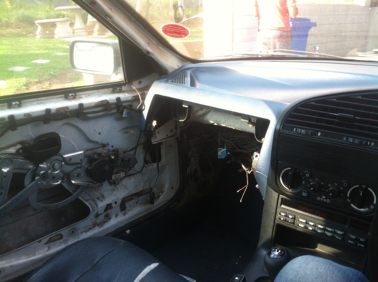

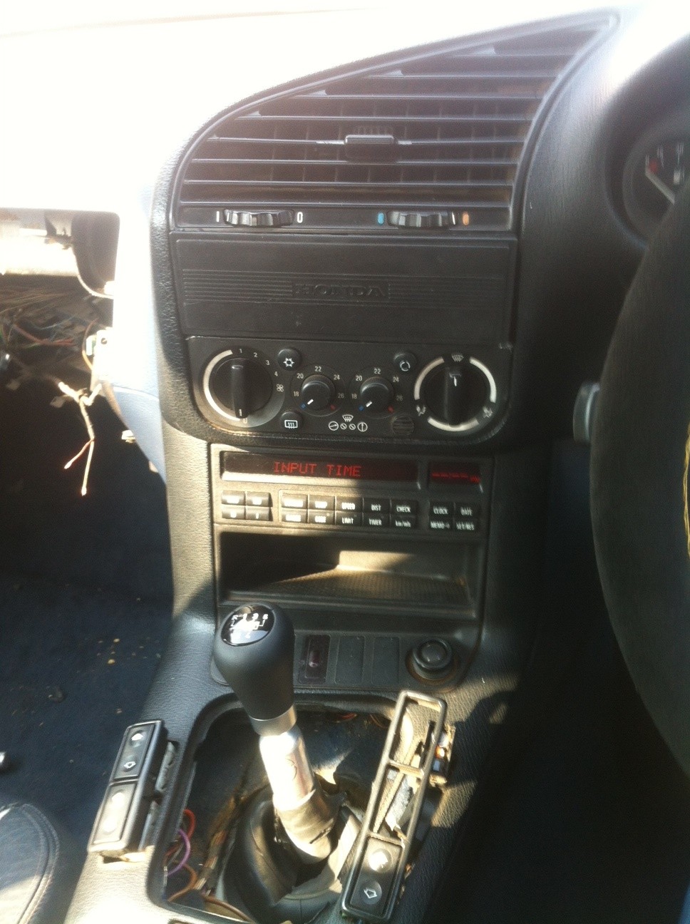

Some interior pics
[Image: image_7_386265595.jpeg]
[Image: image_9_1727396161.jpeg]

Awesome guy.. BTW how did you get the original Gear knob out, i want to get the same gear knob but cant seem to remove the original 1. When twisting, the rubber twists not the whole knob if u understand wat i mean
Preno

(31-08-2015 09:19 AM)Prenevan Wrote:  Awesome guy.. BTW how did you get the original Gear knob out, i want to get the same gear knob but cant seem to remove the original 1. When twisting, the rubber twists not the whole knob if u understand wat i mean
Usually you've got engage neutral to avoid cracking your windshield or review mirror, pull straight up with your chin/face out of the way as the release is very sudden. Quite a bit of force is required.
