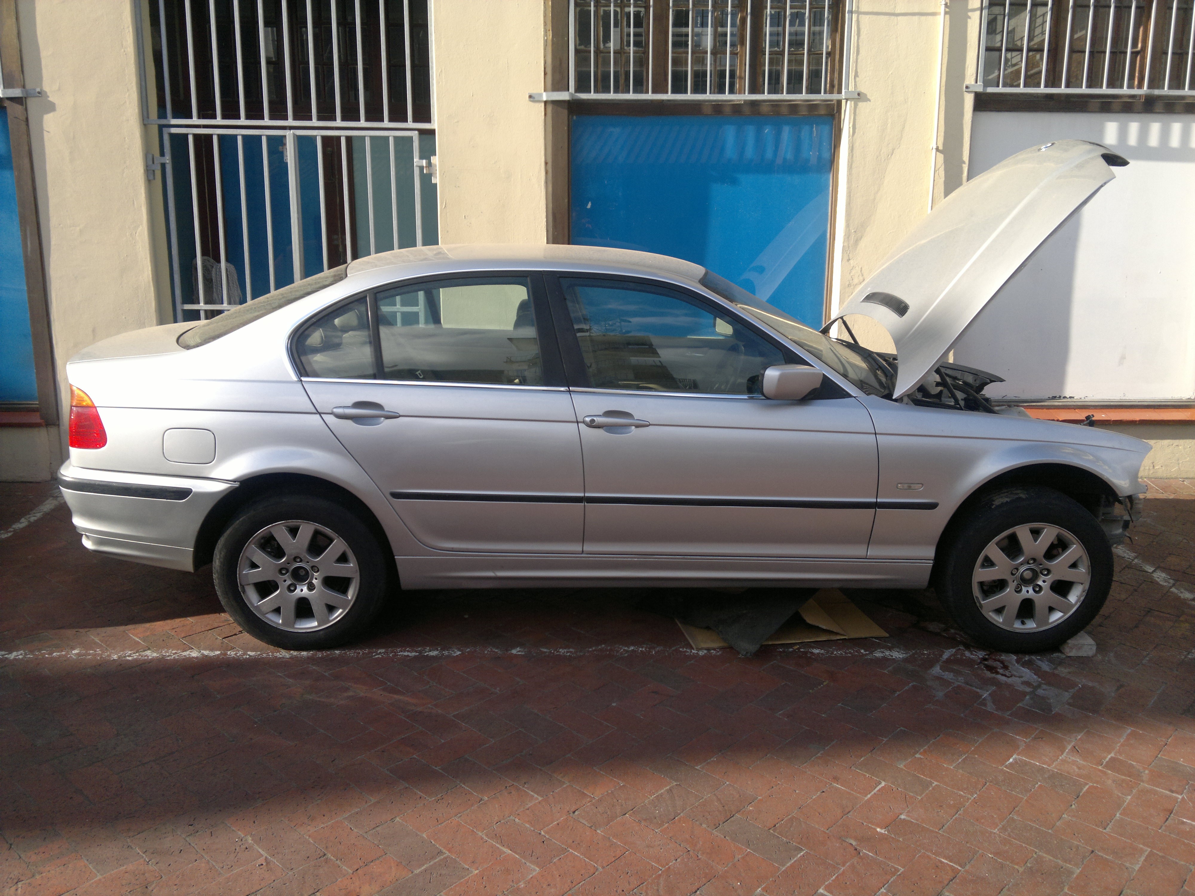

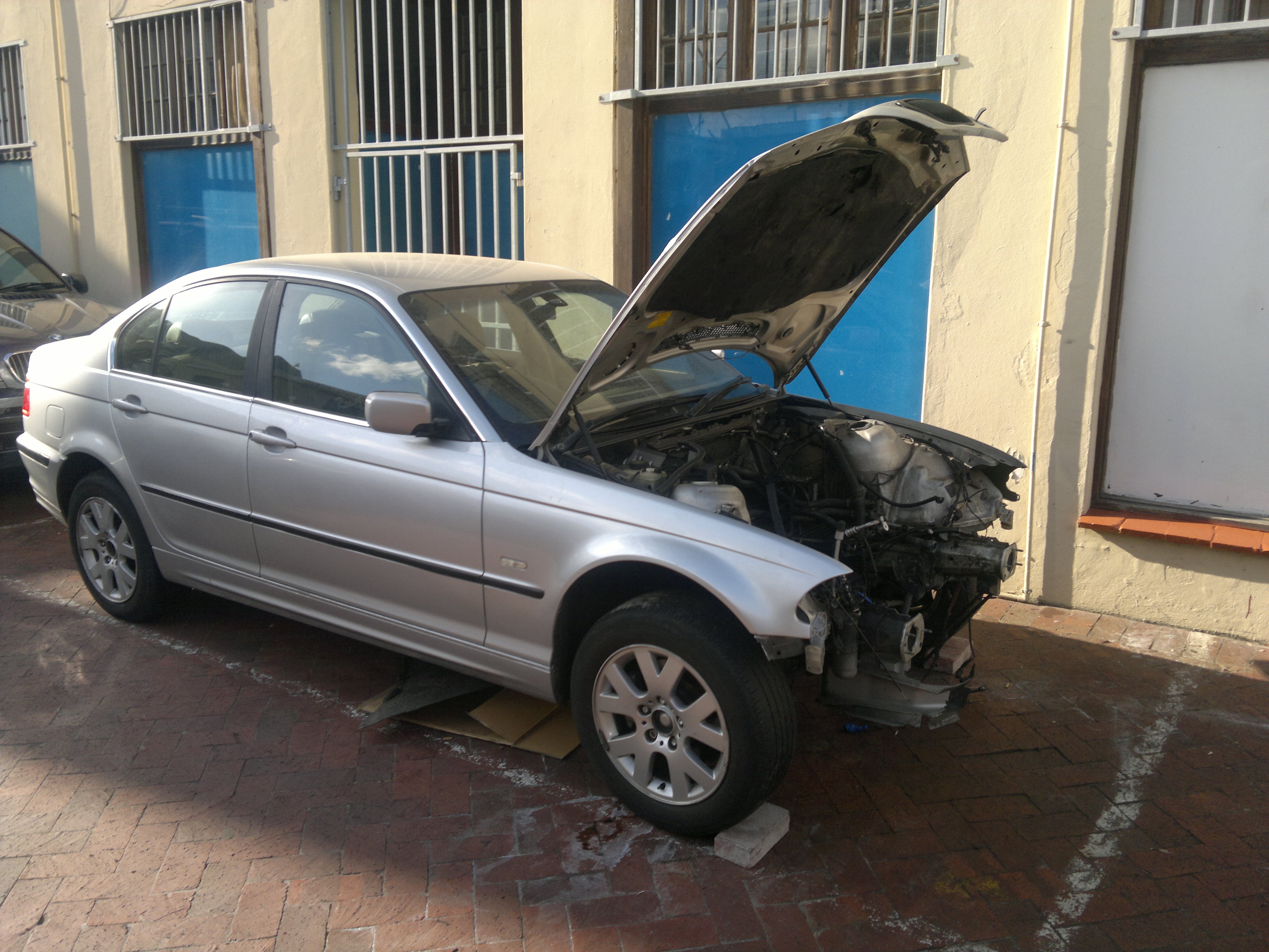

steveafster
This is what it looks like now!
