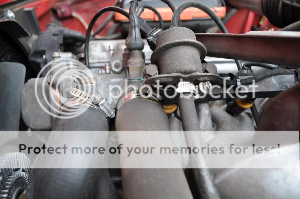

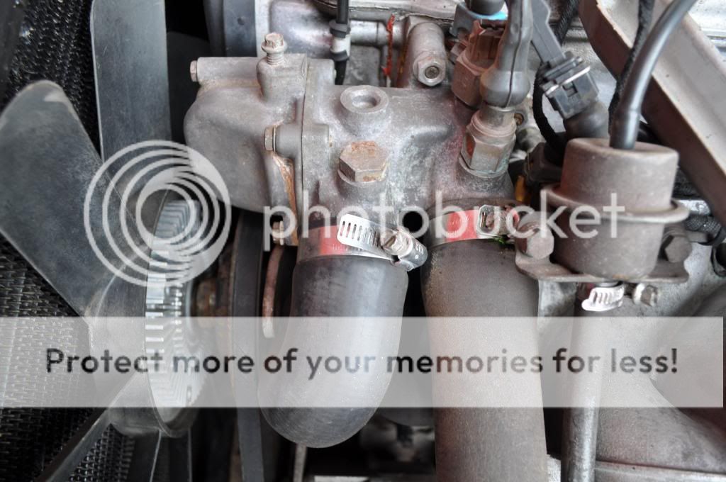

Using general purpose clamps leads to torn rubber hoses.
I think that with the exception of 6 small clamps all the others are general purpose clamps which will be replaced.

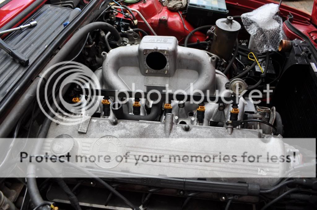

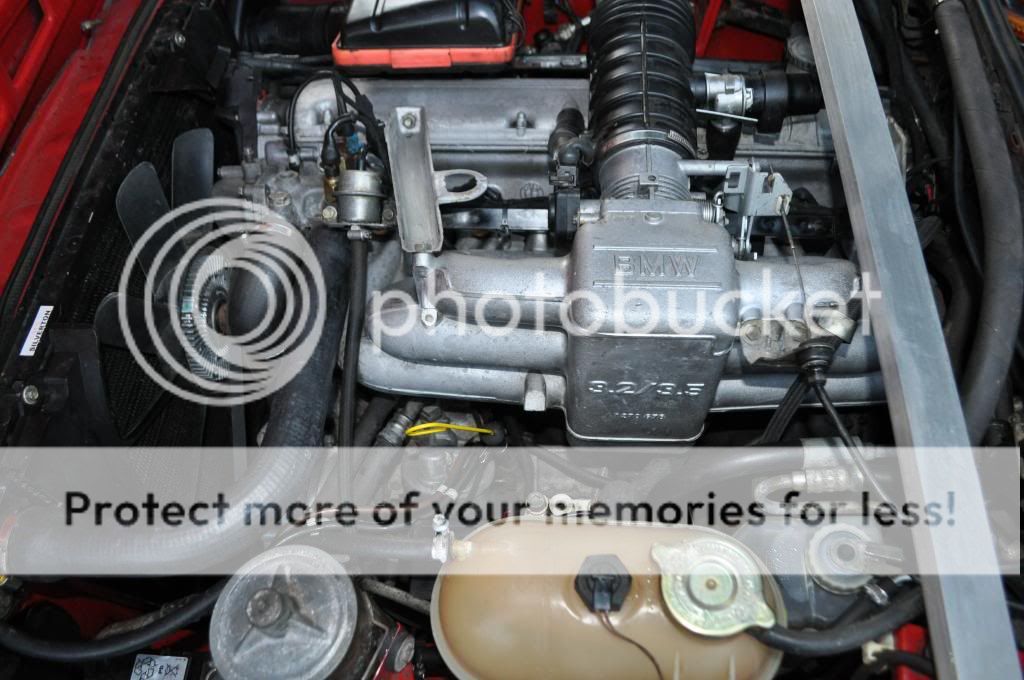

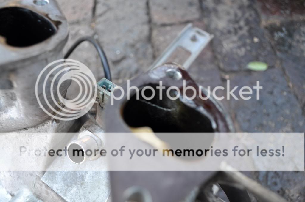

The infamous and dreaded red sealer
Leaks in the inlet manifold area.

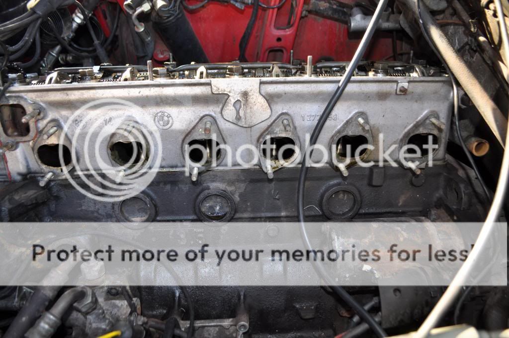

No4 inlet port cracked.
Fist 3 sets of nuts where easy peasy to remove and on the last 3 I have invented new words.
One needs to be an octopus to get to the nuts.
Head still clean after it had a major rebuild in the UK.

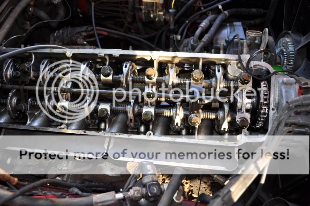

Valve clearances will be done in the am along with new plugs oil and the like
For those shark owners who are contemplating doing an inlet manifold job I would highly recommend that only original gaskets are used as the aftermarket sell a thinner gasket which does not seal effectively which in turn leads to air leaks.
Equally the nuts on the inlet manifold will only accept a 12 spanner so guys be mindfull that if you need a 13 spanner your car has the wrong sized nut.

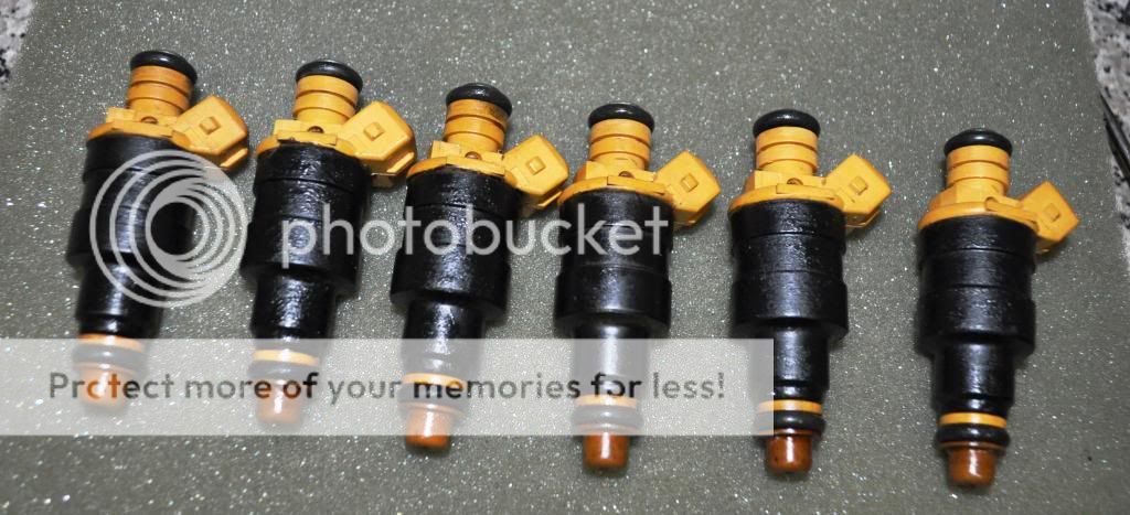

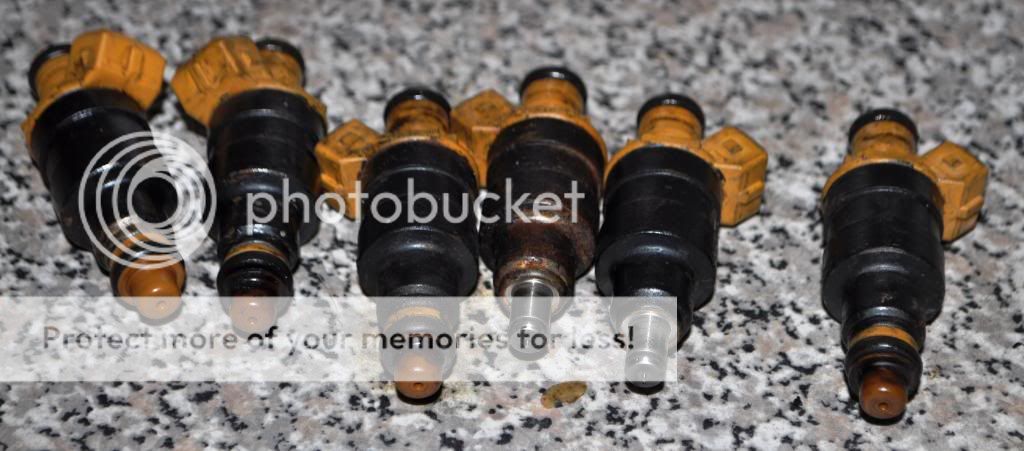

Injectors serviced.
No6 had a leak on the manifold probably from incorrect fitment/

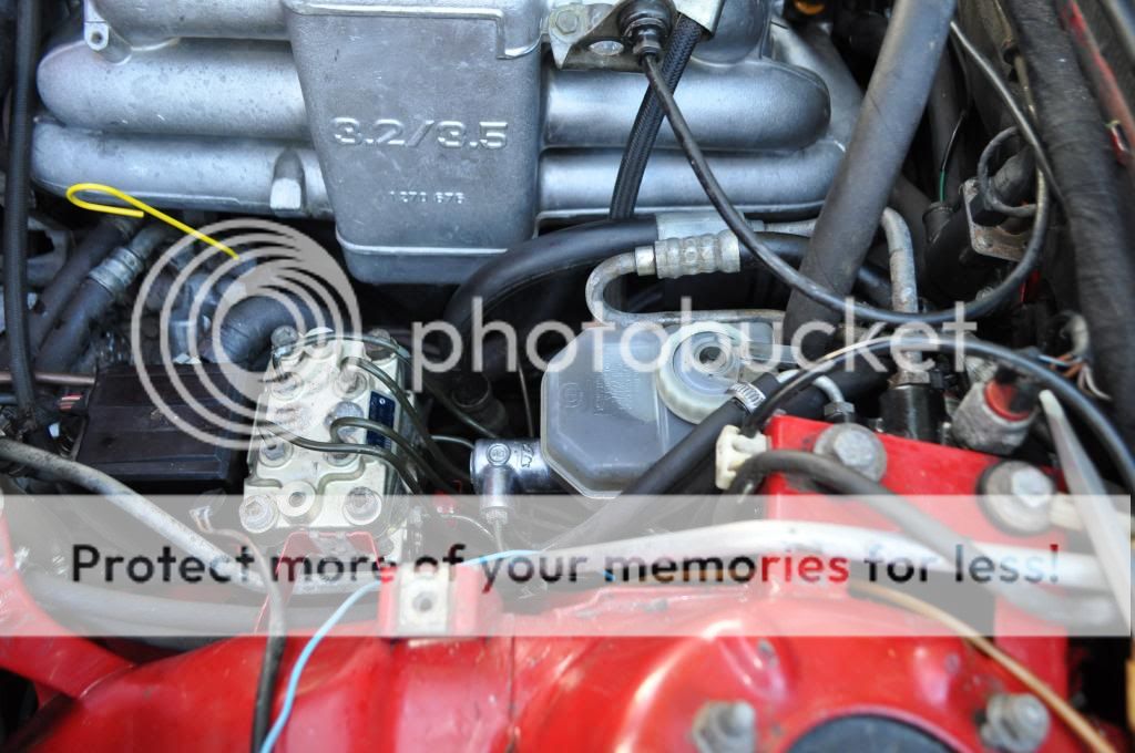

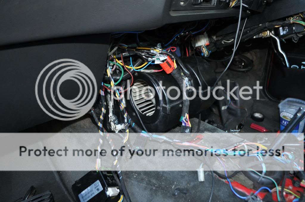

Aircon and heater seem to be confused after the aircon was redone.
In our search fr the problem we happened upon an explosion of wires.
It will be neatened up when we close the car.

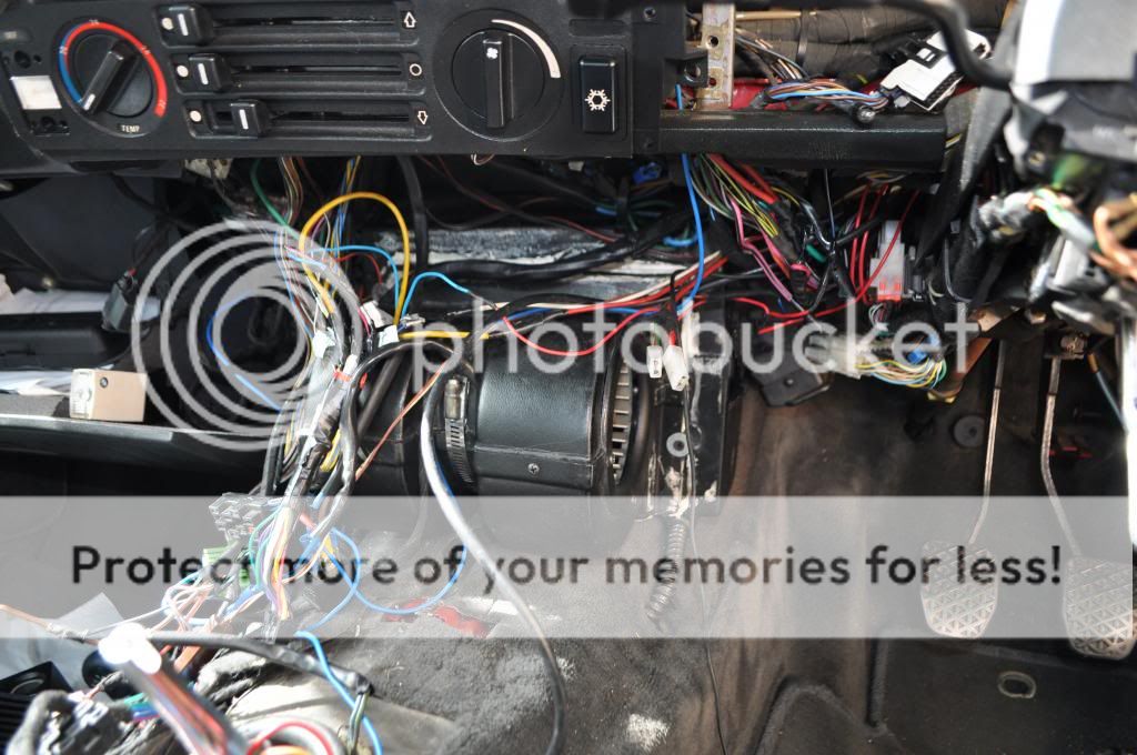

So today I tried to decode the "wiring codex of 1 000 wires" and am glad to report that I have duly succeeded.
I do not know who was let loose with Wurth fiber tape in the car but by gosh they sure wound everything they could with it and badly too.
If you ever need to wrap old style wiring there is a method to be applied and the best way, is to observe how the factory specified it and replicate the wind.
Wraping it solid makes the harness stiff and inflexible.
Equally the wires need to be cleaned with a cloth coated in thinners or any other solvent (benzine) so that the dirt is wiped off and the tape adheres better.
I shall be posting pics later.

Hate those clamps myself, Wurth or Ram quality clamps. They have raised sides that dont eat into the hoses and a smooth slide lip that makes sure the hose is tightened equally all- around. When I go scrapyards I try collect genuine BMW clamps off the old cars.

Wiring cleaned up.
Harnesses re created and hung in the correct place.
The balance are OBC, Cigarette lighter, speaker balance and alarm relay.

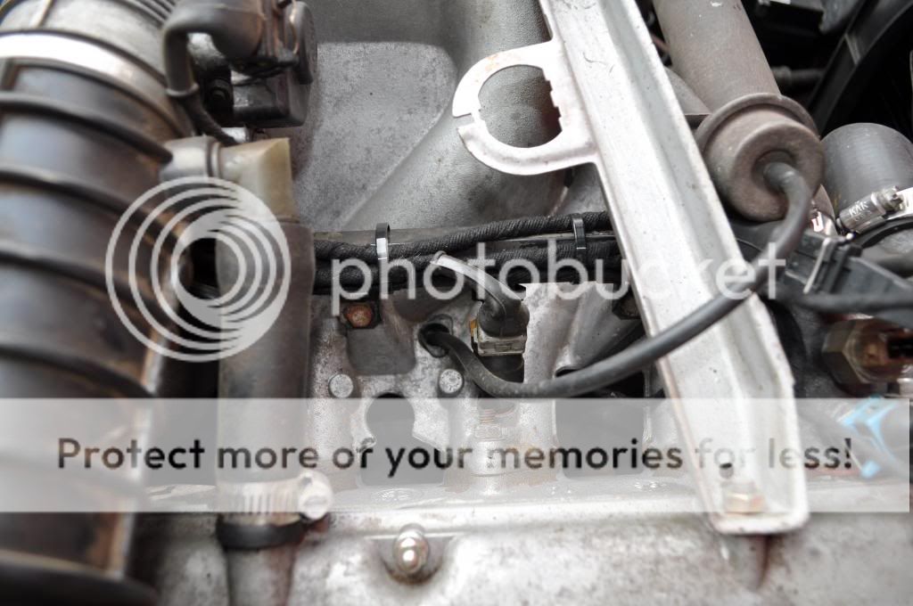

KZN manifold fitted.
Re routed some of the hoses and other stuff.
This is a view with the water bottle removed.
Generally the car has all its clips brackets etc and all it required was a bit of tidying up.
The aluminium pipe between the airfilter box and the inlet manifold rubber is a bit to short as when the measurements were originally taken the airfilter was missing the rubber foot it rests on and who ever did the conversion did not bother to add a piece of rubber to raise the airfilter to its correct level.

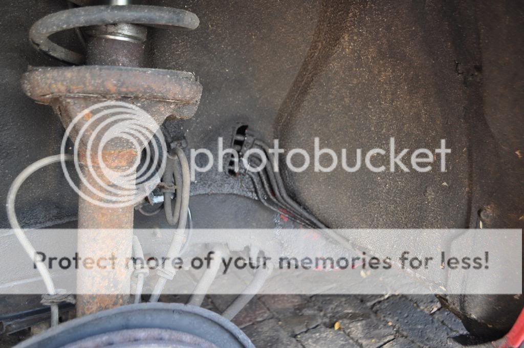

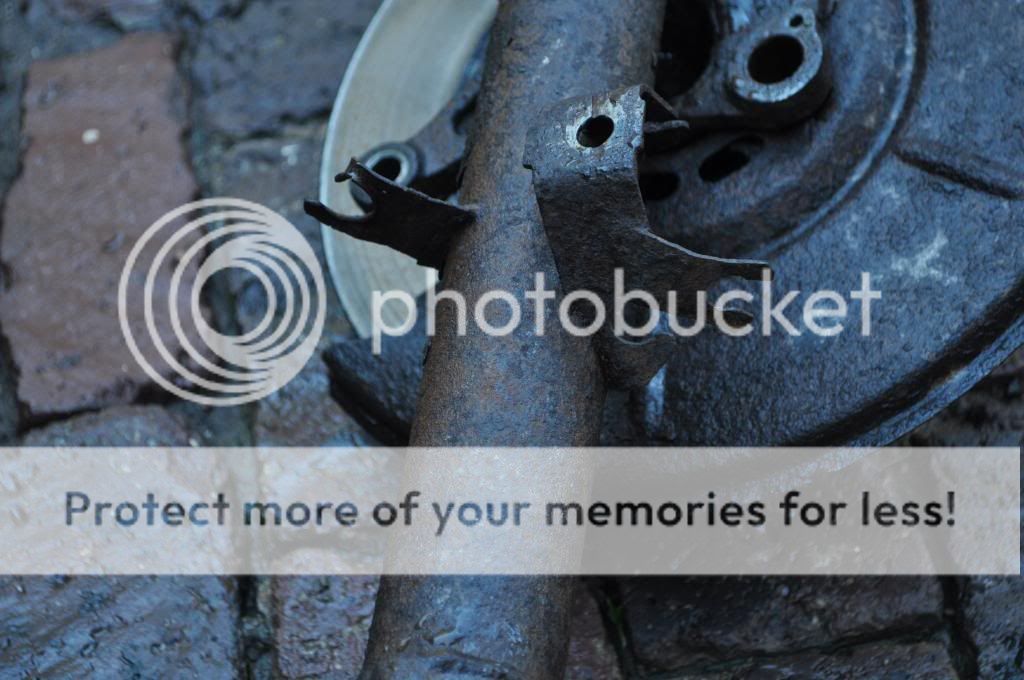

This is an English car and I now have a deeper appreciation as to why the English boards have posts about rust blaster,heating bolts and soaking bolts prior to loosening them.
The salt that they use on their roads really attacks the metal and corrodes it solid.
I will have to change every single nut and bolt on the suspension.
The brake disc backing plates are wafer thin after having been exposed to numerous salt baths.
The struts are dimpled from rust.

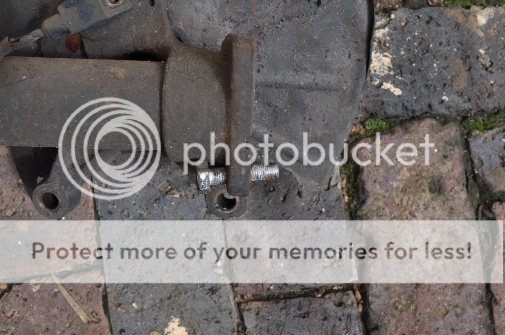

Rick wants poly bushes fitted on the new suspension arms so I will check all welds on the car mounting points and will reinforce any that look suspect.
A slight modification made in SA I suspect.
The strut is held onto the lower suspension by 3 bolts which thread into the bottom of the strut.
Clearly the threads must have stripped and the strut was drilled to accept a longer bolt and nut.
