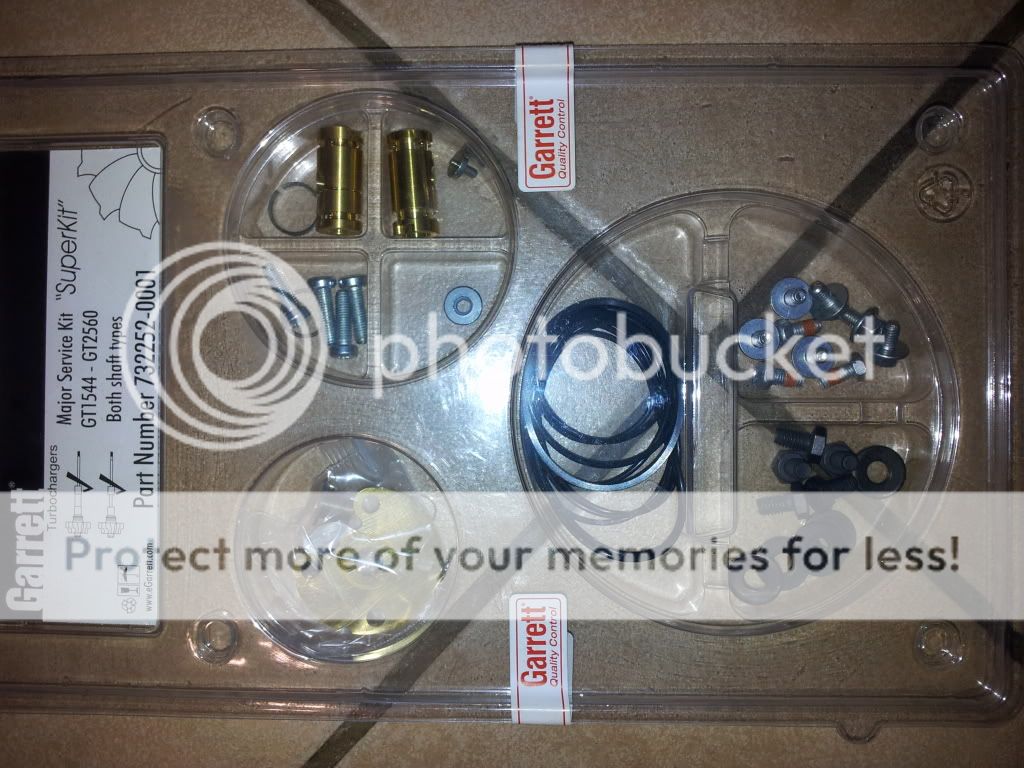

item one, a genuine garrett superkit, for the GT series turbo's, under which falls the vnt turbo's..

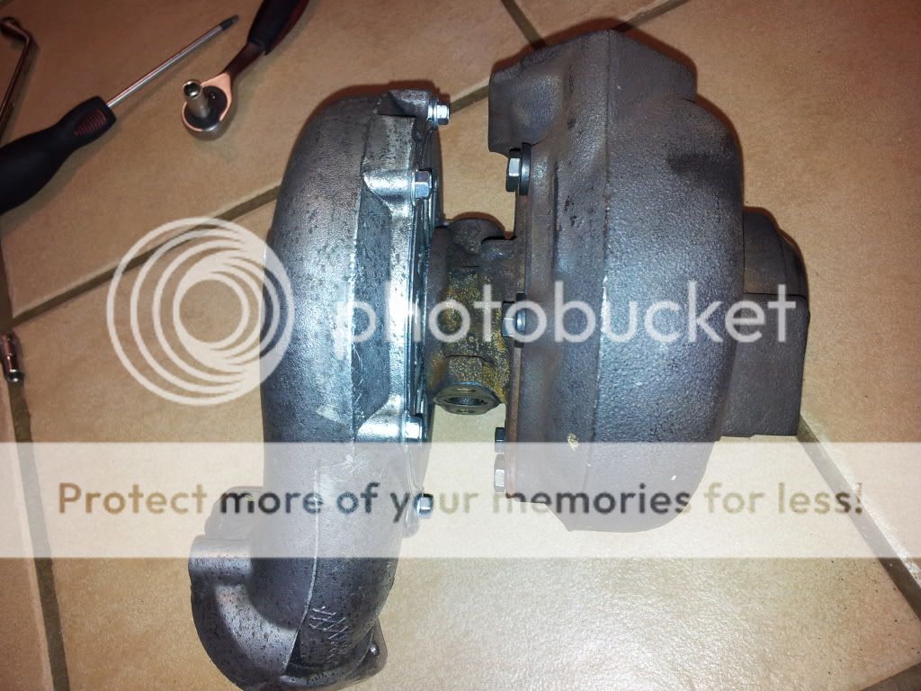

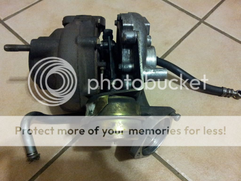

the turbo being stripped, a GT2260V from my e46 330d ..

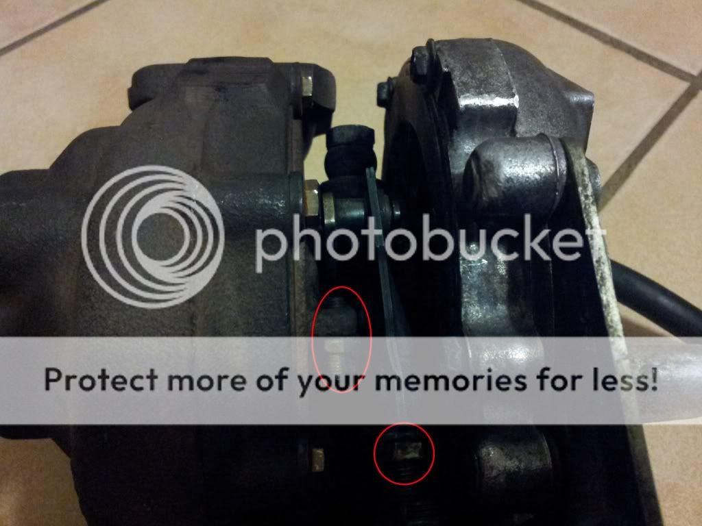

circled in red, the vnt adjustments.. NEVER ADJUST THESE!!

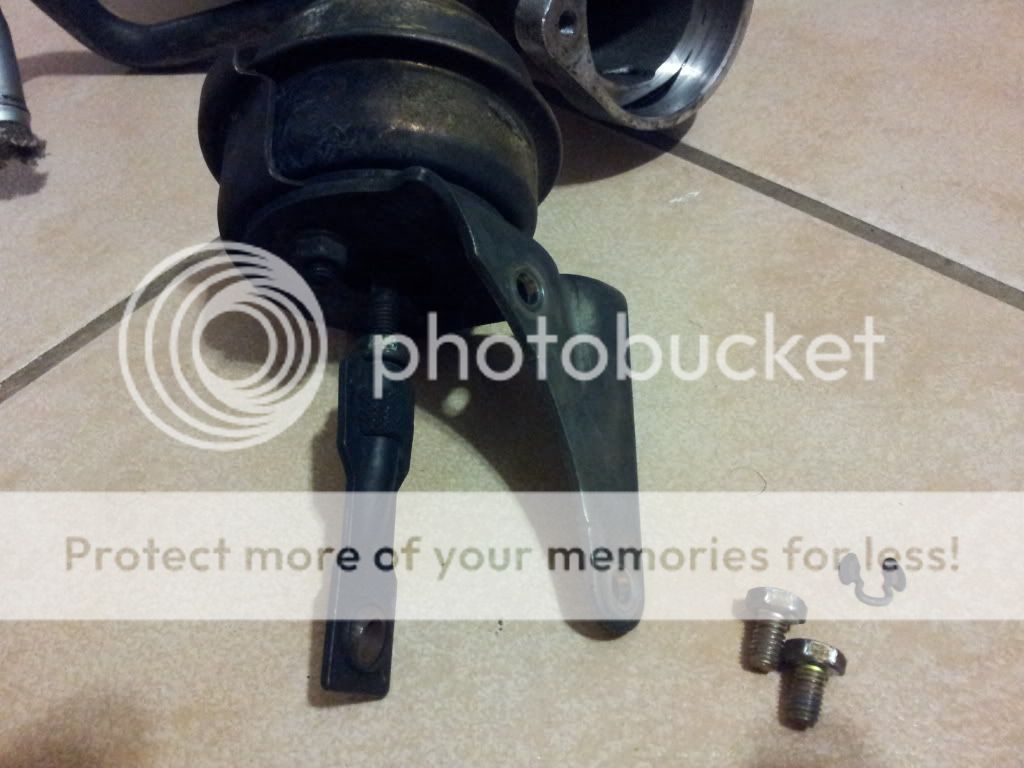

remove the circlip securing the actuator arm, and the two bolts holding the actuator to the housing..

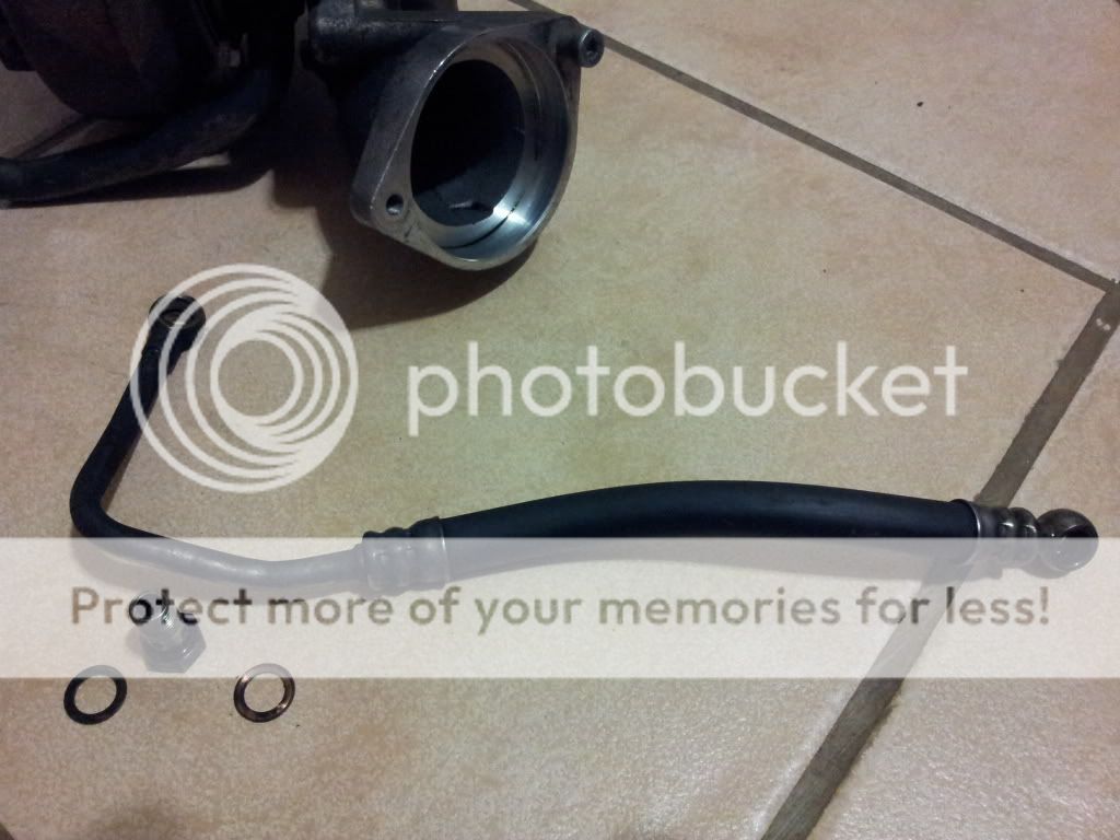

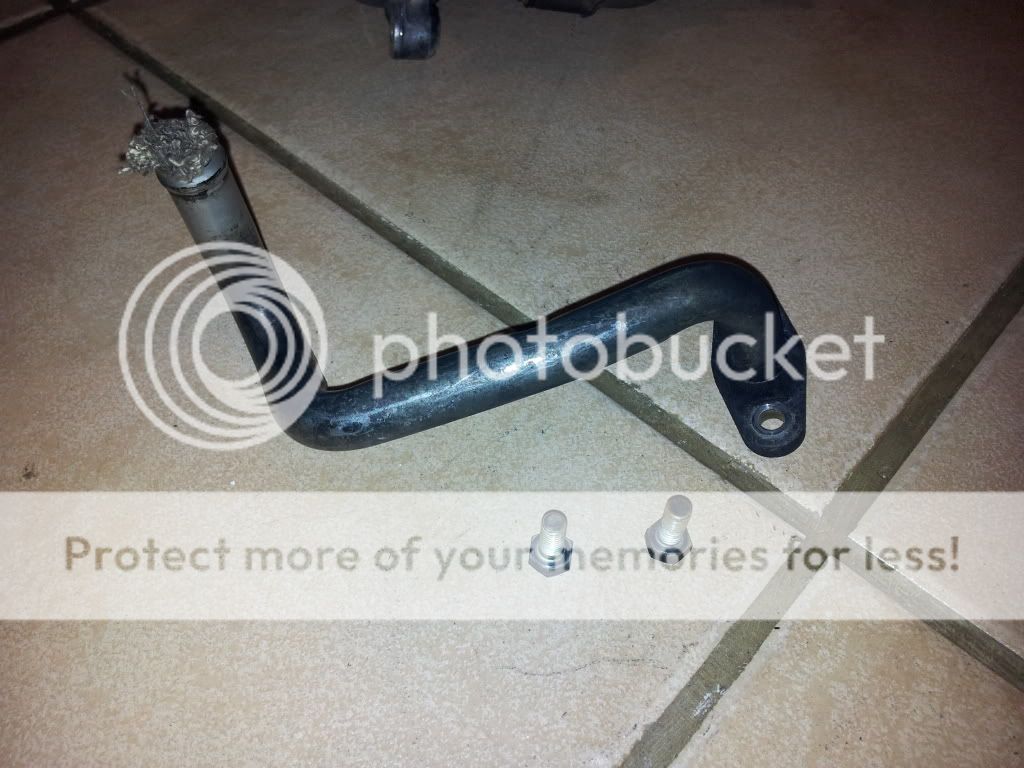

remove the turbo feed, note there is a copper washer on each side of the banjo fitting, dont lose these..
remove the oil drain to sump..

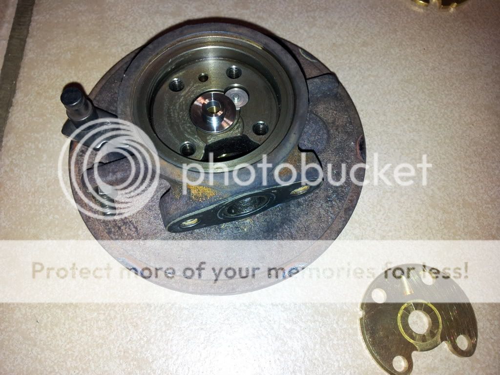

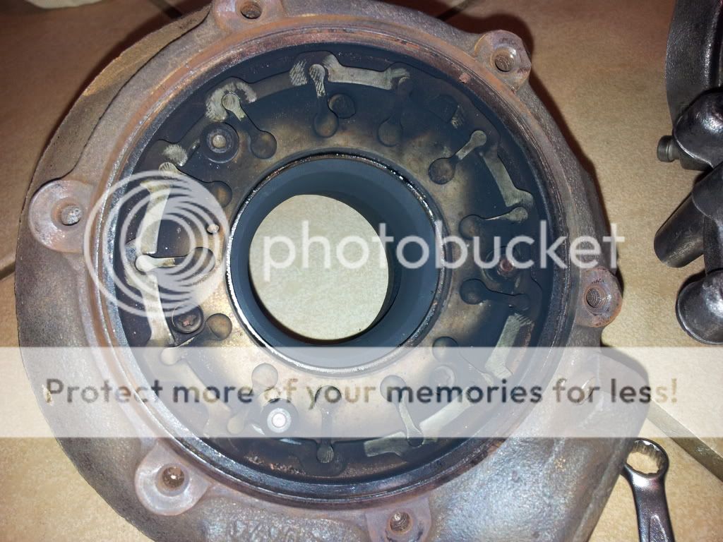

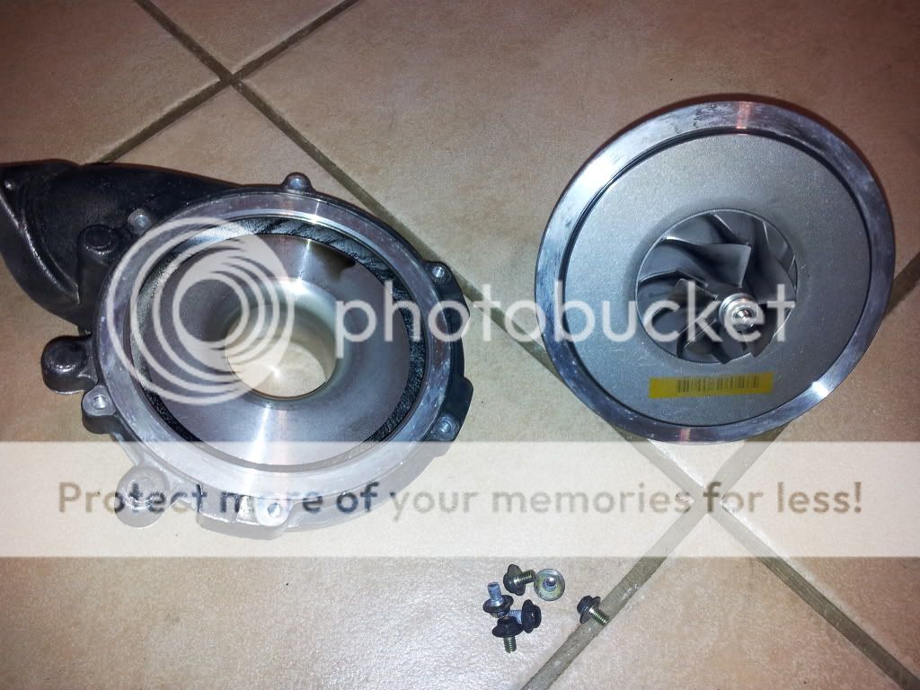

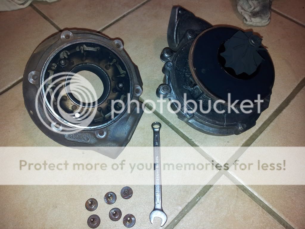

this should be what it looks like after the housing has been removed..
the vnt mechanism..

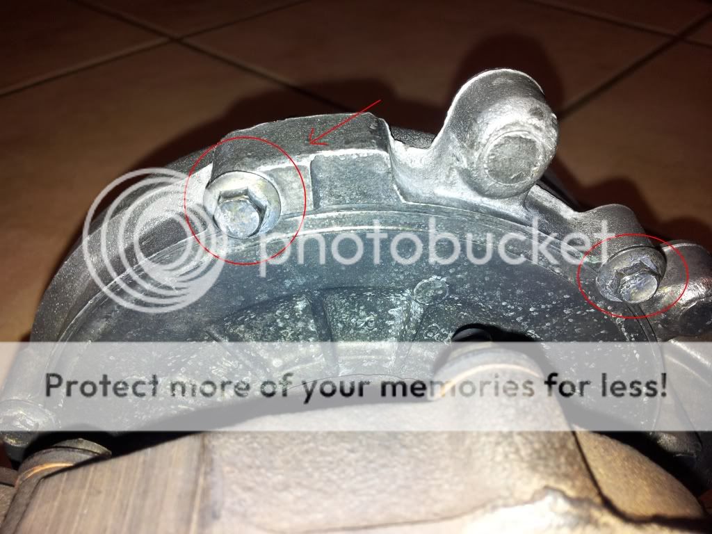

remove the circled bolts to remove the compressor housing..
compressor housing removed..

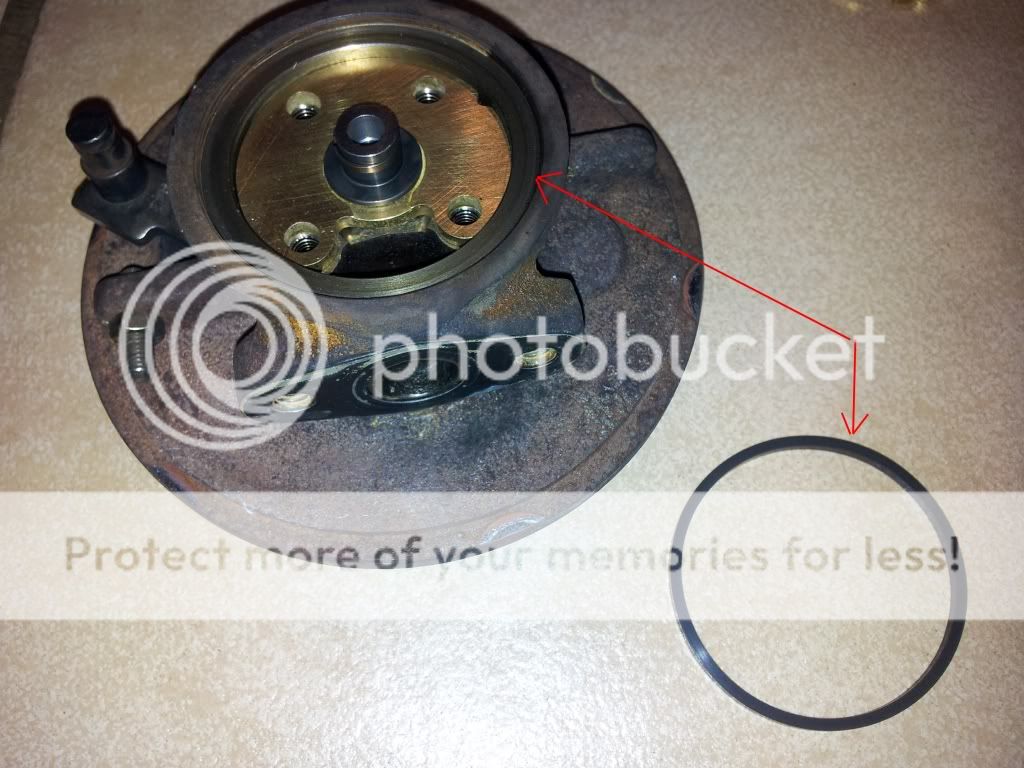

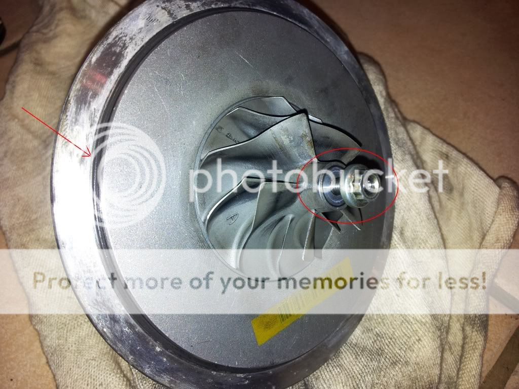

note the arrowed seal, replace this with the correct one from the kit.. remove the circled nut holding the compressor impeller to the shaft..holding the exhaust side nut with something suitable.. REMEMBER THIS NUT TURNS CLOCKWISE TO LOOSEN! also use a t handle with socket so as not to put strain on the shaft and possible bend it..

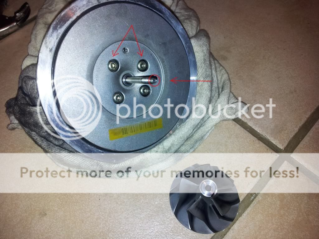

with the compressor removed, gently tap the shaft end to pop the exhaust seal and the complete shaft from the bearing housing.. remove the four circled bolts to remove the compressor backplate..

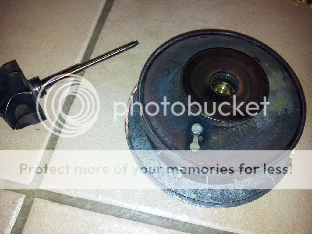

shaft out..

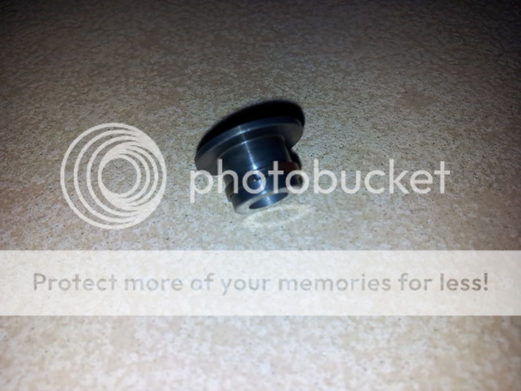

pop the thrust bearing from the housing, underneath you will see the bottom half of the thrust collar,
remove the collar and underneath you will find the bearing and its lock..

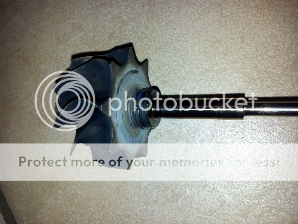

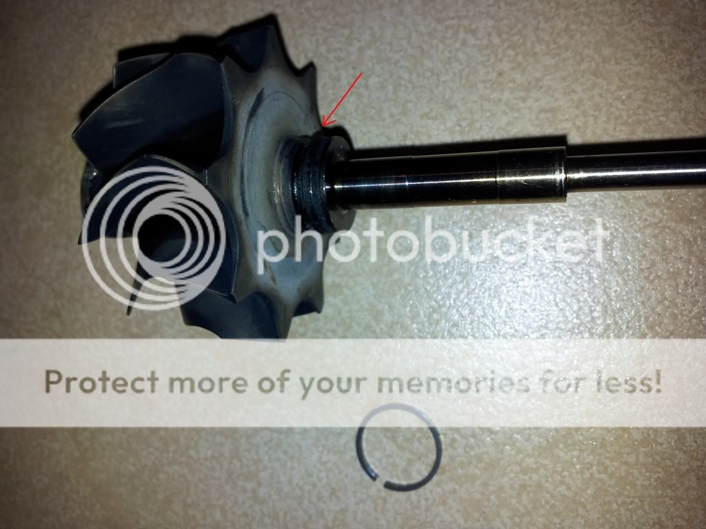

the exhaust wheel and shaft.. remove the seal arrowed, and replace with correct one from kit.. use fingers only to put the new seal on!!

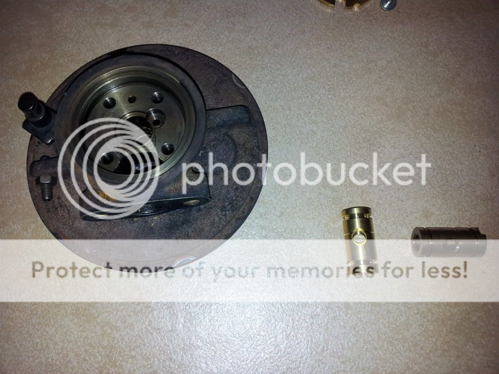

slide the correct bearing supplied into the housing, with a new lock, new bottom half of thrust collar, new thrust bearing, note thrust bearing oil feed to bottom, replace arrowed seal from kit..

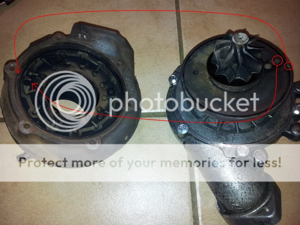

the tricky part.. fit the bearing housing to the exhaust housing.. taking GREAT care not to disturb the vnt ring.. the dowel circled has to fit its hole, while the actuator arm has to fit its hole.. make sure everything moves as it should afterwards!!!
	the vnt mechanism..

	shaft out..
