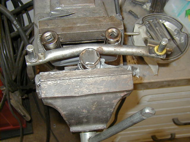

Next up was an MZ3 shifter. This shifter requires modification to have the shifter sit centered since the shifter isn't bent like the stock or 545i shifter.

There is once issue I encounted. The bottom of the shifter is rubbing against my drive shaft shifting to 1st and 5th. I believe I need to bend my shift selector rod similar to what is shown below.
