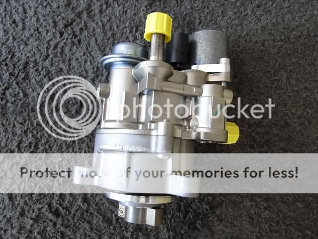

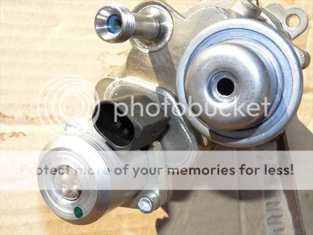

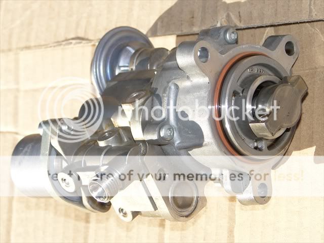

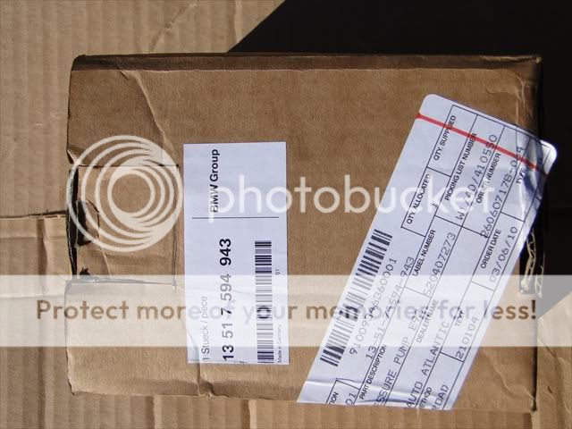

Pictures of the first version pump on the 2009 models:1351 7 592 881 HPFP

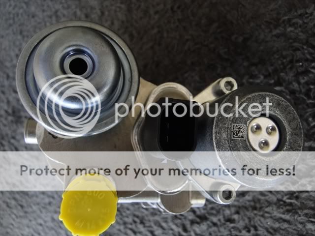

Then another revision on the 2009 models:1351 7 594 943 :hammerhead:

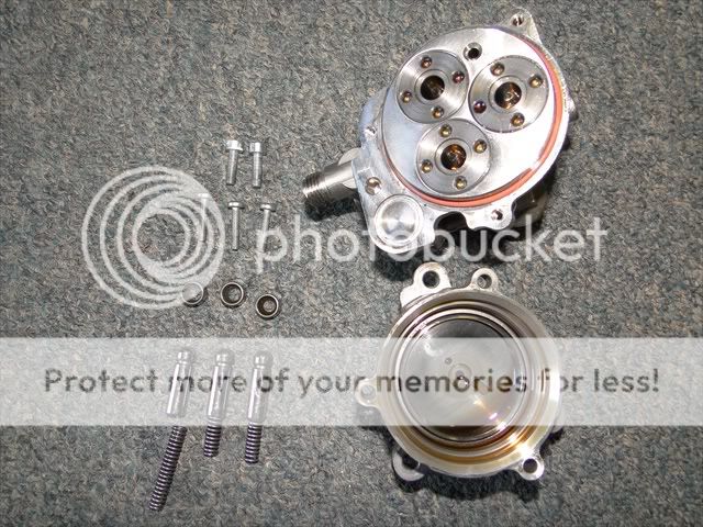

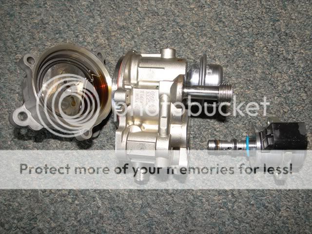

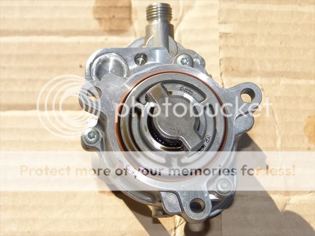

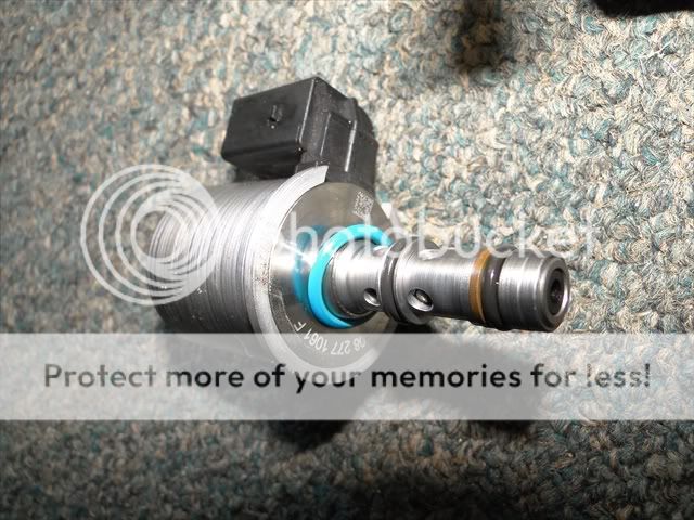

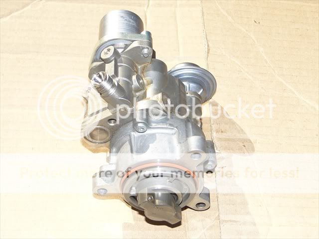

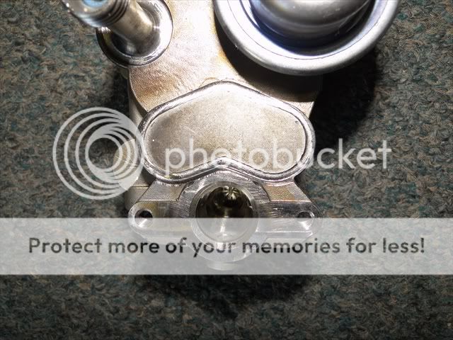

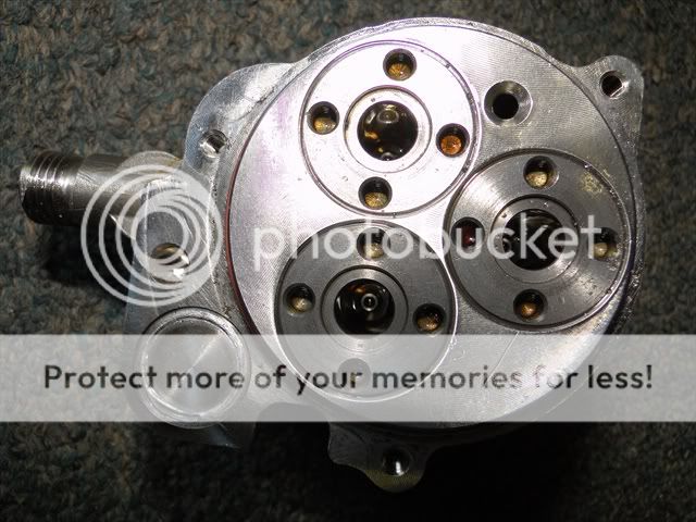

Here are some pics of the HPFP on the inside.

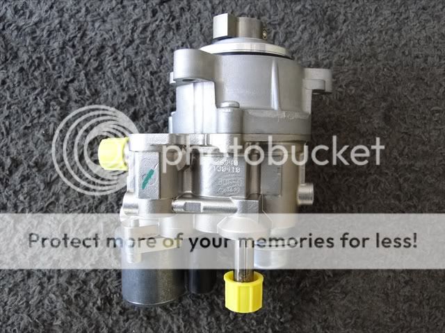

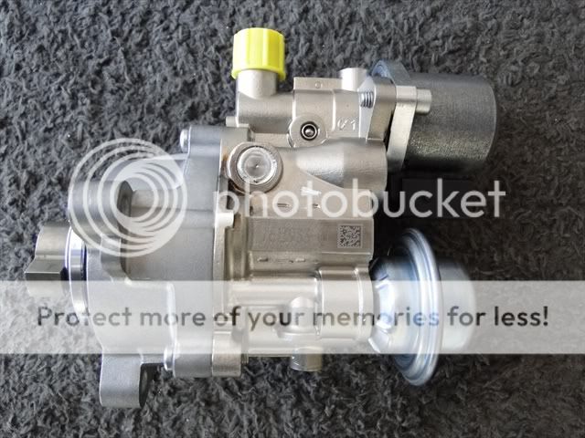

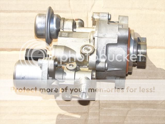

The latest version: 1351 7 613 933 :thumbsup:

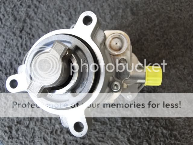

Here are two pics of the new pump installed:
