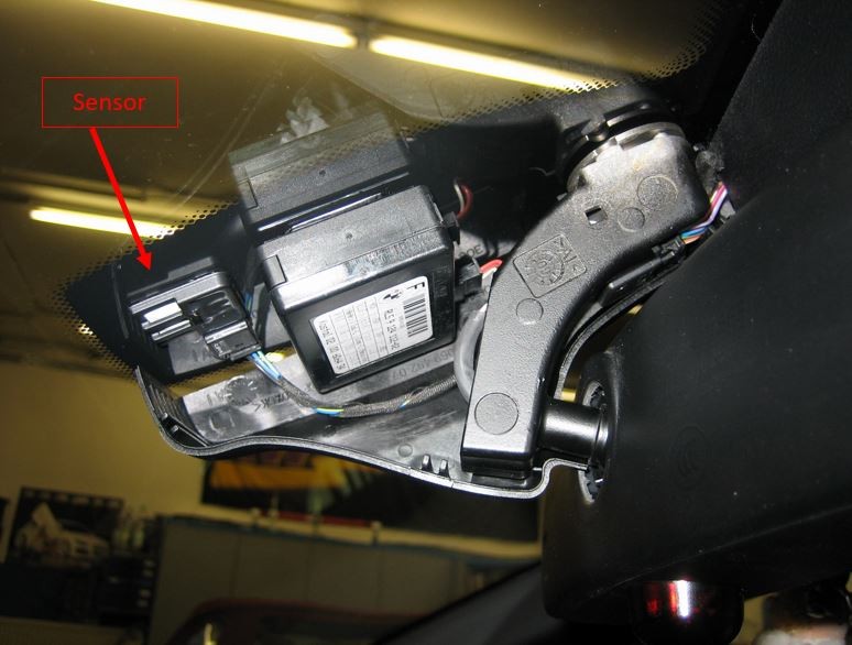

hi, they probably didnt stick the sensor in the correct place, open up the rear view mirror (just pops open) and check it out.
[Image: capture_5561191905.jpg]

Thanks, let me try that.
