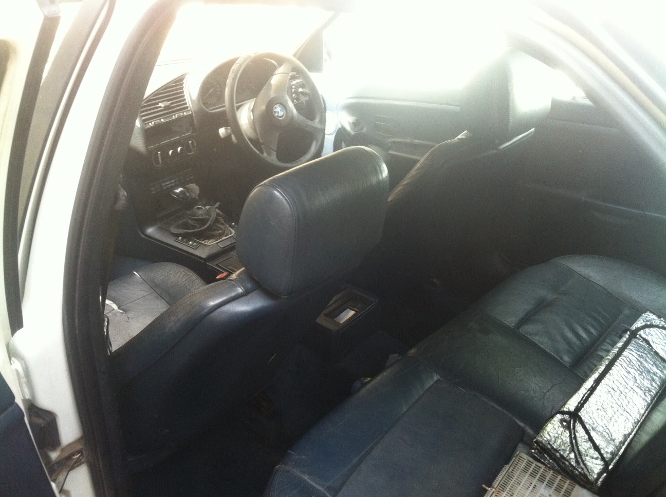

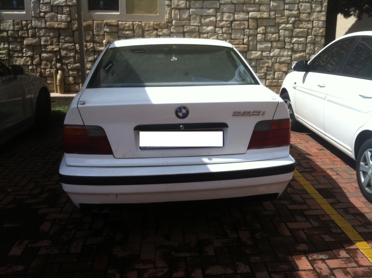

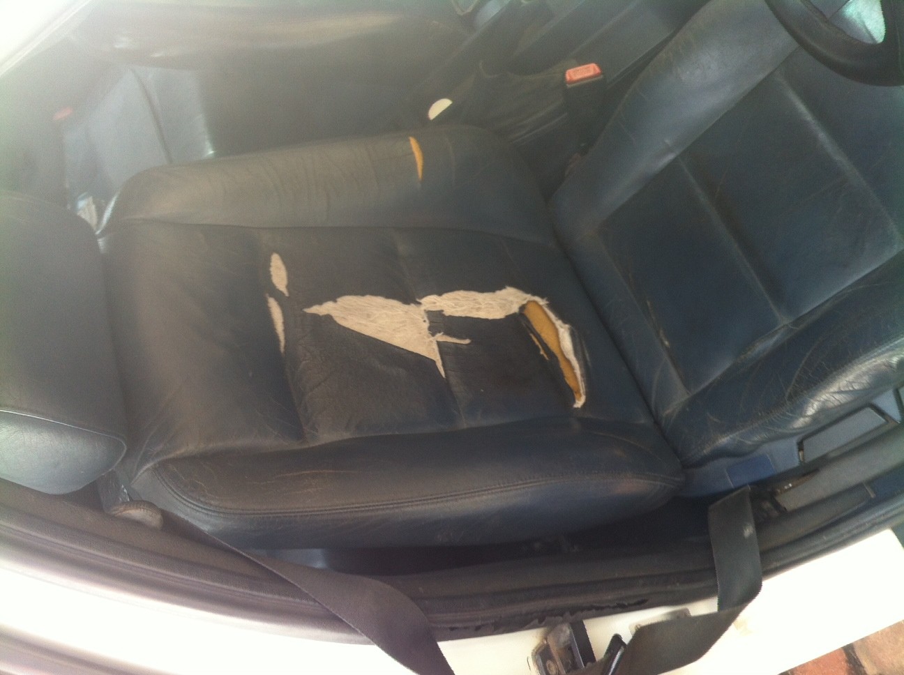

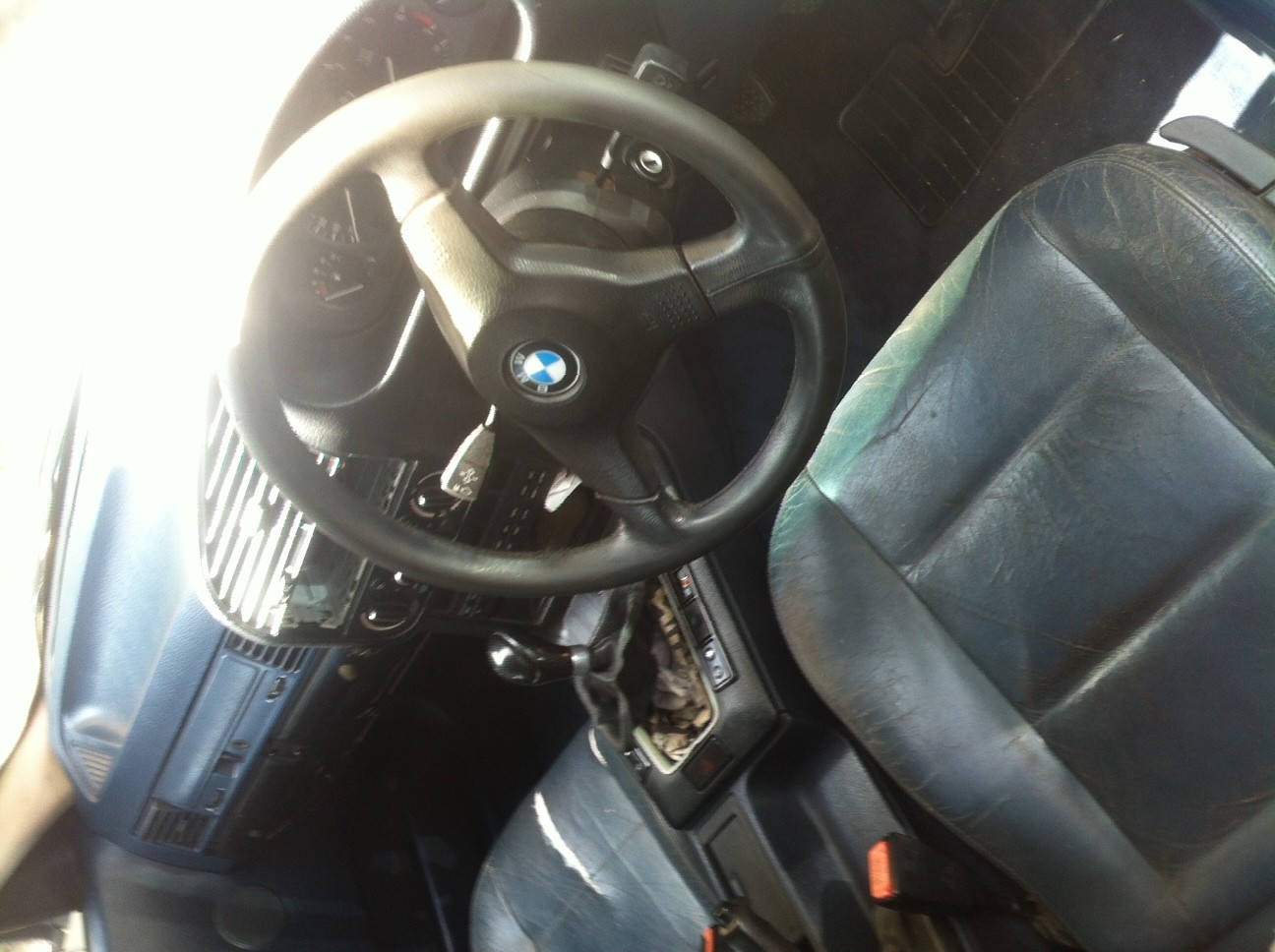

Hi ppl
So got the car that I have been looking for and got it for cheap
Its a 92 e36 325i non vanos
[Image: image_2896464047.jpeg]
[Image: image_1_653206384.jpeg]
[Image: image_2_8041748986.jpeg]
[Image: image_3_8535927827.jpeg]
[Image: image_4_112072573.jpeg]
I am still not really sure with which direction this car will go, I originally was looking for a drifter, but I might just like the street car feel

I also want to try drop some weight on this fatty will keep the updates coming
sorry for the shitty pics

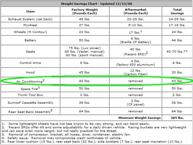

After these small little issues have been resolved I want to start with the weight saving
I will already be saving quite a bit with the above exhaust system and I want to do some weight saving.
Found this info which I am still deciding what to remove
[Image: bmwe36weight2_379501259.jpg]
Unfortunately this car will not be worth restoring as it needs ALOT of cosmetic work, hence why I am creating a hoon missile

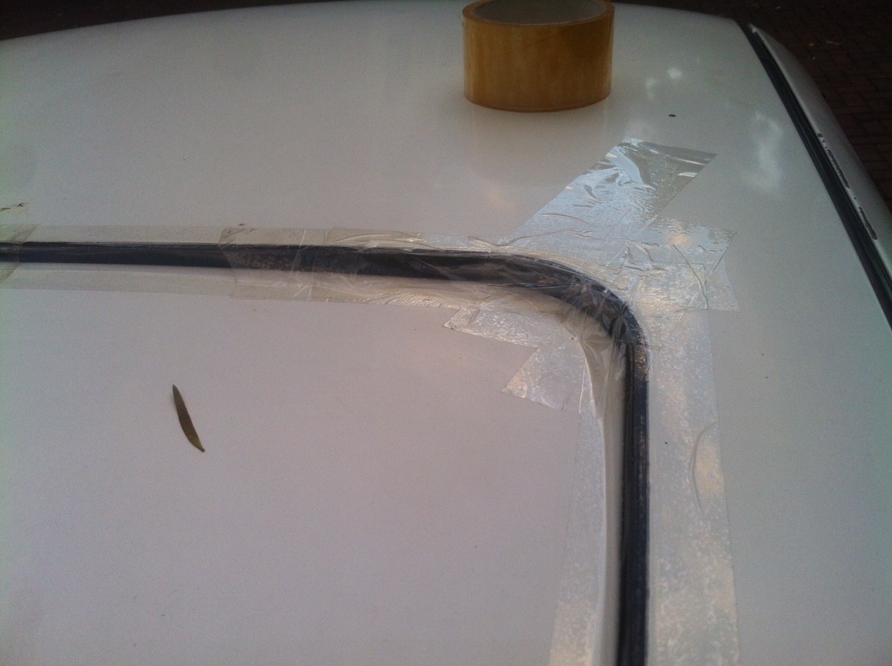

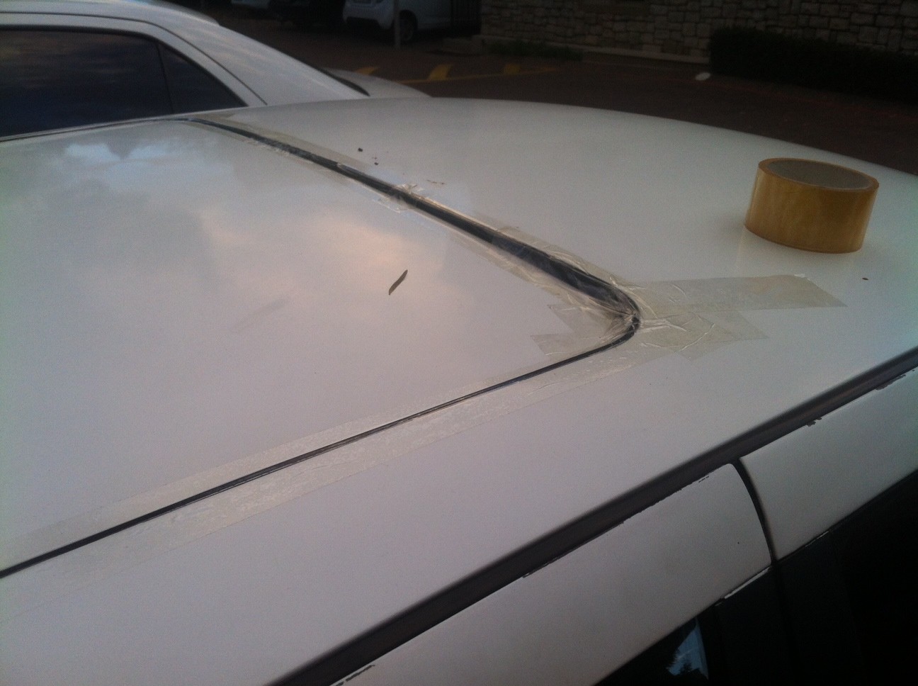

How to repair the sunroof
Here is a how on how to repair your sunroof
Step 1. Clean the area
Step 2. Stick it with box tape
Done Crazylaugh
[Image: image (1)_1132196509.jpeg]
[Image: image_8265275713.jpeg]
[Image: image (2)_628562779.jpeg]
I plan on doing a sunroof delete soon, so stay tuned

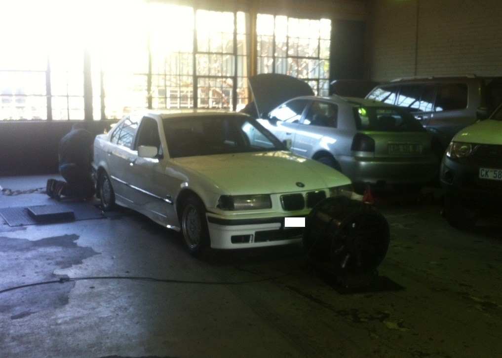

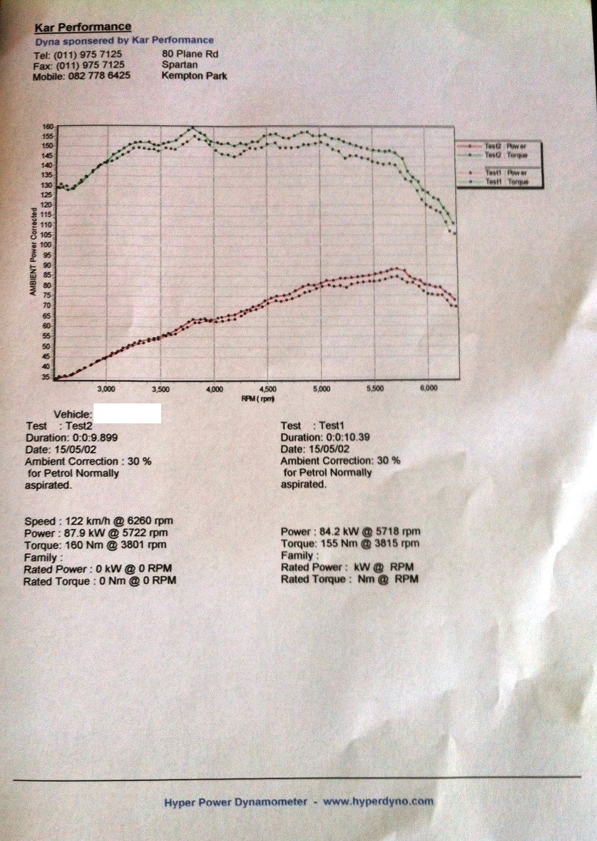

I know its a bit of a wreck but for what I want it for its perfect
Took it to the dyno today Bluebiggrin
[Image: image_1_203066905.jpeg]
[Image: image_8706716392.jpeg]
So the Numbers were
87.9wkw @ 5722rpm
160Nm @ 3801rpm
Not sure what what a Healthy 325i should be pushing but I am pretty happy with the output even with its leaky exhaust lol
This was at the KAR dyno in Kempton which is a bit stingy on numbers
If anyone could let me know what stock e36 325i's are pushing on the wheels that would be great

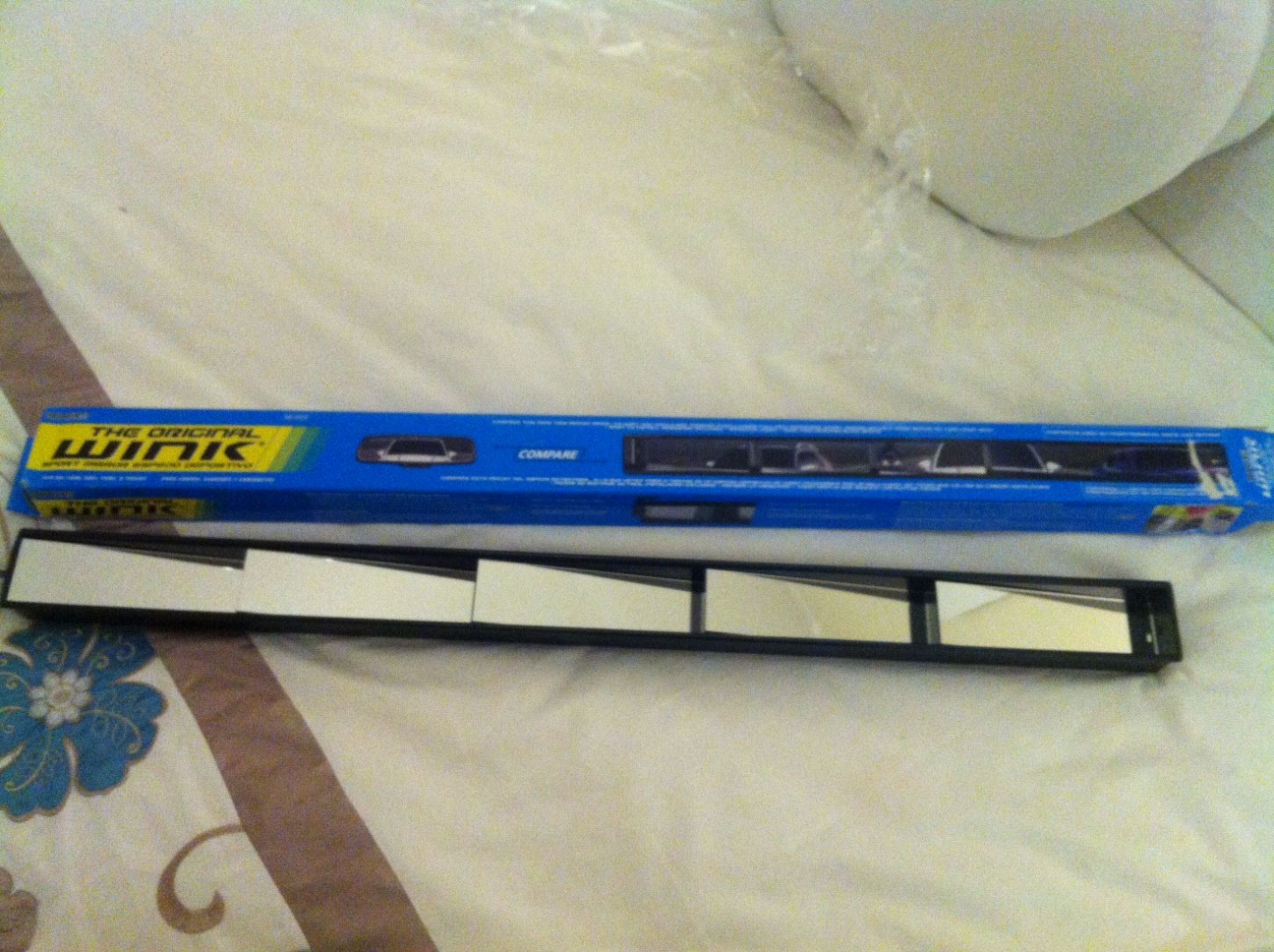

hmmm...
I surprised there is interest in this build here, I will post pics soon just too lazy but this arrived in the post today
I am currently busy with some interior work. When I am done I will post pics
but as promised here is my latest part
[Image: image_8267032578.jpeg]

Hey Captain,
Keep us posted on your build, we dont care what its used for....we like to see how other guys are building their cars, or well....at least I am interested.
Keep it up - then another question....what is the above part for? Silly question...I know.
