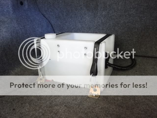

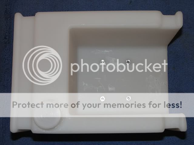

The solid transparent 1.5 galon tank:
[Image: DSC00916.jpg]

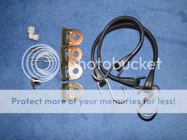

The clamps to hold the tank in place. It is very solid and strong indeed. The tank does not rattle or waver under hard accelleration or braking.
[Image: DSC00920.jpg]

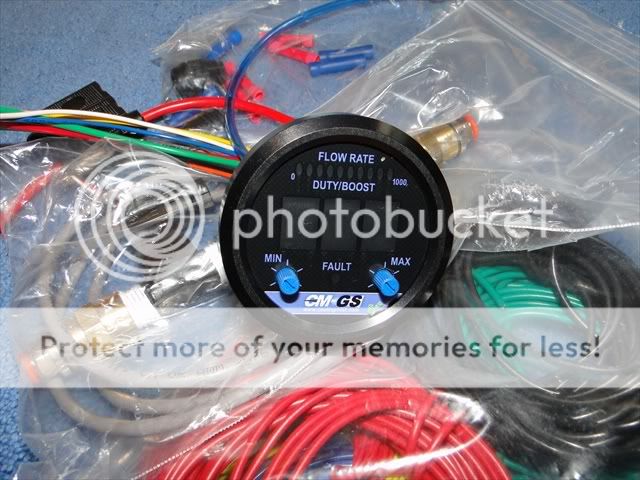

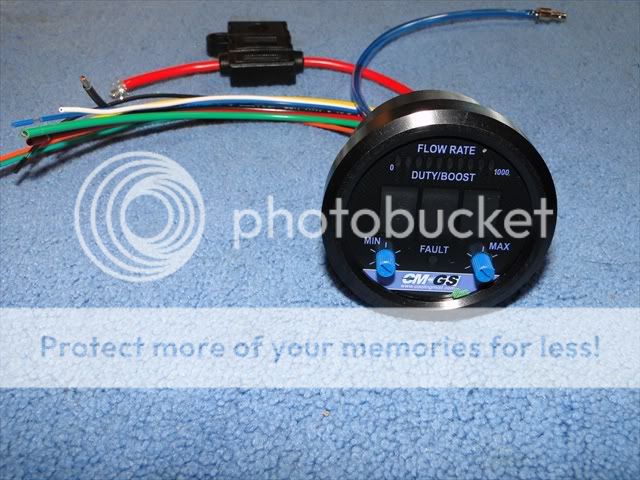

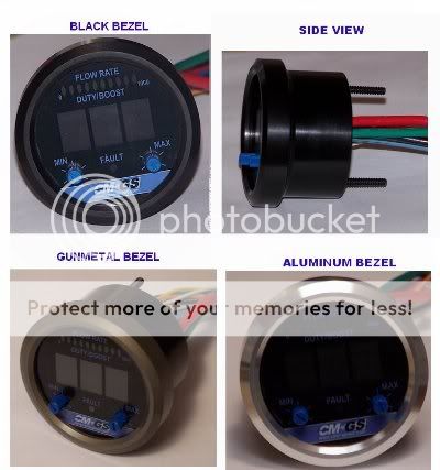

The amazing CMGS gauge below. It has a failsafe feature that gets triggered in case of a problem and basically shuts down the operation of the kit completely until you have resolved the problem...Thumbsup2. The failsafe can be set using boost, MAF or dutycycle as a threshold. The gauge "...features adjustable progressive spray, boost readings, and configurable display options. Add the flow sensor upgrade to any progressive controller to allow it to display flow and trigger the JB3 to raise boost ONLY when the methanol is properly flowing." In other words...the gauge measures meth flow and boost. You can set the gauge to set the minimum and maximum meth flow at the psi you choose and when it should stop flowing....this is just great!!! Further more the gauge can be calibrated to work in conjuction with the JB3 maps as well. Thumbsup2
[Image: DSC00927.jpg]
[Image: DSC00930.jpg]
[Image: DSC00935.jpg]

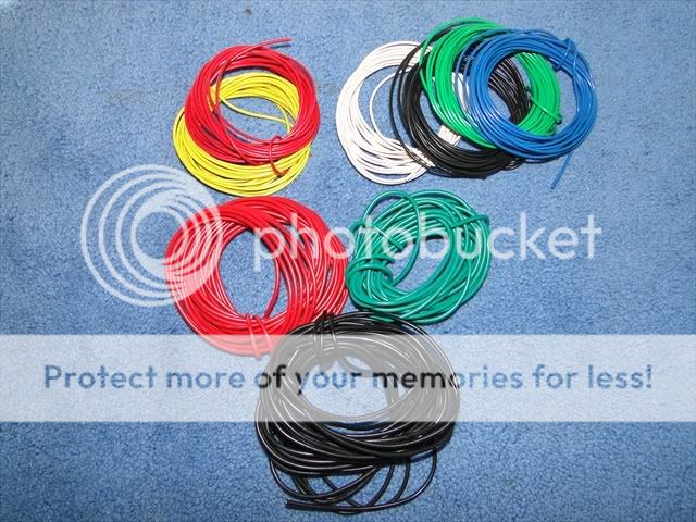

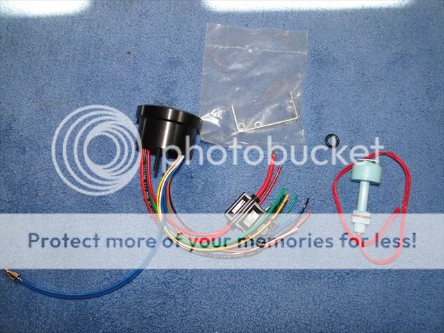

A whole lot of wiring for the gauge and pump. When this is installed neatly it seemlesly fits into the existing wiring of the car and looks like audio wiring:
[Image: DSC00944.jpg]

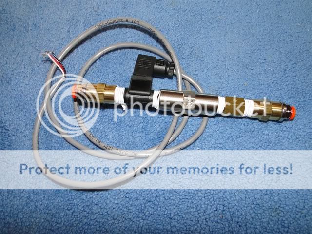

The flow sensor with its checkvalve and filter:

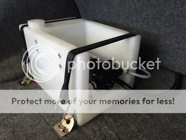

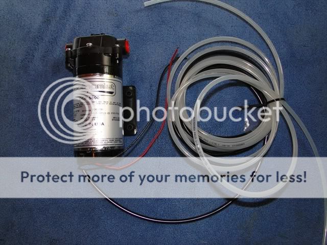

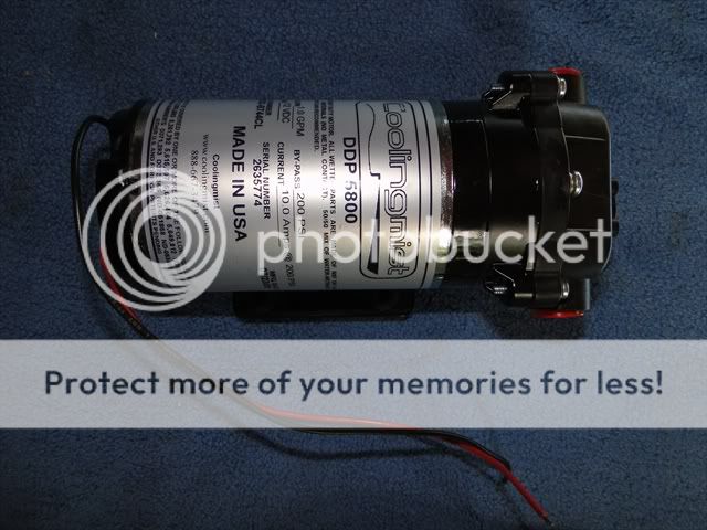

The high pressure pump is set at 200psi, but can be adjusted to 250psi:
[Image: DSC00948.jpg]
[Image: DSC00951.jpg]

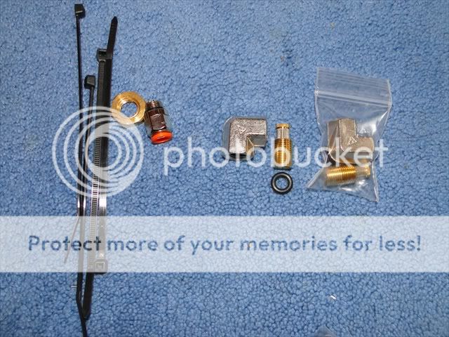

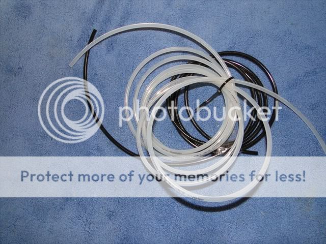

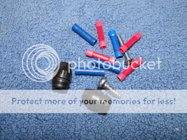

The connectors:
[Image: DSC00941.jpg]

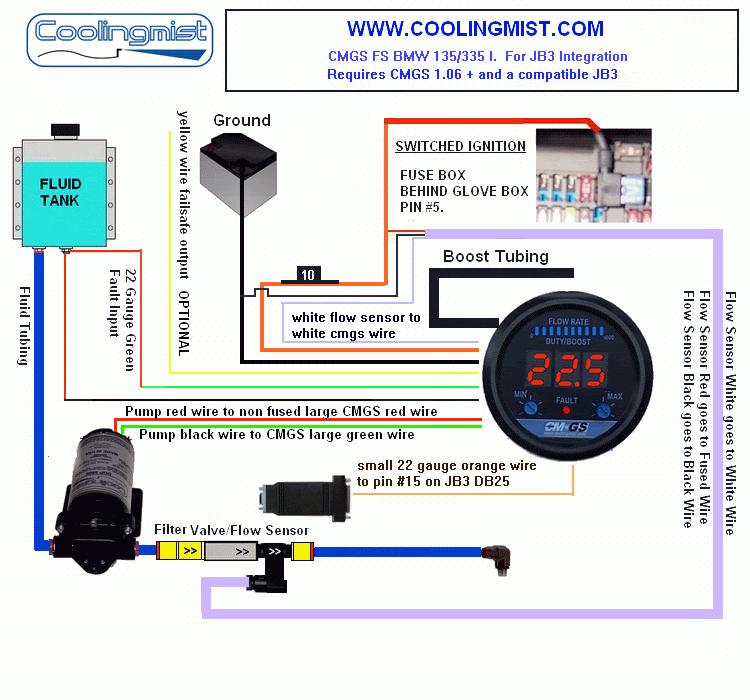

I followed the Coolingmist meth install instructions precisely, except for the CMGS gauge location. Here is a simplified diagramme:

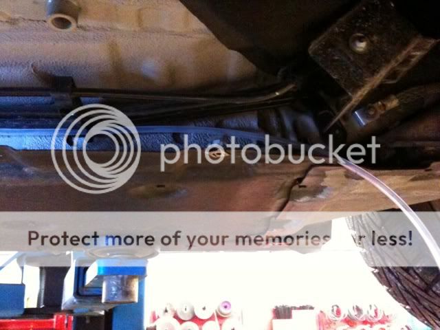

You can choose to run the wiring or meth piping underneath the car as some has done or you can run it safely inside the car underneath the carpeting. This pic shows it under the car. We have installed all on the inside and is much cleaner and stealthier.
[Image: IMG_0133.jpg]

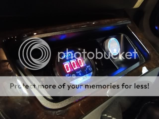

If you look closely we made an aluminium pod for the CMGS gauge and used the small bracket (underneath gauge) supplied by Coolingmist for secure and rattle free fitment of the gauge. The gauge is a marvel and very bright and readable, from the drivers and passenger distance, during the day and night. When not in use close the lid and only the devil will know. Failsafe on the gauge is enabled and it shows me a fault red light when the meth runs low and error codes when there are boost and meth flow problems. When you disconnect the meth line in the boot and the meth leaks out, the gauge will immediately flash showing up to four possible error messages/codes.
The gauge is also connected to the JB3 (one orange wire) but i am not sure what it all does other than reading boost from the JB3. Look forward to greater intergration with the JB, such as map switching in the future.

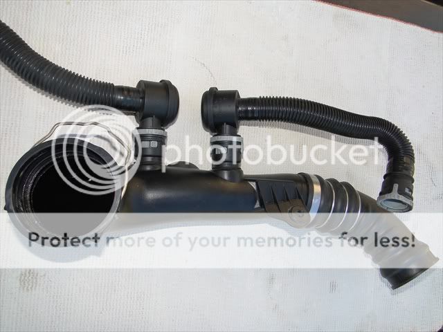

Now onto the second part of the installation. The parts required for this section have to be ordered seperately even though the stock OEM parts will also work fine. We found that the additional hardware round off the package better. The stock charge-pipe has to be replaced to make provision for the installation of the injectors and meth line/piping:
[Image: DSC01178.jpg]

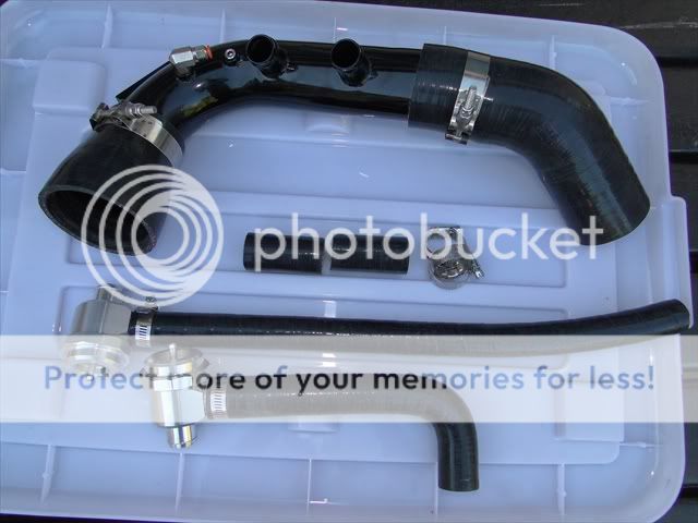

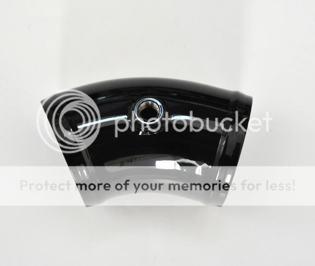

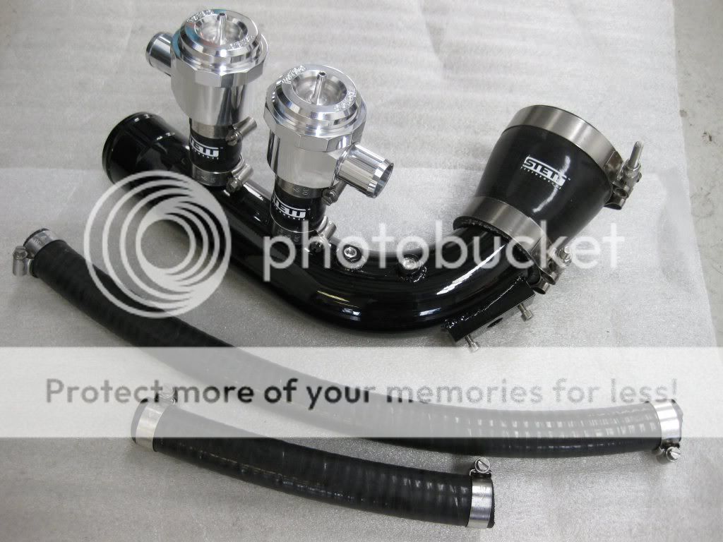

The better alternative is the charge-pipe from STETT to fit the meth injector and in the future NOS if you so desire. It also come with Forge diverter valves (http://www.stettperformance.com) to help cope with higher boost settings.
[Image: DSC01966.jpg]
[Image: charge20pipe200077.jpg]
Here you can see the places for the meth injector and future NOS Thumbsup2
[Image: STETTElbow5.jpg]

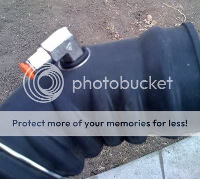

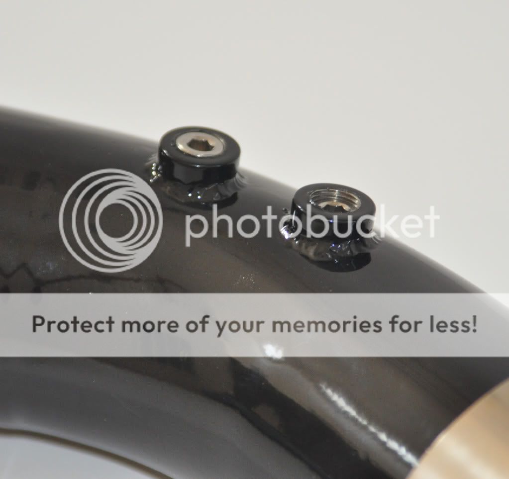

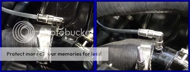

If you are brave enough you can just drill a hole into the stock charge-pipe and fit the injector into it like this. Needles to say we do not propose this:
[Image: meth_nozzle_2.jpg]

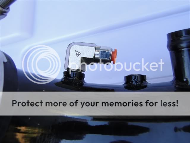

Or if you wish you can simply install an aftermarket elbow into the stock chargepipe...it does the same thing. No cutting is necessary into the stock charge-pipe, only a new clamp when you remove the permanent stock clamp:
[Image: STETTElbow4.jpg]

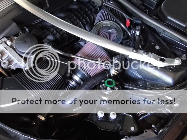

When the STETT chargepipe is installed (30minutes) with the meth injector and piping completed; it will look like this:
[Image: DSC01497.jpg]
The meth line going into the engine bay is inside a grey rubber sleeve except for about 5 - 10mm (see picture below) at the end as it goes into the injector...this gives it a "stock" look...The piping is very strong and is unlikely to brittle and break easily:
[Image: DSC01510edited.jpg]

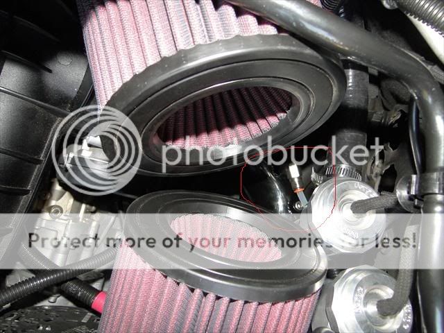

The STETT charge pipe for meth with the Forge DVs are a great mod and a must when running heavy boost. It was easy to install and perfect for meth and future upgrades (NOS?).

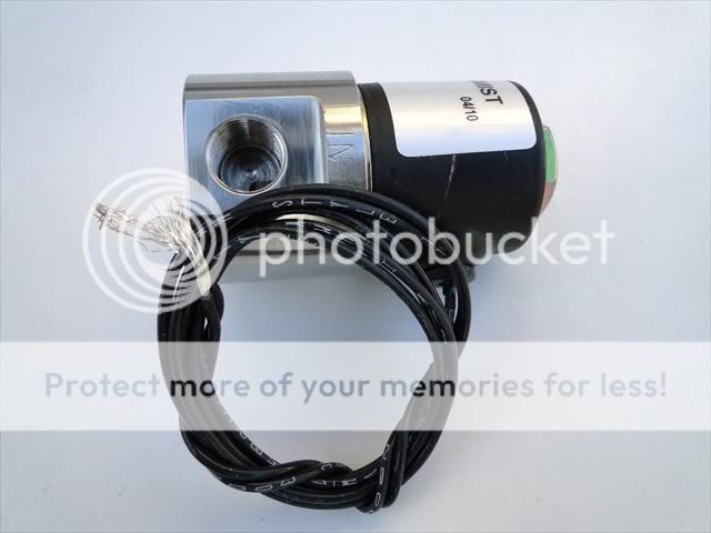

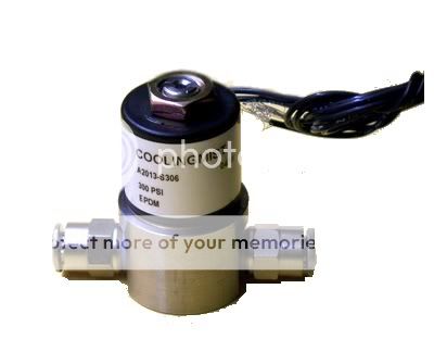

UPDATE MARCH 2012

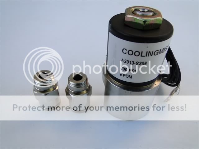

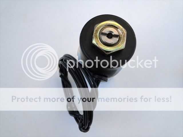

The meth flow was not always consistent and hot and cold weather also influenced the meth flow and sometimes there would no zero flow. I then installed the Coolingmist stainless steel boost solenoid many months ago to prevent the drop in meth flow. Here are some facts abouth the solenoid:
* 300 psi valve vs competitors 150 psi valve
* 303 stainless steel
* includes quick fittings for nylon hose
* draws only 600 ma
* no pressure drop
The solenoid valve is rated at 300 psi and has EPDM seals for the all fluid compatibility. I have not had a single meth flow problem since installing this valve. The location of the valve is also very important. If your meth tank is under the bonnet than it is best to install the solenoid just before the meth injector. If your meth tank is in the boot than i suggest installing it between the integrated filter and the flowsensor. The closer to the pump the better. Also make sure that you set your minimum duty cycle on the pump higher than a value of 35. I set mine on the CMGS gauge to 45.
[Image: DSC04815.jpg]
[Image: DSC04838.jpg]
[Image: DSC04839.jpg]
[Image: sssolenoidlarge.jpg]

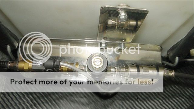

In this pic below you can see the solenoid installed on the back of the meth tank between the flowsensor and the filter.
[Image: DSC07338.jpg]

And how did you guys mount the gauge, was any cutting of the ash tray required?

I removed the inside of the ashtray...nothing was cut or broken to remove the ashtray on the inside or outside.
I also made my own holders for the two gauges, which fit into the existing ashtray space...no cutting was necessary.
If i sell the car one day i will just reinstall the stock ashtray or buy a new one.
