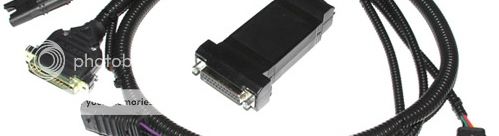

[Image: JB3_data_cable_icon.jpg]

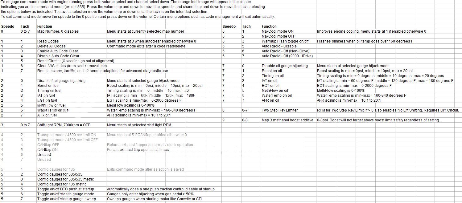

1. This diagramme explains the various maps of the JB4 for the N54 motor as well as all the features that can be accessed using the steering wheel controls:

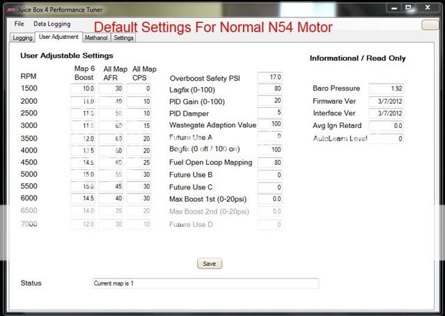

2. This diagramme will be a familiar interface for JB4 users. You can access your JB4 using a laptop with the special USB cable and use the various settings within the interface to communicate with the JB4.
[Image: default_n54.jpg]
[Image: 335is_Settings-1.jpg]

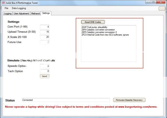

3. Within the interface (below) you can read/delete codes. With the JB4 you do NOT need an additional scan tool for trouble shooting codes. But some users prefer to use the following scan tool - See my review here: [Bavarian Technic BMW & Mini Diagnostic OBD Tool]
[Image: jb4_code_reading.jpg]
The settings diagramme above has been updated recently to include:
* Added drop down under settings for engine type. To be used for engine specific variables and settings. Default is N54. Other options include N55 and N54-1M/335is. Select the appropriate setting in the drop down for proper interface operation.
* Automatic setting updates during firmware updates. This can be blocked by checking off "Do Not Reset Settings When Uploading Firmware".

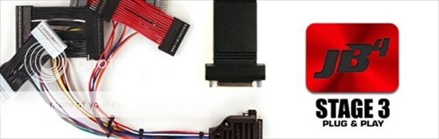

[Image: JB3_N55_BMW_Tuner.jpg]
[Image: DSC07221.jpg] [Image: DSC07218.jpg]
1. The diagramme below explains the various maps of the JB4 for the N55 motor as well as all the features that can be accessed using the steering wheel controls:
[Image: N55jb4_wheel_controls.jpg]

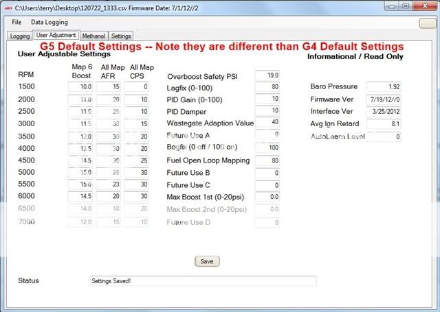

The G5 does not use the same firmware as the G4 board. Be very careful when uploading firmware and ensure you upload the correct firmware for the G5. Also ensure you upload and (save) the correct G5 settings as in the picture below. On the settings page "check" the box that says: "Do not reset settings when updating firmware". This will ensure that you dont have to fill in your global default settings such as AFR's & CPS when you update firmware.
[Image: g5_default-1.jpg]
