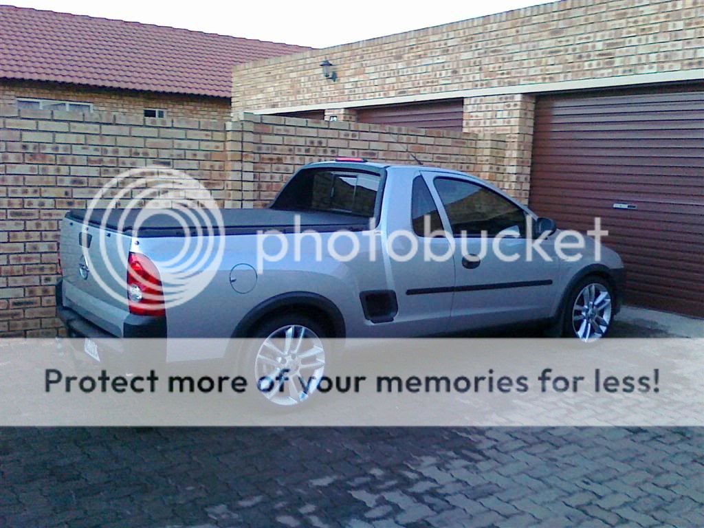

Eventually after about a month of searching, I came across this one:
2007 1.4 Base, it had a tow bar, nudge bar and a mild sound system in it. The bodywork is neat, although it was apparent that it was used by some sort of self-employed individual. I decided to take it, and this would be the start of it all.

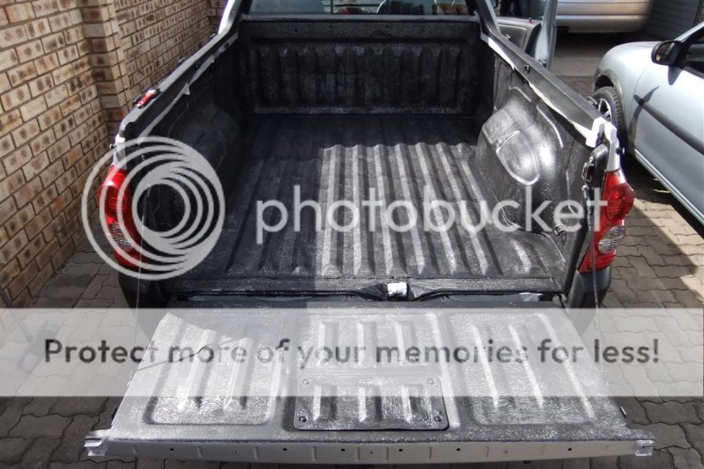

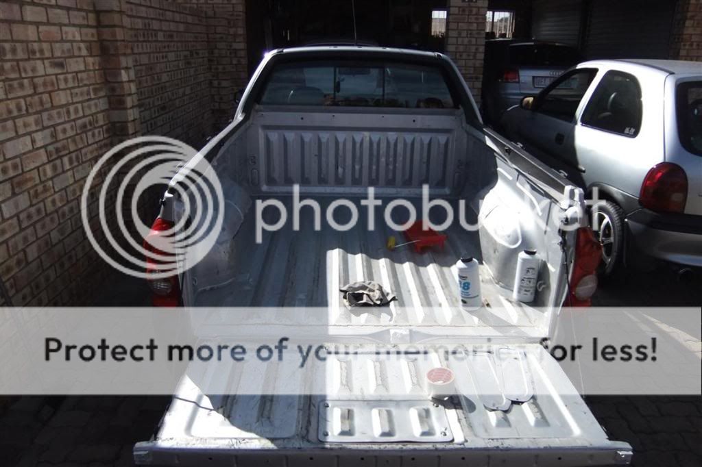

Next, I decided to renew the looks of the load bin. It had a couple of scratches and dents, but with some TLC, I managed to push out some of the major dents, and then coated it with some polyurethane paint. Looks much better. I don’t have a pic of when it was finished, but here are some pics of before, and after the 1st coat of paint:

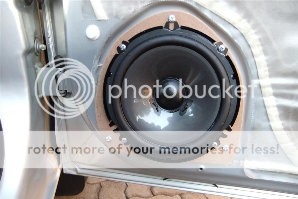

Following that, I sorted out the interior with a couple of goodies – I fitted some grab handles (also known as OMG handles), and ashtrays front and rear to store coins in for all the stupid toll gates I need to go through.

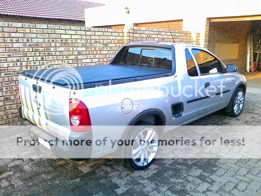

A window tint was next on the cards. I felt quite exposed in the Ute prior to the tint. There are also multiple benefits: improved safety and security, it keeps the cab cooler and also looks better.

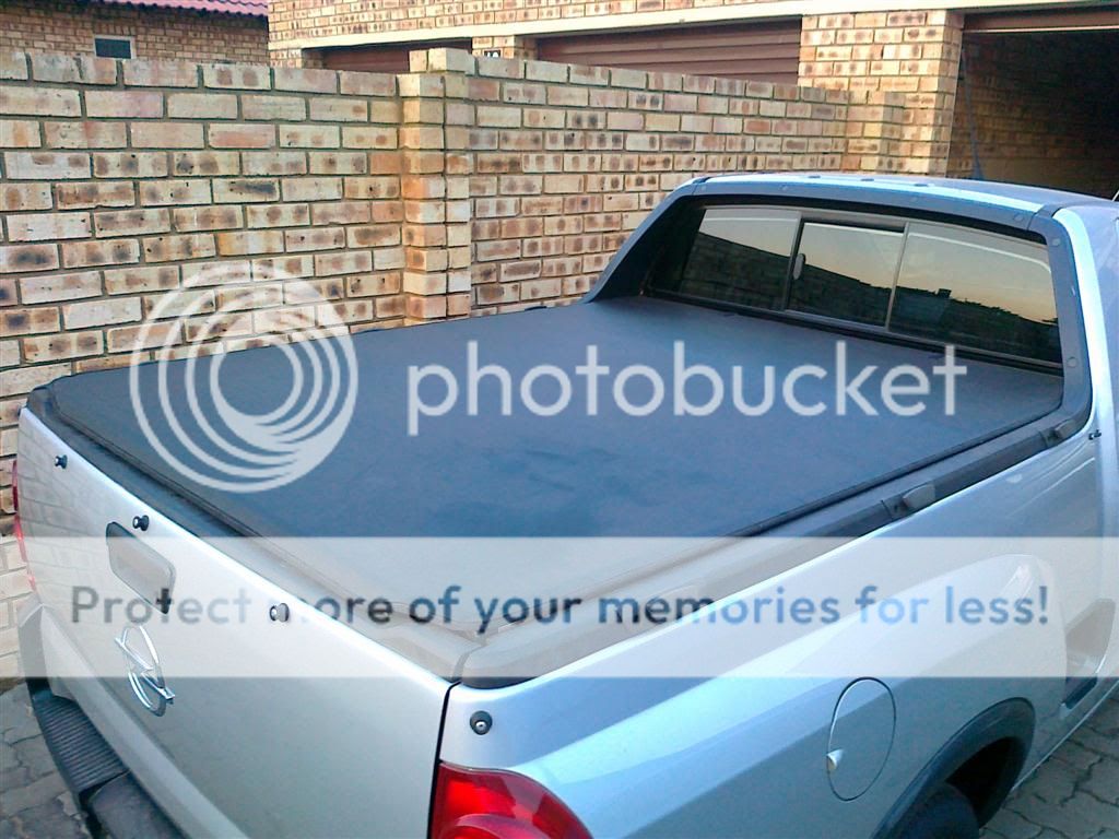

Then one morning I was searching on junkmail and came across a clip-type tonneau cover for sale. The cover was still in very good condition and also at a decent price. It’s one I had in mind, so decided to take it, as it fits better than the one I got with the Ute initially.
Through all the time I’ve had the Ute, I’ve been keeping my eyes peeled for a particular set of rims for it. I had been nagging a lot of places trying to source a set, but because of the scarcity of these rims, it was near on impossible. Then one day out of the blue, I was at a scrapyard and casually enquired about the rims. As luck would have it, they owner had a set available, which he had recently refurbished and was going to use on his Ute, but he had put other rims on in the meantime. So I managed to score a set of Corsa Sport 17in rims:
The centre caps I sourced elsewhere as the original place had lost them. I refurbished these myself, to get rid of all the scratches they had.
I also managed to source a roof-mounted stop light at the same place I bought the centre caps from.

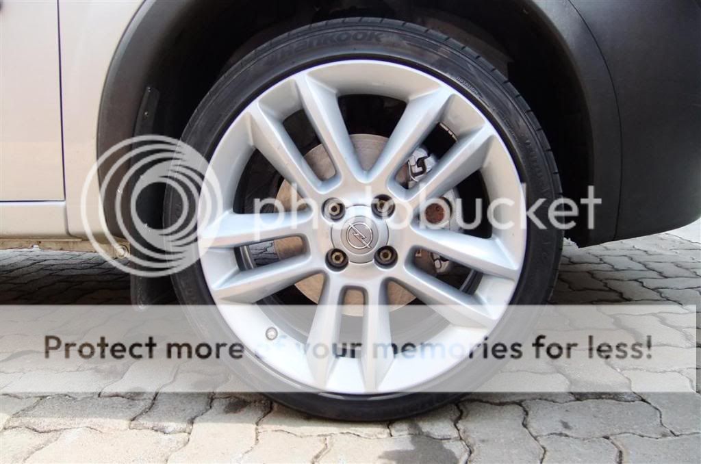

And most recently, I fitted a set of Hankook Ventus V12 Evo tyres to the rims, and had them fitted.

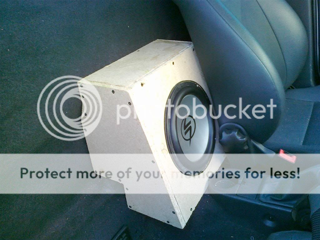

Moving back to the topic of sound, last week I made a new box for my Ute. It sits in between the seats, and is smaller than the original one I had. The box is built to spec for the 10in Lightning Audio sub.

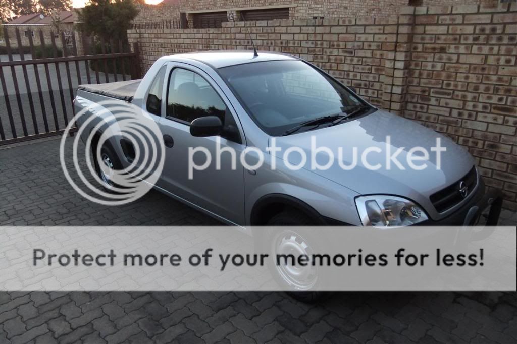

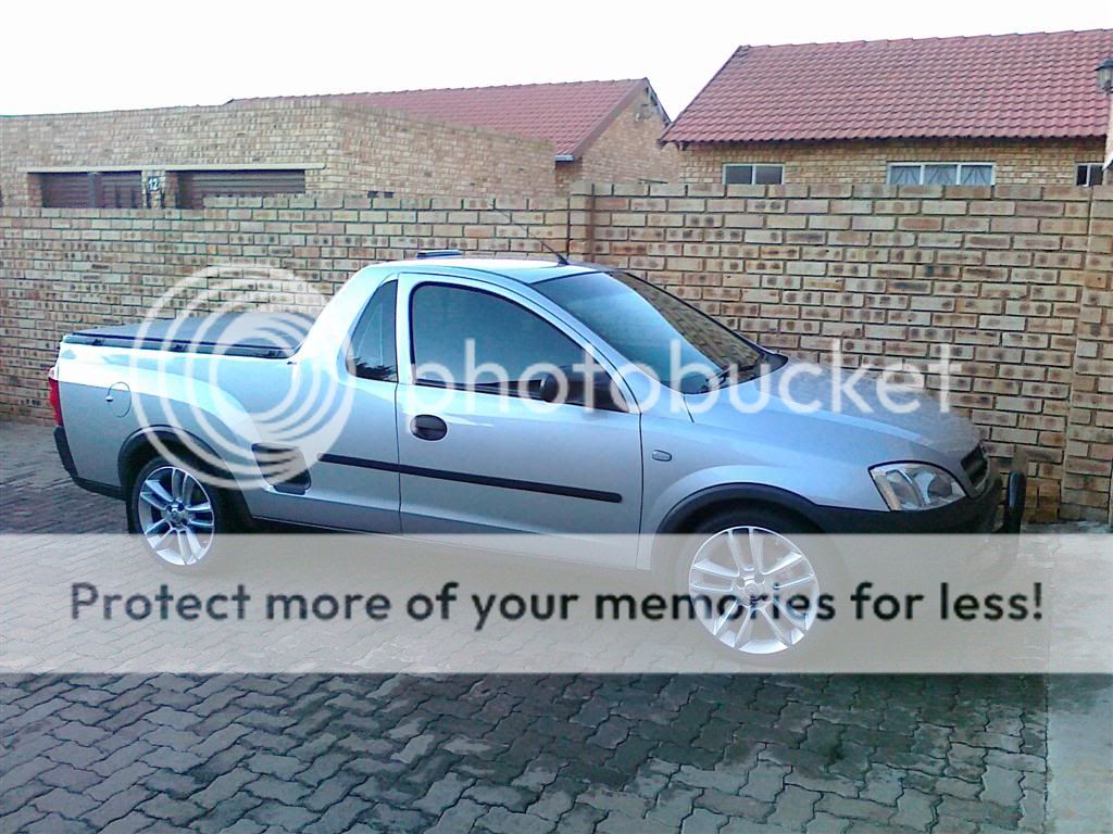

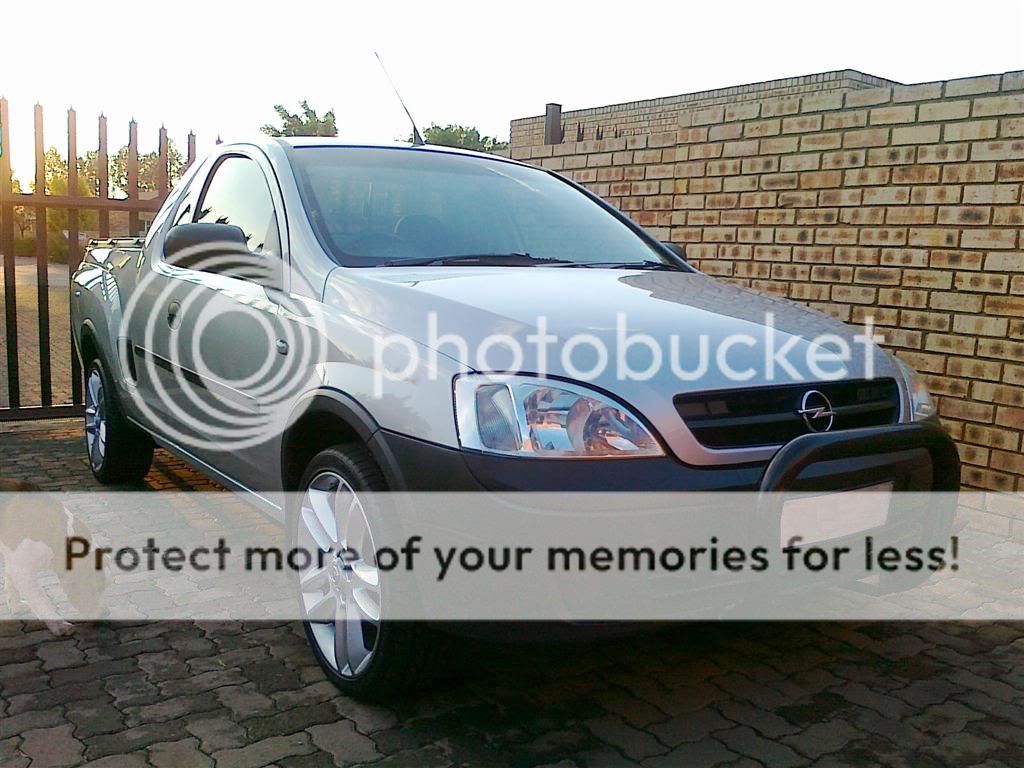

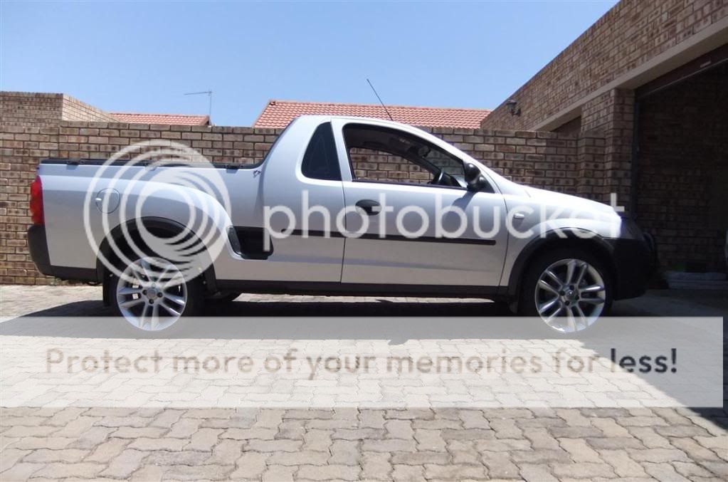

So... this is how my Ute looks after all of the above. I’ll drive it like this for a while, and possibly early next year sometime I’ll consider sorting out the suspension...

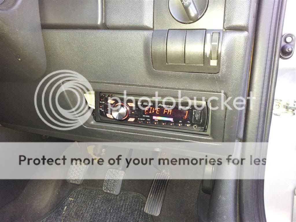

A quick update, below is a pic of my completed sub box.
Initially, I had one of those clip connector things to connect the wires, but I found that there was some blow-by through the small holes in the clip itself. So I replaced that, I now just have the piece of wire coming through a small hole in the box, and I'm using push terminals to connect the wires.
[Yes, I know the above sounds dirty, but I have no other way to explain it, lol]

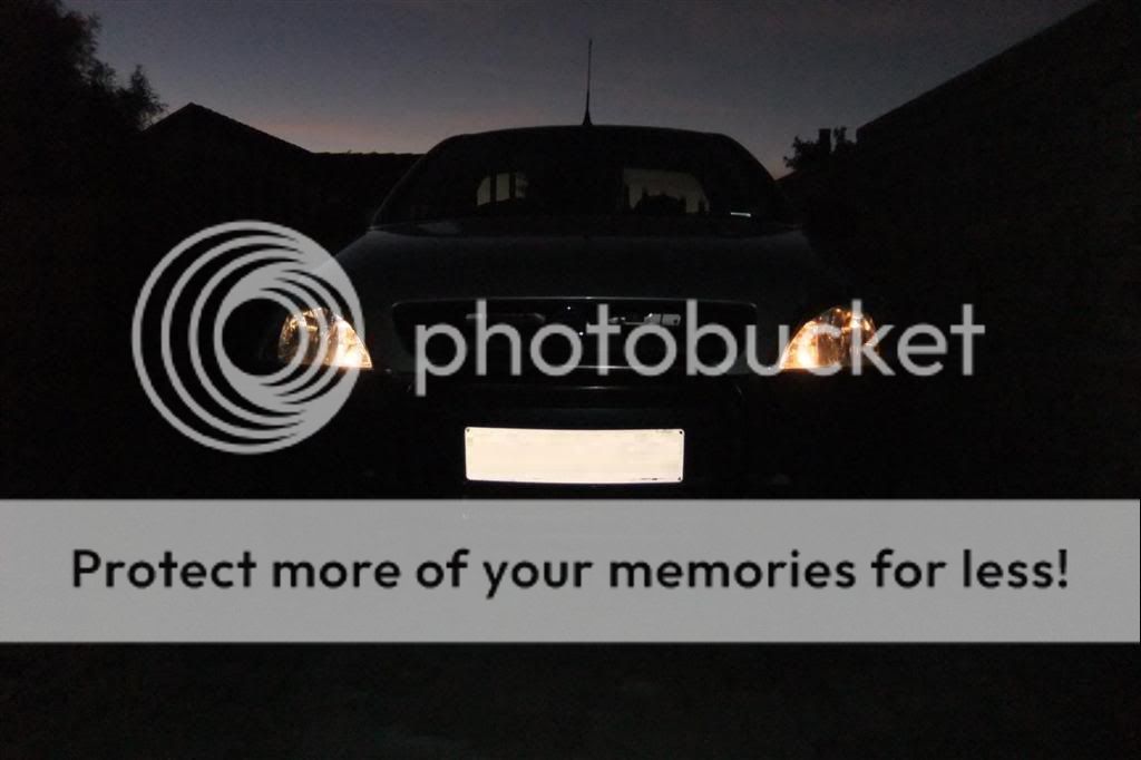

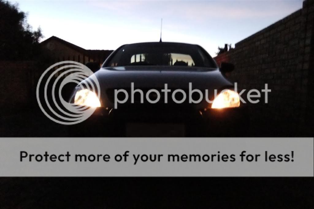

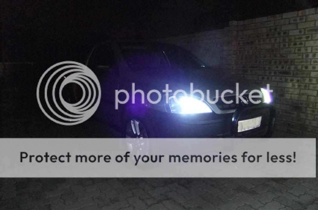

Below are pics where I've fitted the new park light bulb to the driver's side light. The first pic shows both park lights, and then the second pic is with the main beams on (these are the Osram Nightbreakers I purchased a while back)
Then, for the sake of keeping the posts together, I went past Autostyle earlier this week, and did an impulse purchase of a HID kit. I justified my spending as an early Christmas present to myself :woo:
Being made in China, there were no instructions that came with the kit, but it appeared to be fairly easy to decipher what needed to happen. I just did some double-checking on the tutorials on the UK forum, and then fitted them yesterday. It wasn't too much of a shlep, just it's a bit tight to work behind the lights, and you have to be careful not to touch the glass of the bulbs with your hands.
Here's a pic of them in operation. Definitely much brighter, and it seems well worth the effort. All I need to do is try adjust the driver's light up a bit, cos it seems to be shining a bit low.

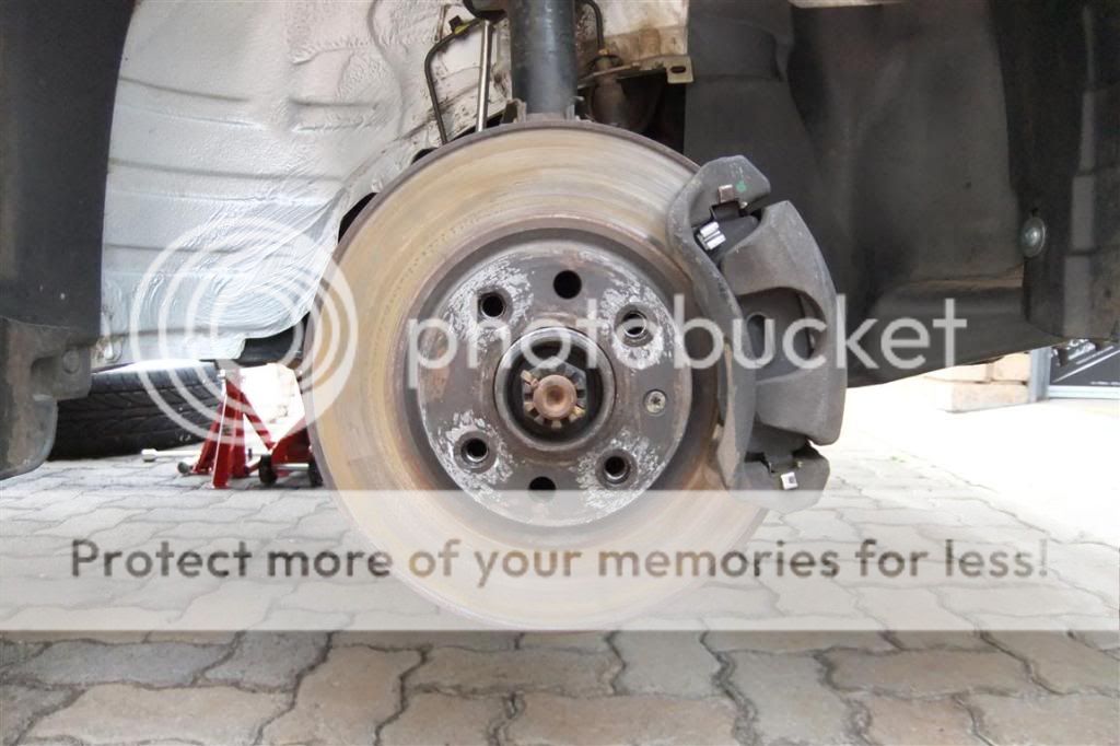

So, the history behind this upgrade, the Corsa C Ute comes standard with 260mm discs. Now from my trusty sources (and some posts on UK forums) I discovered that it is possible to perform a 280mm upgrade, using OEM parts which will be a direct bolt-on, no other modifications required.
What is required for this upgrade are Meriva Caliper Carriers, and then the Calipers off the Meriva, or Astra G. I managed to source a set of calipers and carriers from a Meriva at SUMP in Springs. The things were filthy when I got them, but after plenty of hours of cleaning, and killing my hands in petrol, they looked like this:
After cleaning them up, I have them a fresh coat of silver paint, to make them look like new again.
For discs and pads, I purchased these from Norbrake in Anderbolt, Boksburg.
The calipers are much bigger than the standard ones, as well as the piston within the caliper. The pads are also much bigger, so more stopping surface should = better braking performance. (More about the science later on...)

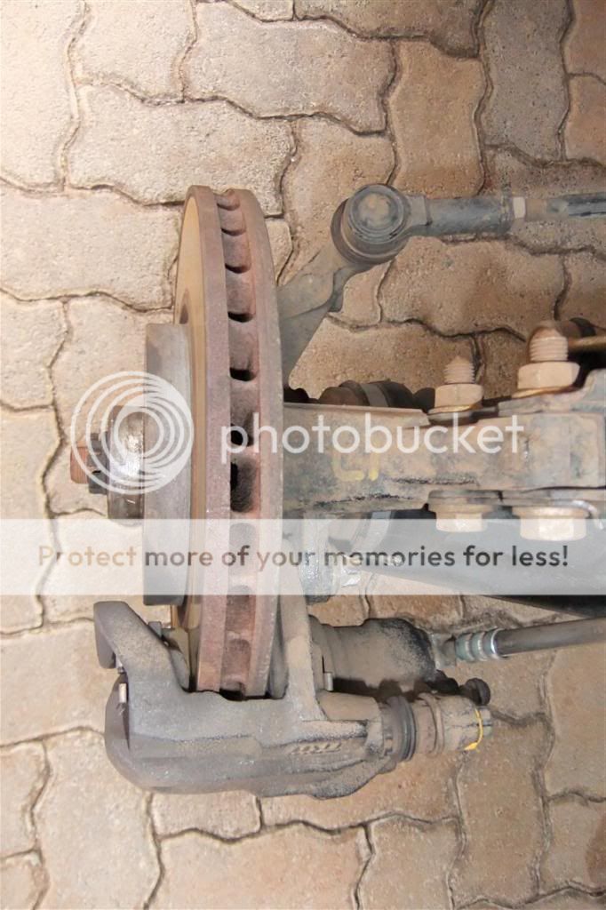

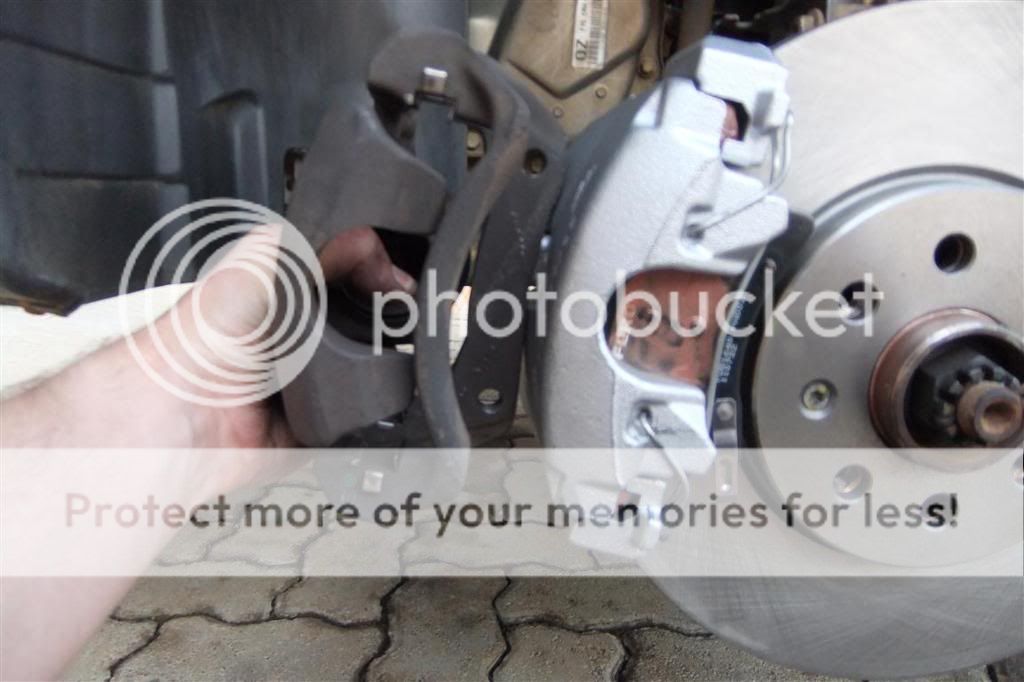

Here are some pics of the standard disc and caliper:

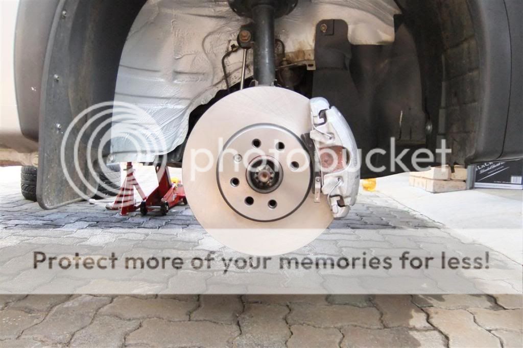

And here are some pics of the new brakes fitted:

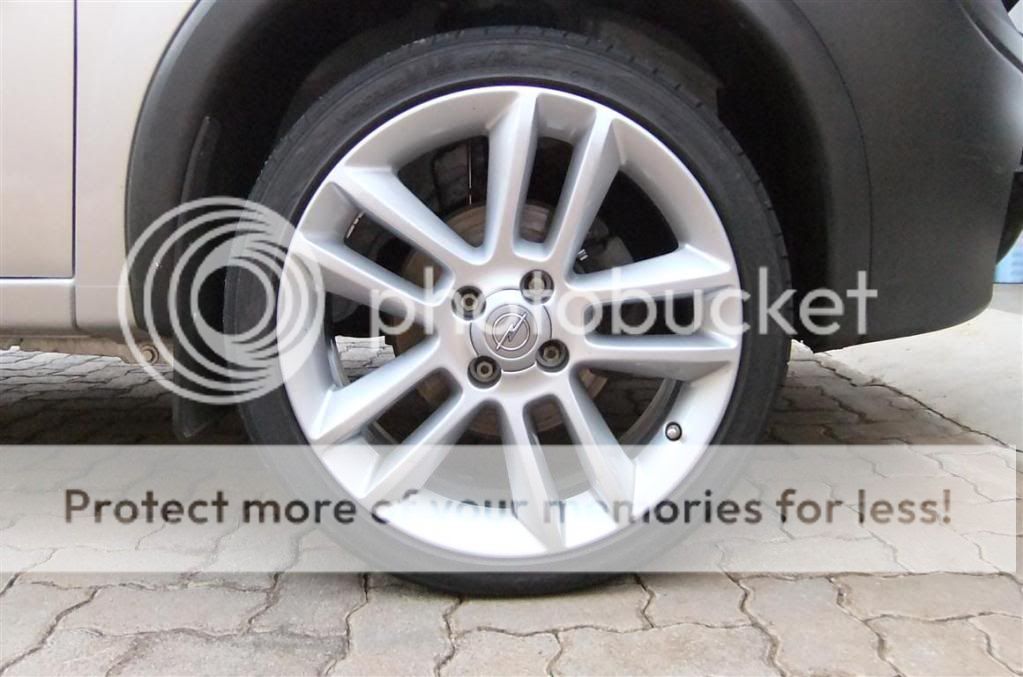

Here you can see there is about 5mm clearance between my wheel and the new calipers:
And here is the completed product behind my rims:

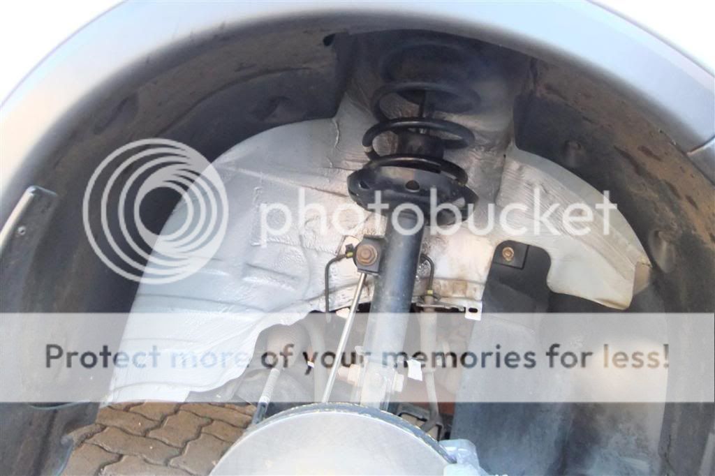

Having completed the brake upgrade, I decided to try something which I've been meaning to do for a long time. Because my Ute has the black bumpers, I wanted to paint the sills of the Ute in black as well, so as to tie in witht the black wheel arches and black bumpers.
Here is a pic of how it looked before:
And here is a pic of after I painted the sills:

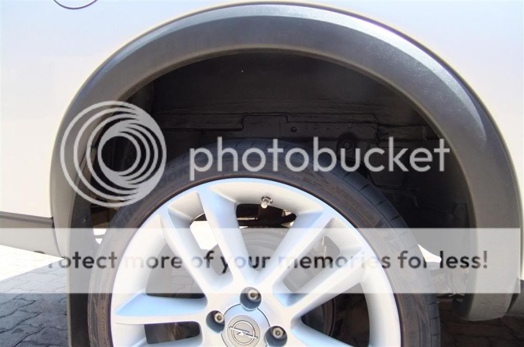

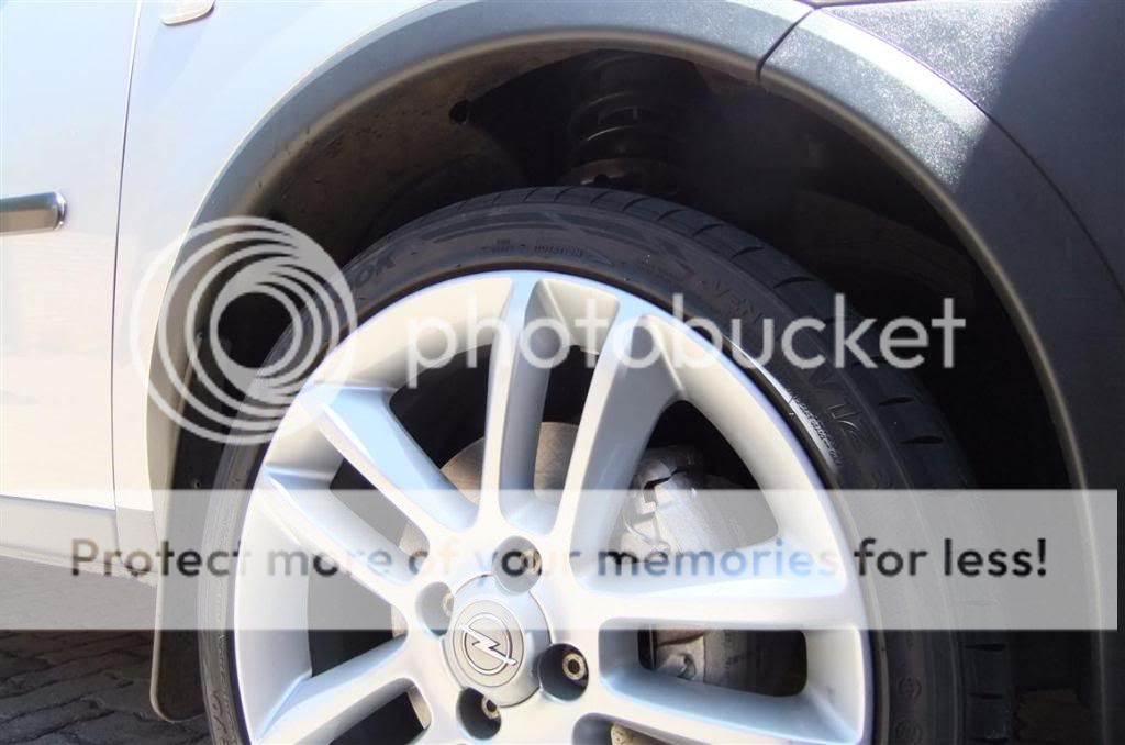

Then, having completed that, I wasn't happy with the insides of the wheel arches. There is the black plastic arches, and then the silver of the bodywork was showing. So I took the wheels off and painted the silver parts of the body which were showing - in black as well.
Here is a pic of the front wheel arch before I painted:
And here are pics of the arches after I had painted them:
Overall, I'm happy with the results. I think the black sills tie in nicely with the bumpers and wheel arches, and the black wheel arches look much better, almost as if there is less distraction when looking at the wheels.
Here is a pic with everything completed:

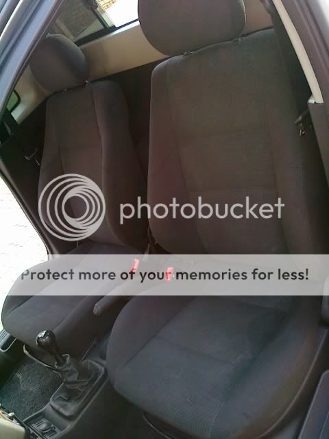

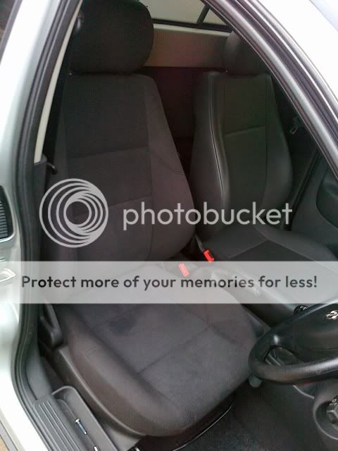

Then I managed to source myself a seat of cloth seats (I think they must've come out one of the Sport models - not sure). Here is a pic of the driver's seat fitted, along with my standard vinyl seat:
Then here is a pic of both of them fitted:
Don't mind the dark patches on the seats, those are just wet spots from where I had them cleaned.

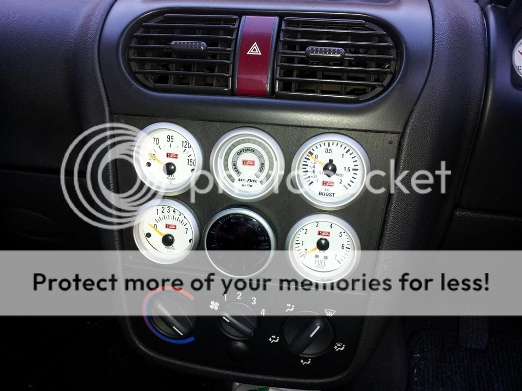

Then over the weekend, I got a set of stuffed clocks, from one of the sportier models in the range, and I transferred the dial matts and needles across to my instrument cluster:
Before:
After:

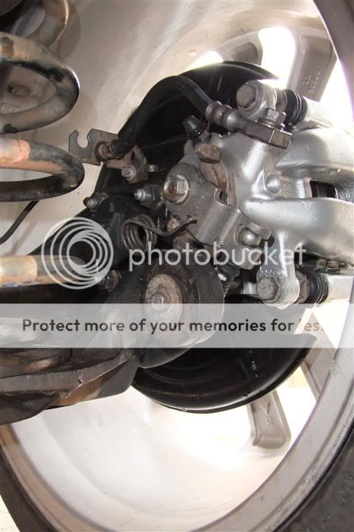

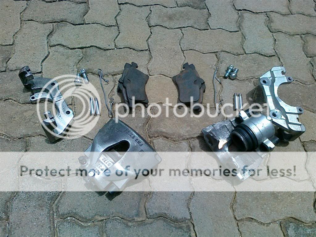

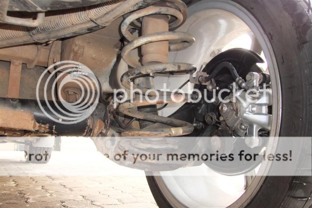

264mm rear disc brake conversion - complete.
So over the weekend I went to visit my friends at Lopec, and bought a complete rear brake setup off a Meriva which they got in the previous day. I bought the stub axles, calipers, carriers, discs, pads and brake lines. I also got a handbrake cable which would work with the new disc setup.
I spent the most of saturday cleaning everything up. I noticed that the discs were in poor nick, and the dust caps on the caliper pistons were buggered. So on Sunday morning, I was rushing all over the show to get discs, and to find the correct caliper seal kit.
Here's a pic of the parts after I had finished cleaning them:
I then sprayed the calipers and carriers silver, and fitted the caliper seal kits. I also sprayed the backing plates in a fresh coat of black paint.
Fitting was pretty straight-forward, a direct bolt on. The only thing which needed some massaging was the new brake lines. I just had to bend them a little to fit better around the springs and shocks.
The real pain in the arse job was fitment of the new handbrake cable. I had to drop the exhaust, and loosen the heat shield to get in there. (It also didn't help that it was getting dark, so the pressure was on to finish before total darkness set in).
In terms of issues, I had to bleed the brakes quite a bit cos there was a stubborn airlock which just wouldn't go away. The handbrake was also not working, but I managed to sort this out by slacking off everything, and then retensioning it.
Here are some pics of the completed job:
Pictures don't do it justice, but it looks much better. :woo: Time will tell if the braking performance is up to scratch, I just need to drive decently for a bit to bed in the pads and discs properly.
And last but not least - thanks to Pas-chill for all the help and advice. rocks

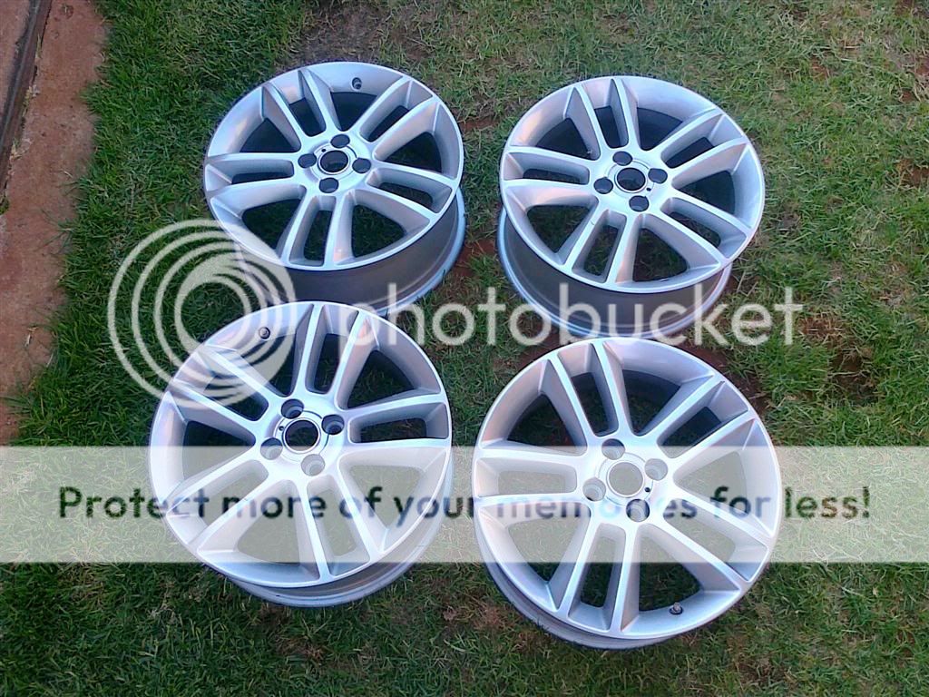

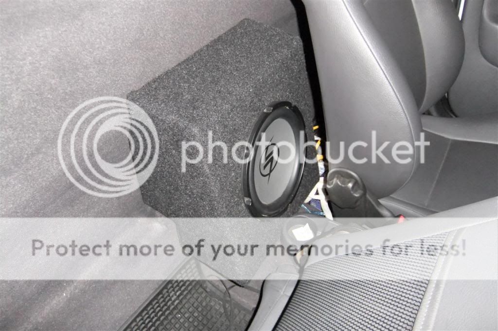

That’s all for now, as other bits and pieces get done, I’ll update this thread.

Ute:
- Inner: 39mm
- Outer: 48mm
Meriva
- Inner: 43mm (10% bigger)
- Outer: 56mm (17% bigger)
So, the piston of the caliper is much bigger than standard, so as well as being required to push on the bigger pads this should equate to more stopping power.
Brake pad area:
Ute:
- 43.23cm^2
Meriva
- 50.76cm^2 (17% more pad area)
The brake pads have a much bigger surface area than the standard pads, so again, stopping power should be better, and because there is more pad area doing the same amount of work, there should be less chance of brake fade from higher speeds.
Disc Diameters:
What I wanted to do here, was measure the inside and outside diameters of the disc, so that I could calculate how much surface area there is on each disc which can be utilised by the brake pads. Going from 260mm to 280mm does not sound like much, but the extra 20mm difference is actually gain in surface area on the disc which can be used to stop (as the centre part of the disc is effectively the same).
Inner:
- Corsa: 164mm
- Kadett: 164mm
- Ute: 166mm
- Meriva: 162mm
Outer:
- Corsa: 234mm
- Kadett: 256mm
- Ute: 260mm
- Meriva: 280mm
So, from the list above, I calculated the area of a circle using the outer disc diameter, and then the area of a circle using the inner disc diameter. I then subtracted the value of the inner circle from that of the outer circle. This effectively then gives me the disc surface area which can be utilised by the pads. (For information purposes I included the results of the calculations for the Corsa and Kadett discs as well):
Disc surface areas (in mm^2):
- Corsa: 21881mm^2
- Kadett: 30347mm^2
- Ute: 31450mm^2
- Meriva: 40962mm^2 (30% more disc area compared to the Ute)
So in conclusion, the components weigh a bit more than the standard stuff, but there are benefits to be had in every area (piston size, brake pad size, disc size etc.
I'm still running in the discs and pads, so can't confirm whether or not my eyeballs will be sucked out when doing hard braking, but initial impressions seem good.
I'm happy with the progress, and I'll update again once I have more news :woo:
Thanks for listening / reading

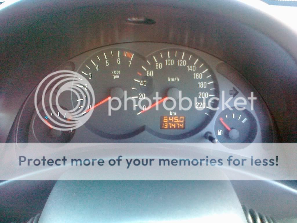

Before:
After:
