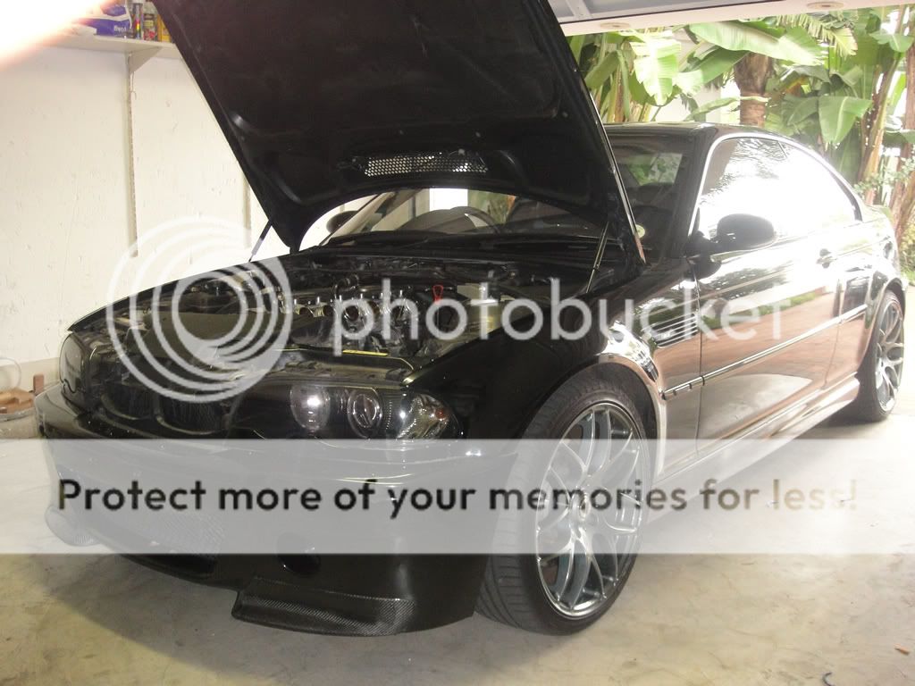

We were keen to retrofit a CSL airbox to the e46 m3 well coz it sounds freakin awesome. Looks pretty bolt on and plug and play right?
Let me begin with our 3 day journey which involved giggles, frustration, strippers, pizza, lots of silicone and 3 which then grew to 5 (coz it was just sooo much fun) team of regular okes hunting for the csl growl
going into this badboy

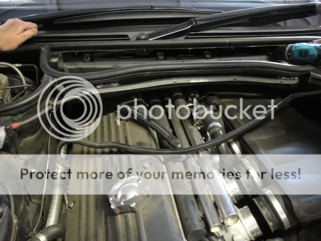

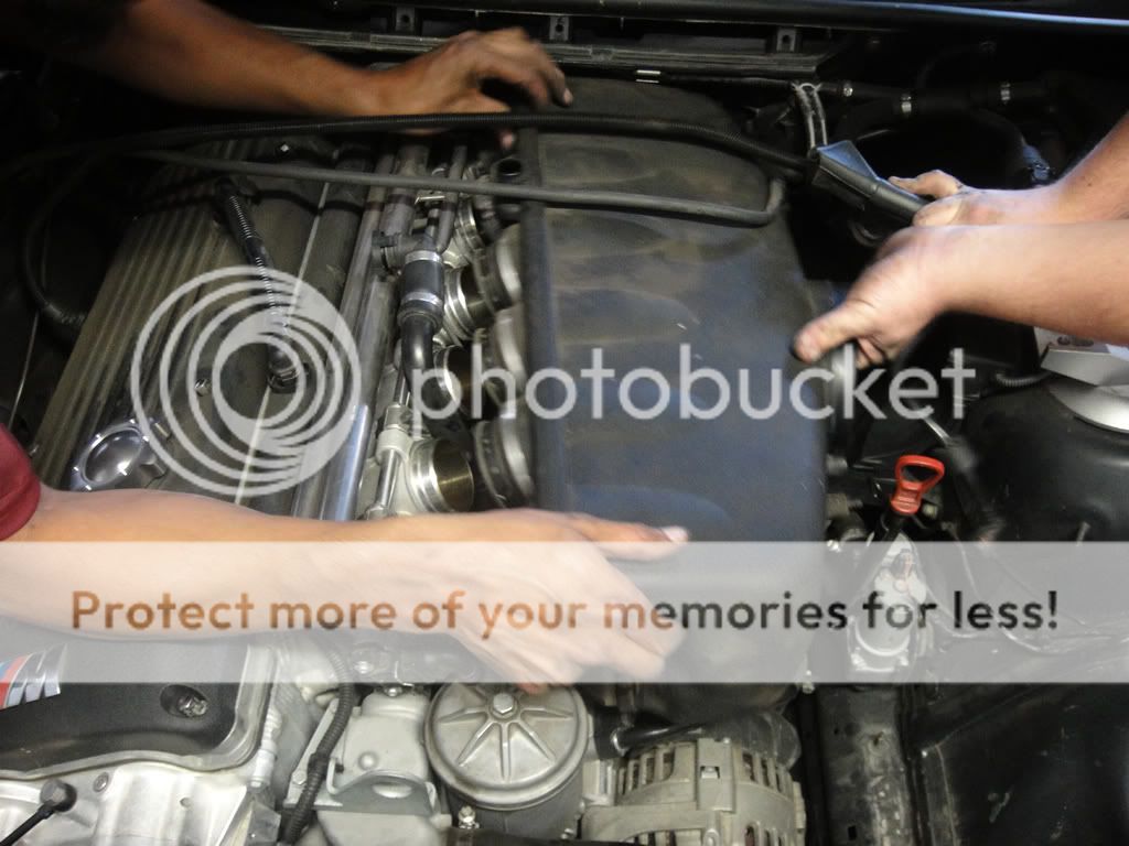

Getting the stock airbox off. Simple right? lets find out...
We had to remove the AC schnitzer anti-roll bar, airbox, plenum, maf sensor as its not needed - CSL airbox runs on alpha-n software to manage airflow.
no not really lol

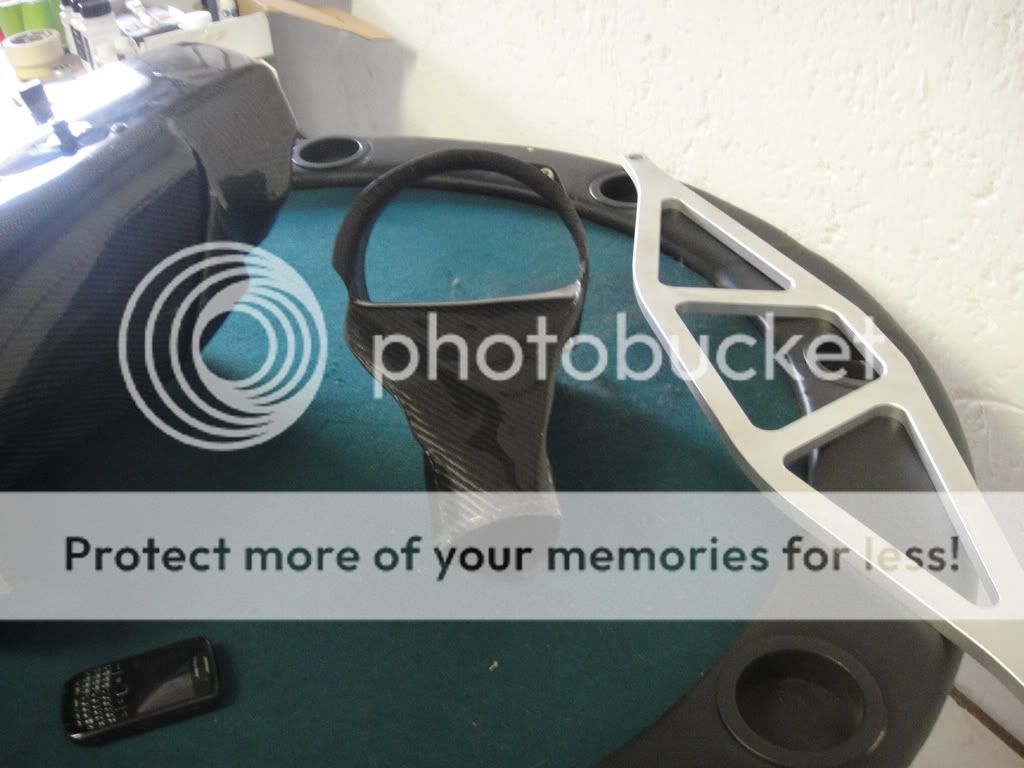

Aha! Lets remove the microfilter section :thinking:

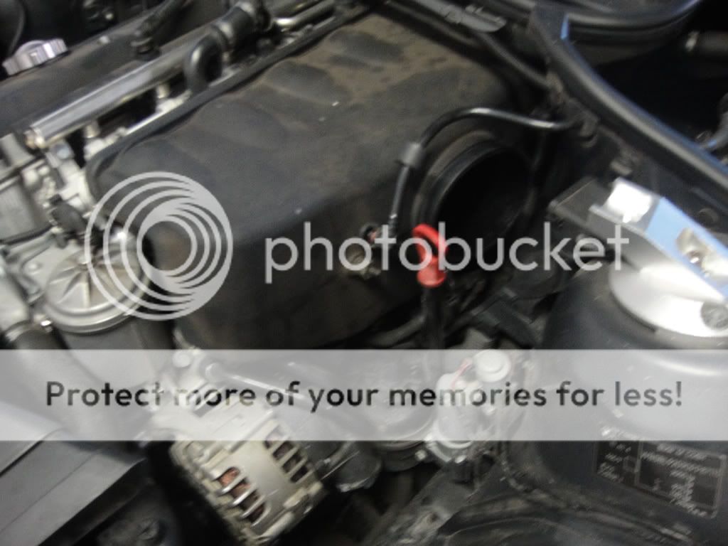

Hey where's the dipstick gonna go :thinking: Ok we'll get back to that later...

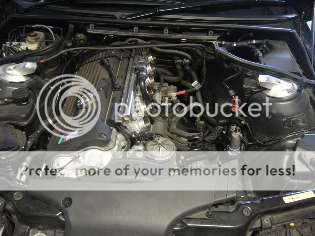

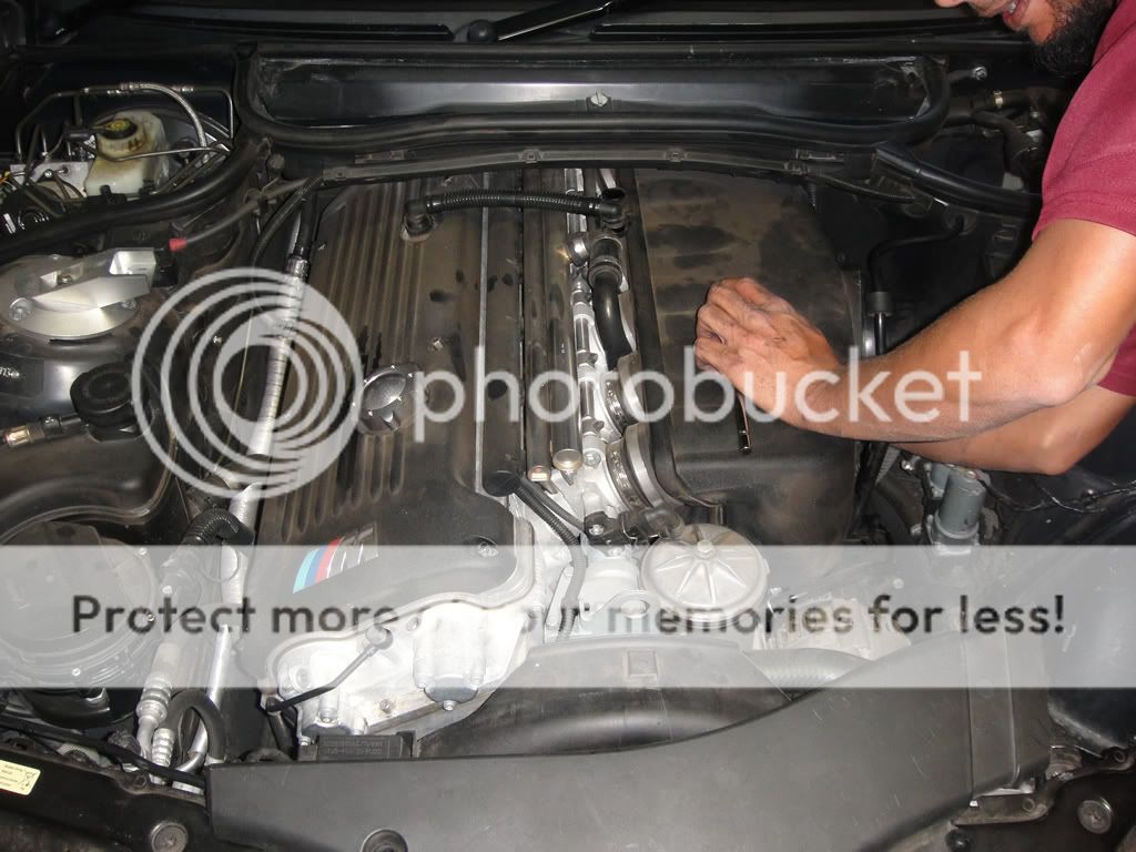

Lets get those clamps from the throttles off
Awesome stock plenum is coming off :clap: so far so good. That only took us 2hrs :mmm:

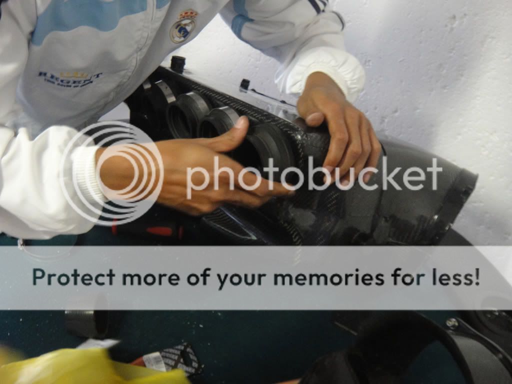

Getting the clamps on

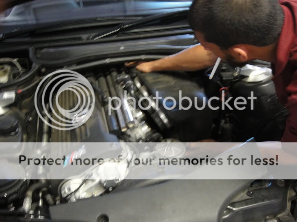

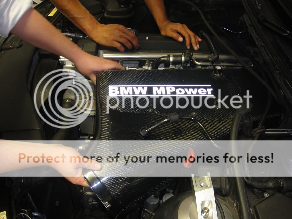

Ready to go in? Lets find out..
We managed to bend the oil dipstick out of the way :thumbsup:
Then we discovered that the stock breather and pcv pipes werent going to work as one was short and other couldnt bend to position so we needed to modify the pipes. Ran over to builders warehouse to do some shopping.
