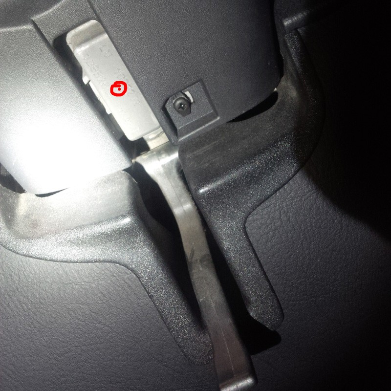

Turn the key to "Radio position" about 60° from off.
[Image: 03022011664.jpg]

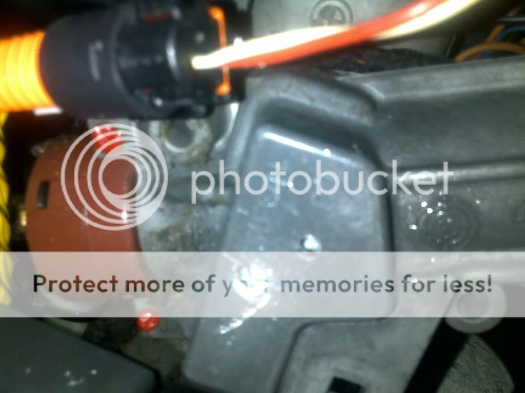

3/8" drill bit or slightly smaller will work, but not too small. Drill a hole on the raised section as shown below. (I had a practice run with a smaller hole to the right but couldn't get a good grip on the spring) Drill more to the left. The longer section is where the spring resides. You will go through 1 layer, try not to go through the second.
[Image: 03022011668.jpg]

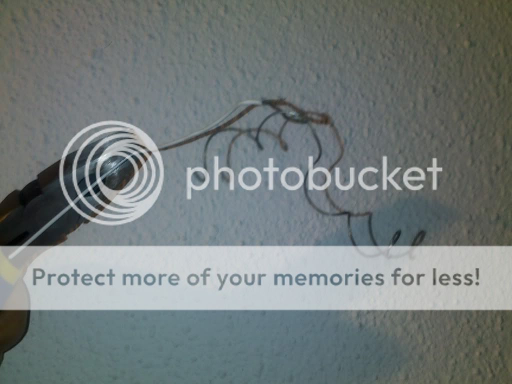

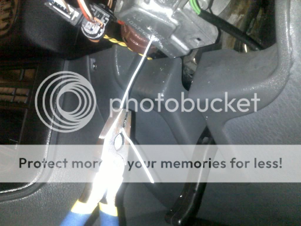

Insert the top of the paper clip, bend it slightly and wiggle it around till it catches the spring. Then grab the paper clip with pliers and pull firmly...
[Image: 03022011669.jpg]
And TA-DAAA!!!
[Image: 03022011670.jpg]
No more locked steering. Thumbsup2
And TA-DAAA!!!

Once the spring is out that's it, job done. Did mine last year according to this DIY and no steering lock on my race car, last thing I'd want is for it to get stuck mid-corner on the track...
